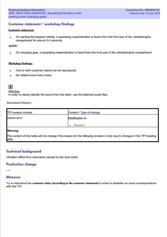

Tester01
Oct 24, 2022
130
18

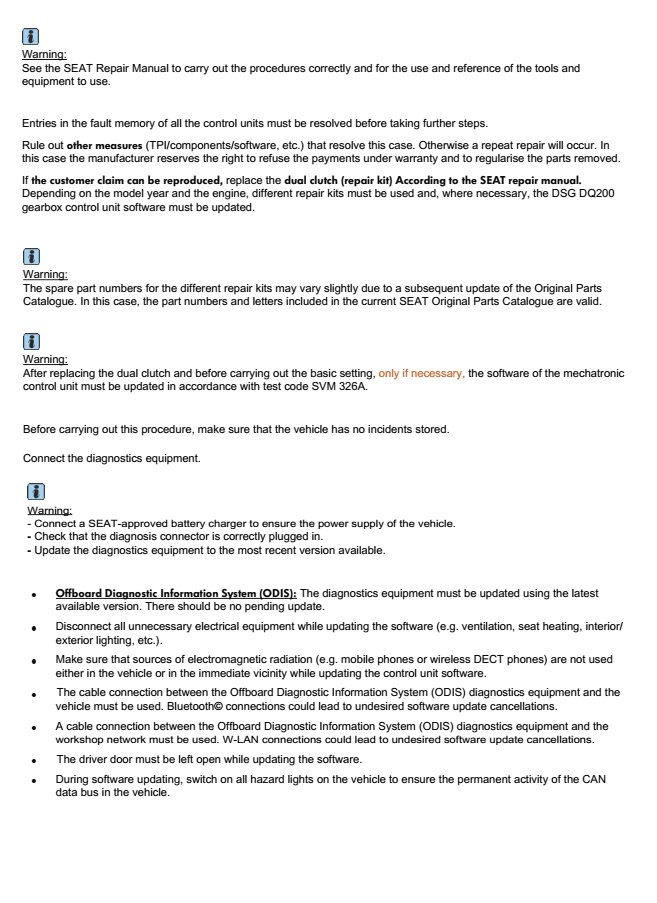

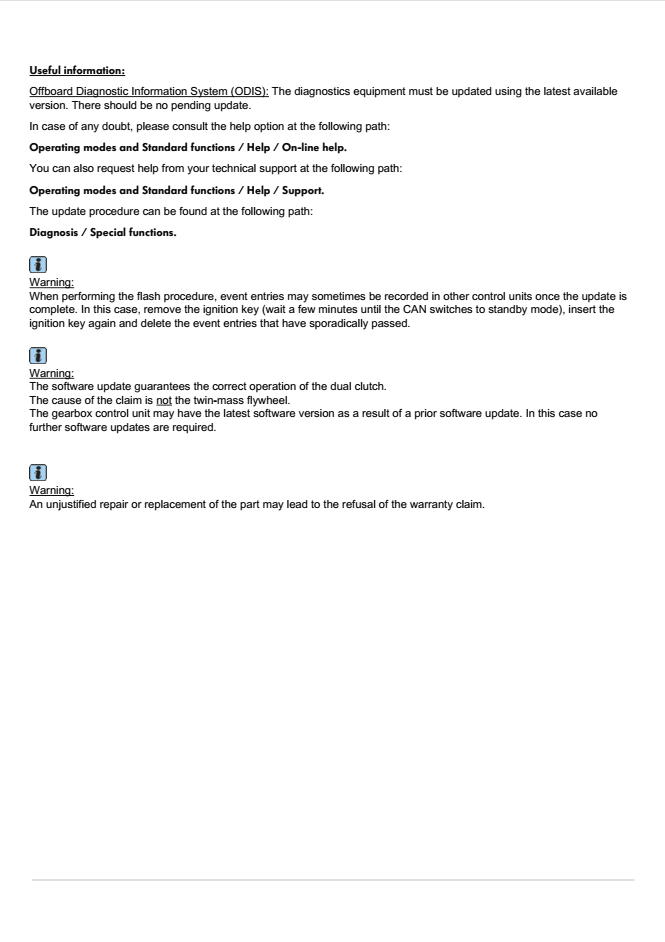

Now I dont know if this is the exact TPI my car was repaired under as I didnt get any invoice or paperwork - Going to try get this next time Im by the dealer, as picked up my car out of hours due running late with traffic etc, which may be why I didnt get anything.
And where I saw the TPI number was when I was booking my car in prior to dropping it off, and I re-access it.
This TPI - 2044315/14 is what I grabbed off Erwin today thats specific to my car model after inputting VIN on Erwin.
I know some of the 1.5s the newer ones I believe, come with a wet clutch DQ381.
You'll have to check which ones yours comes with but I dont believe the squeal happens on DQ381.
Might be worth quoting that TPS when you next speak with them.
Or to be sure it or similar TPS/TSB exists for your car playing the £8 to access Erwin for an hour.
At least then you defo know it applies to your car or something exists.
