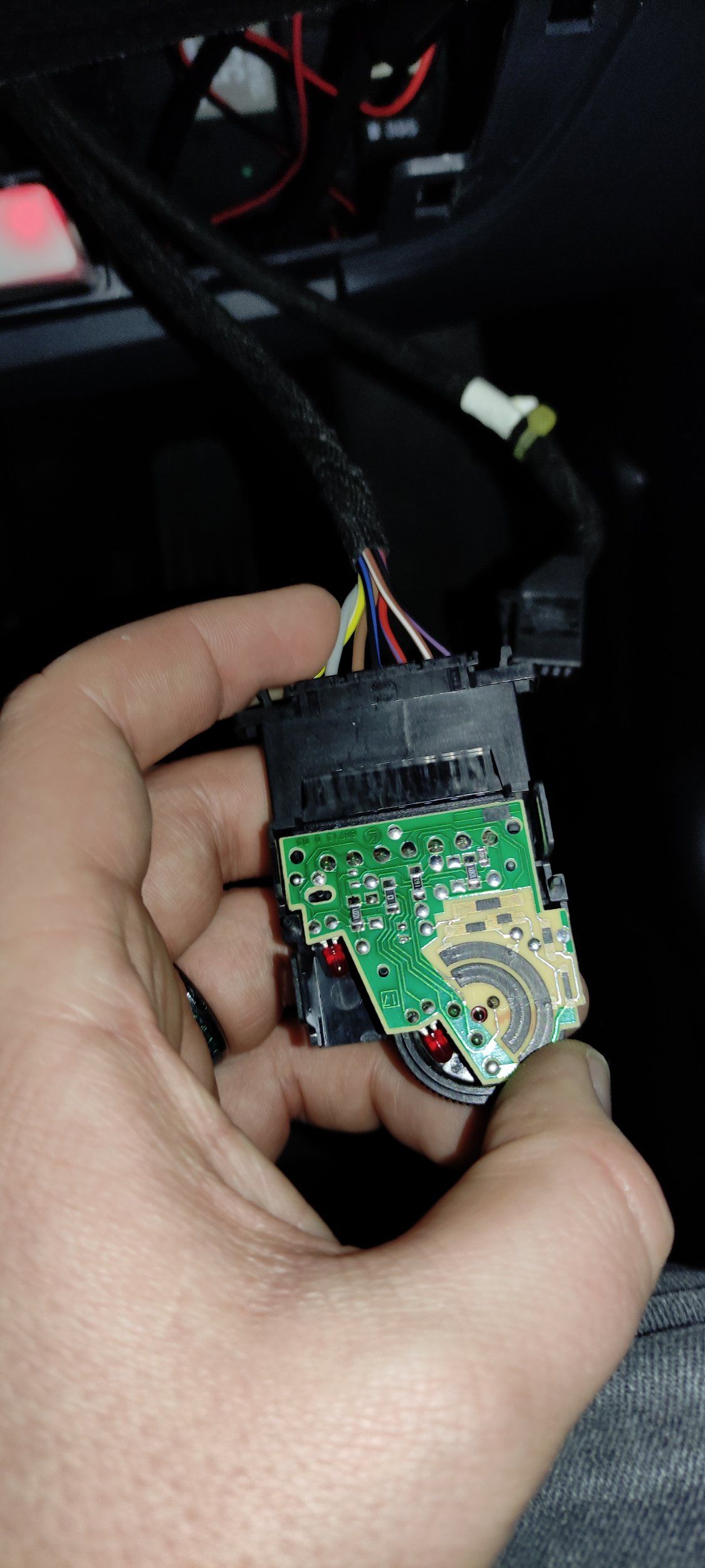

One pointer for anyone that might come across this at a future date, I couldn't pick up the feed on the pins as seen in this guide and has to open up the dimmer switch instead as to get to the soldered joints on the PCB (PCB pictured)
In the above you can see the 7 soldered joins that go to the pins. Be very careful as it would be very easy to cause some damage, proceed at your own risk!
