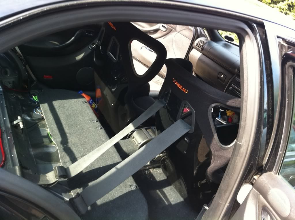

I can pick mine up with one finger so mine weight less yes not sure what ones you have , no I havent put a resistor in yet my mates going to code them out with vag com but yet to do it few pics

600 each altho I didint pay that lol , To be honest there really comfy i have extra cushions under them tho lol , my rear harnesses are attached to the iso fix points in the back the only one I had to drill a hole for was the middle as there is no where to bolt the fixings to as the belt is attached to the old seat ,
Can't find any better pics and at the min I don't have my car ,
