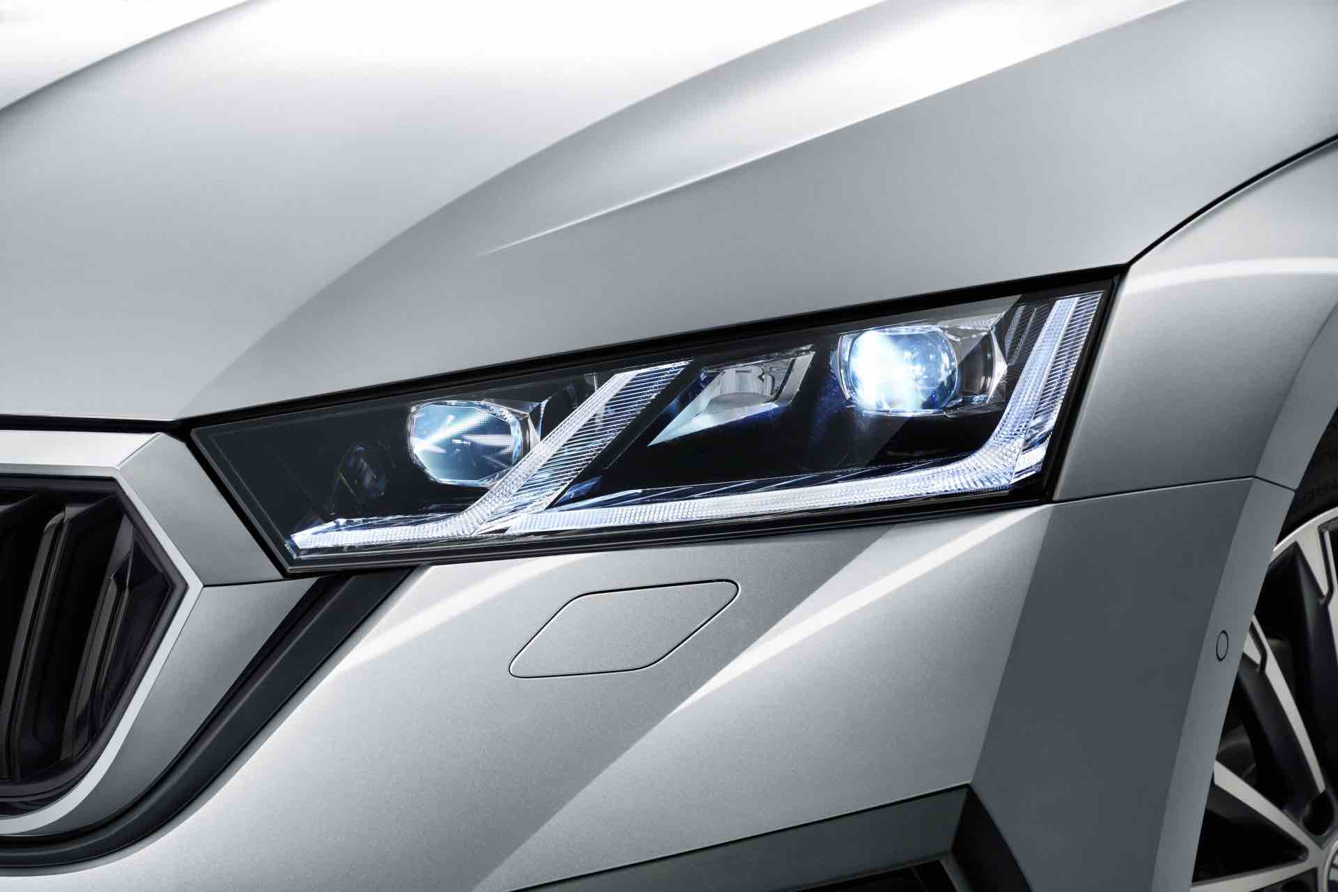

that's also my perception. I think it's the same LEDs used for both beams, and the computer is just changing the height via the leveling system. That's how I see it on the non-Matrix headlights of my Formentor.
However, on Octavia mk4 I had the Matrix (which is way better than the Matrix on the Formentor) and it was really fast; not to mention that you could see separate sections in the headlight for the high and for the low beam.
