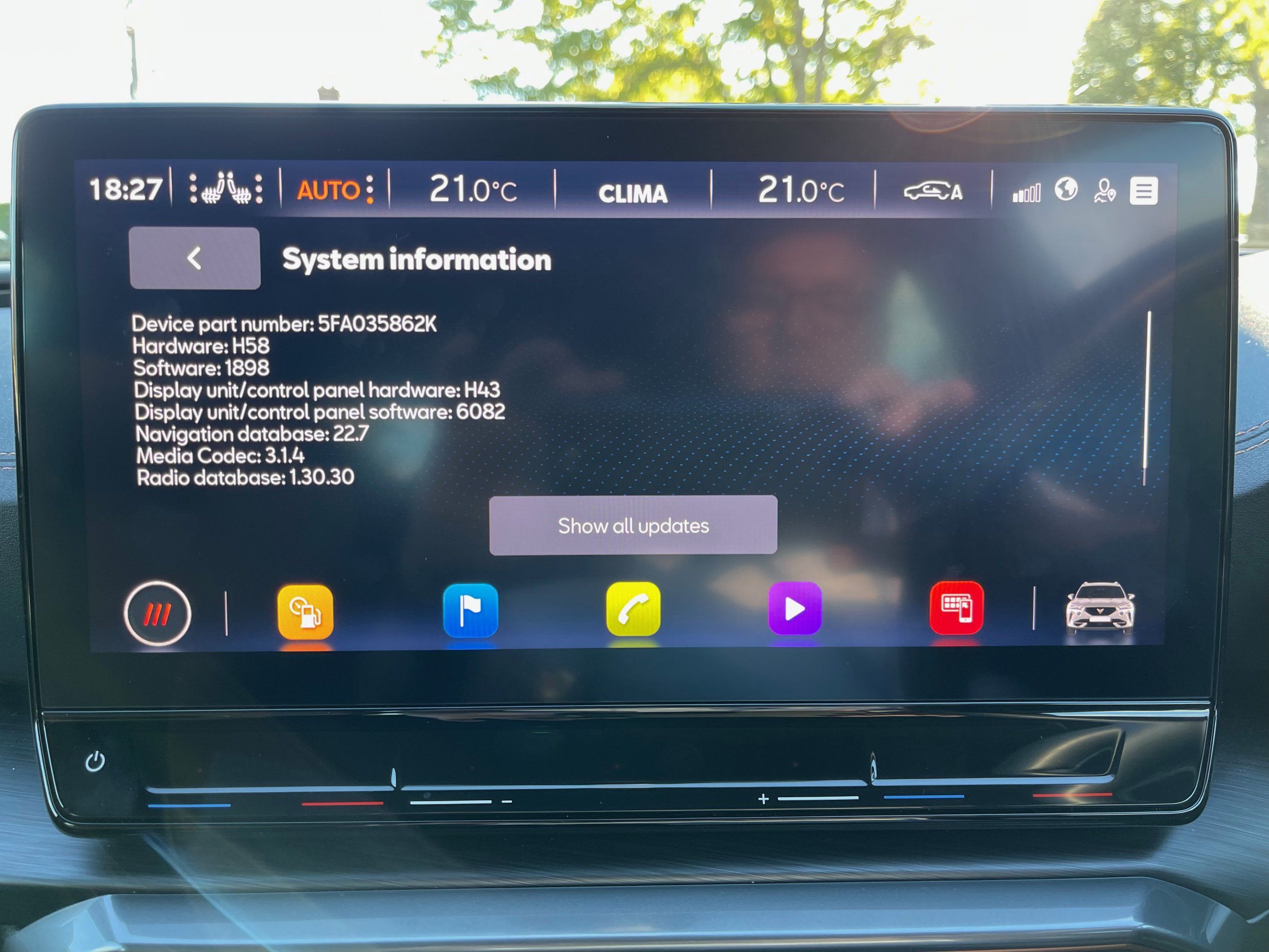

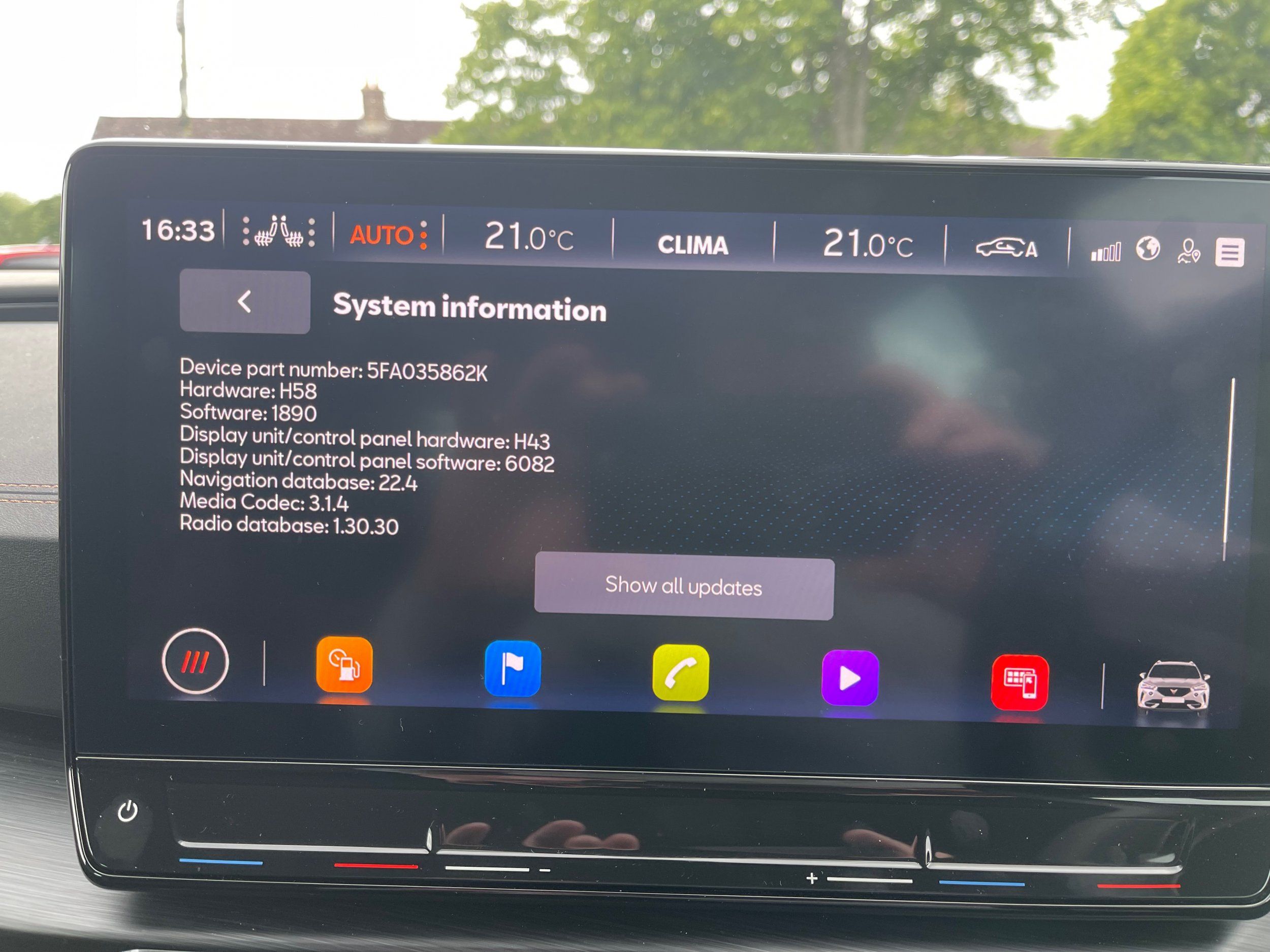

Had mine updated to 1898 by the dealer last Wednesday. Not noticed any significant changes, but it is a little smoother now compared to 1890.
I'm bored with complaining about it now, and the system still feels laggy at times. I had a Formentor as a courtesy car for the day, and the system felt much smoother.
Previous and current numbers attached.
