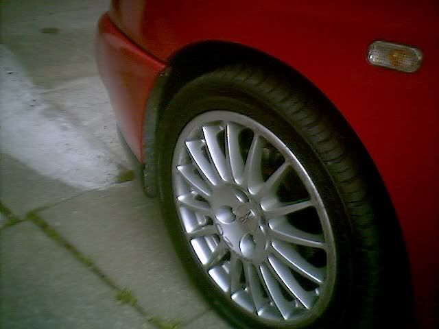

few pics
looked sort of like this
http://i4.photobucket.com/albums/y109/Evilkinevil/ibizaprefaceliftfront.jpg

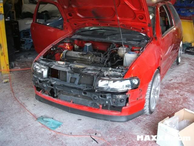

took it to bits looked kinda like this
http://i4.photobucket.com/albums/y109/Evilkinevil/aam.jpg
now looks like this
http://i4.photobucket.com/albums/y109/Evilkinevil/ibiza061.jpg
the bumper fits on the same mounting points but is about 1" bigger at either side, you need to flex it it and tack it to the arch liner with a bit of steel or aluminium like this
