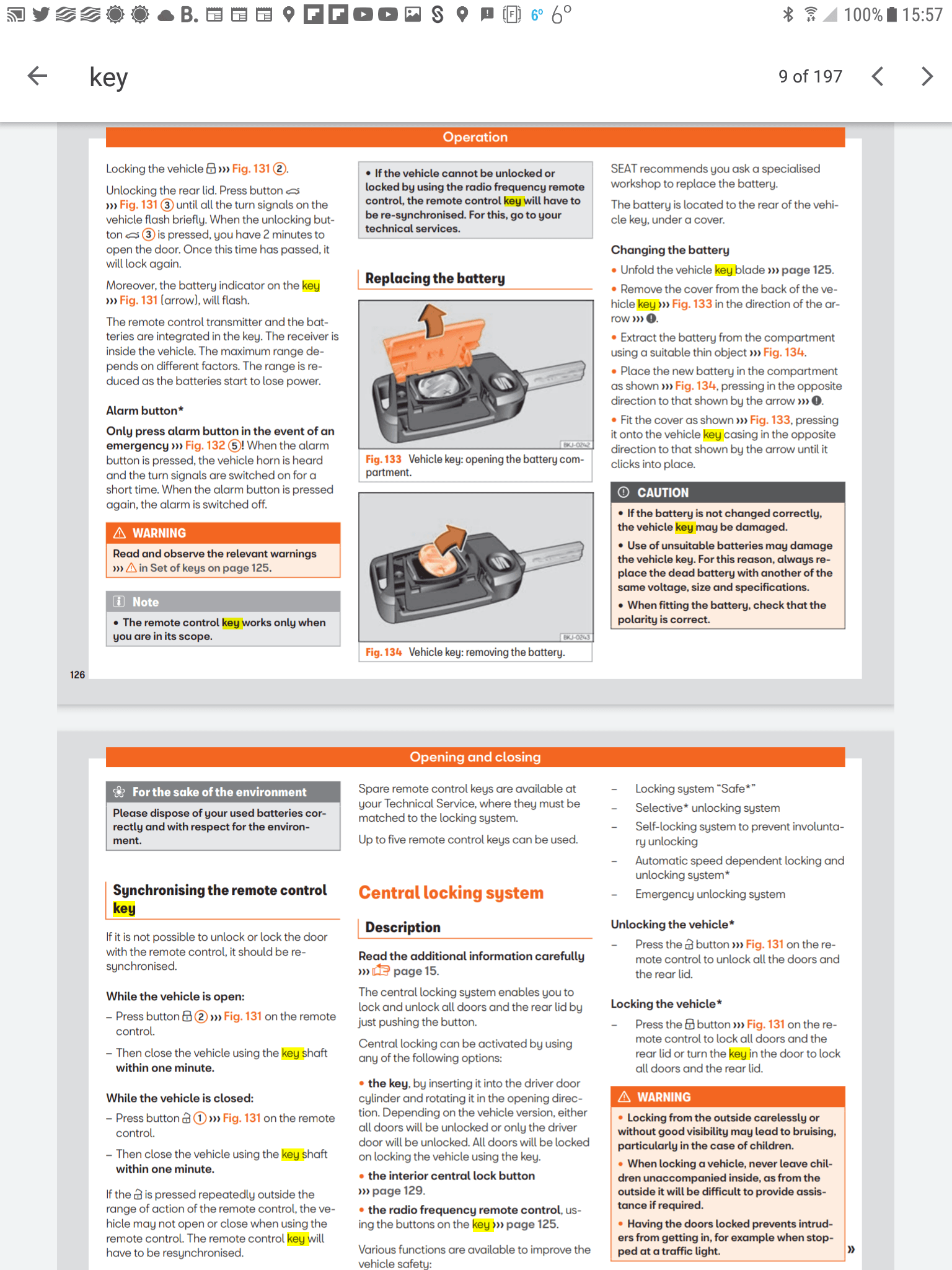

Any Seat dealer should be able to do it if they can lay their hands on a spare. Apart from changing the battery I haven't tried the other procedures in the manual.
If it's a Kessy you have the emergency way of getting in which you might want to read up on just in case. The Ateca has a battery saving mode in the car of closing down the passenger side entry Kessy aeriel... but given the Arona only has Kessy on one side you might not hit that one. Ateca you walk round and hold the drivers handle and all is good.
The manual says you can have five spare keys.

Yep you just need a suitable screwdriver to give the twist to leaver the case open and a bradawl to top the battery out. As the first videos on the link, second he uses his thumbs, pass on that.
If you do the 2032 hack in a 2025 remote you use the bradawl to hold the battery in place just as you clip it down using the case. The old Skoda trick that got Kessy before Seat. Practical Skoda people :unsure:.
