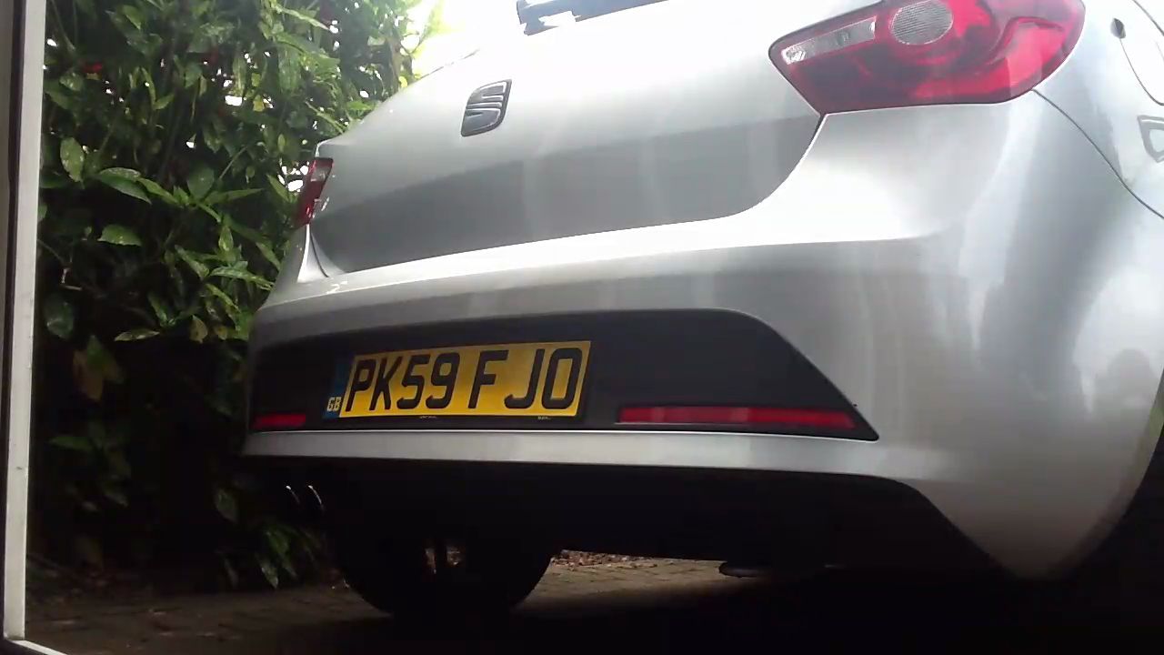

Sry I know I have the wrong car, but I have had it done on my 1.4 and as everyone has said it only effects the noise not the emission so come MOT time you should be fine unless you get a right tight ass doing it. But here's a little clip I did of mine just to give you an example of the out come
Sound a lot better on the road with gear changes on WOT at around 3500-5000rpm were you get dsg farts:D lol
