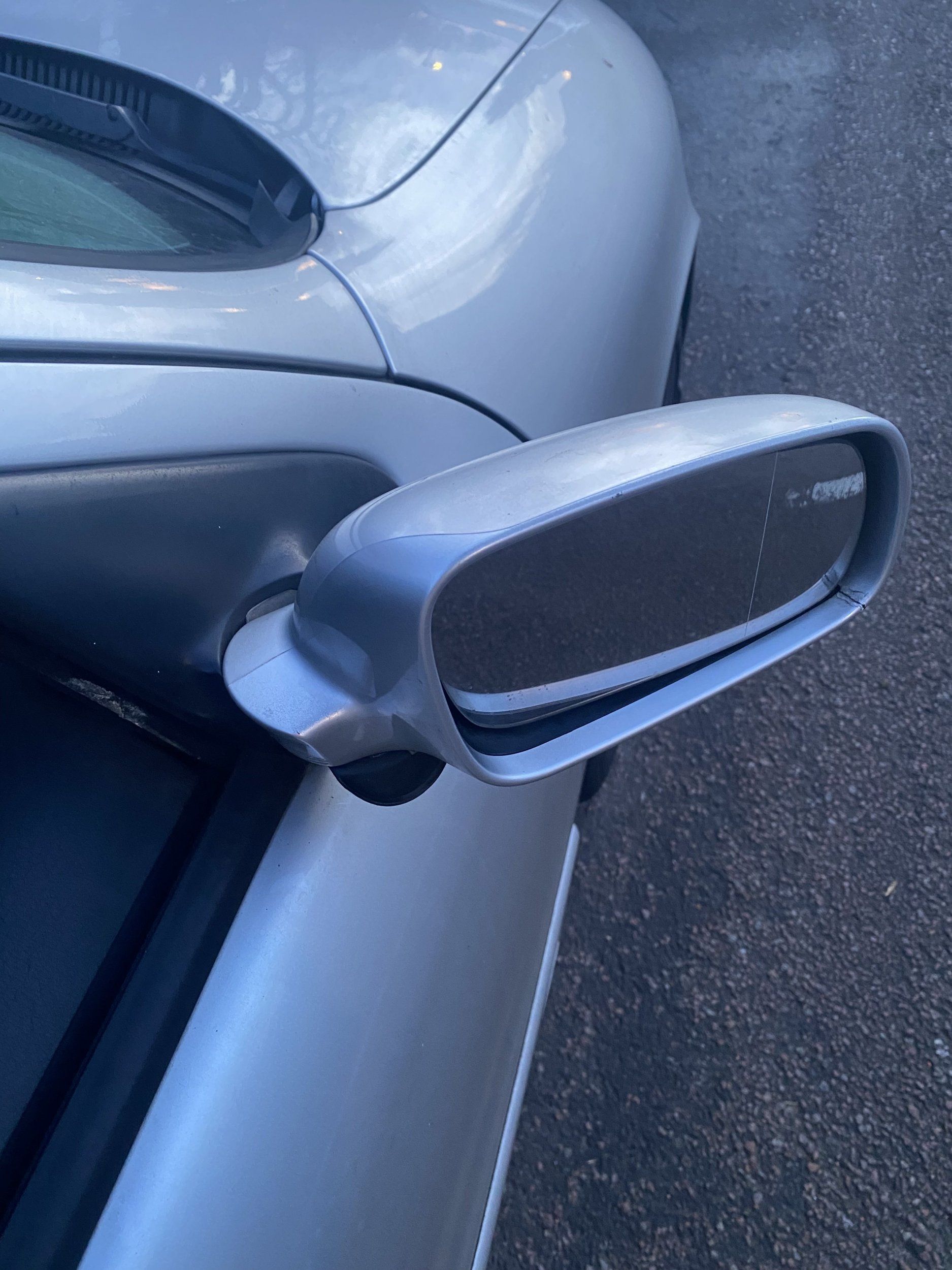

Today, I had tried fitting a aftermarket head unit with no luck, but that did involve me disconnecting the battery. Once everything was back in place, battery and all, I turned the car over and tried to extended my wing mirrors. However, the off side (drivers side) wing mirror was moving wayyyy past its usual open position. I had tried to give it a little nudge back to the correct location, however that didn't work.
I shall attach some images to this thread to help anyone understand the issue more.

You might have to force it back.
Worse case scenario is you have to get a second hand one. They're really easy to swap.

Hi Alexis,
Thanks for the response. I forgot to update this morning, but it has managed to fix itself and is now operating as usual! (Must be my lucky day).
Should the need come I would've replaced it without hesistation.
