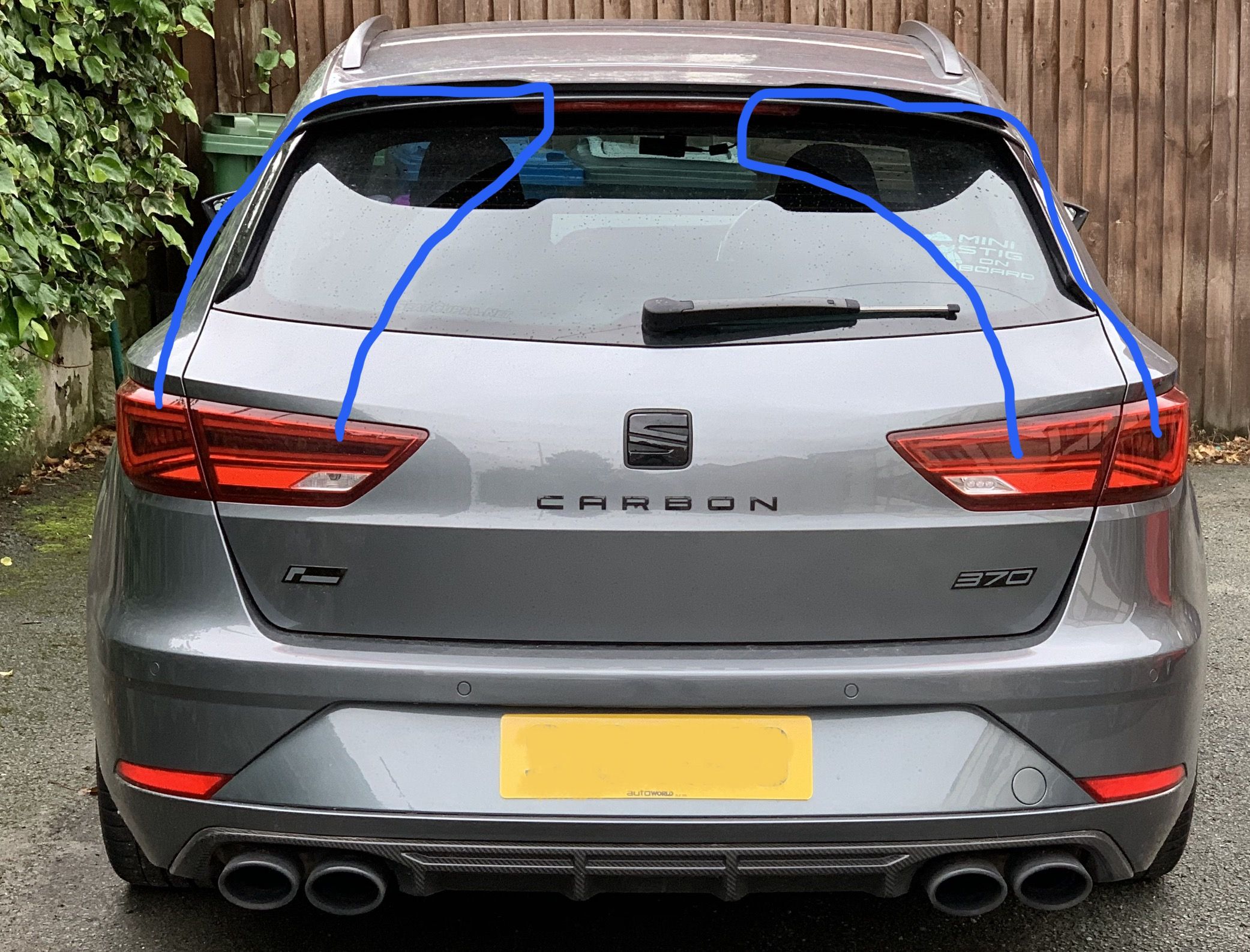

hi i've got the lights and can confirm the indicators only work on outer cluster
you mentioned i would have to do additional wiring so the indicator displays on both units in unison
would you be any chance know what wires i would need to connect? and from where?

Really sorry I don't.
However I suspect you'll be to compare the wires between your lights currently to work our what extra wiring the outer lights have that the inner lights don't. (just bare in mind the inner lights will also have different wires, for fog and reverse light.)

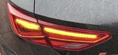

It maybe worth looking online at the 'semi' dynamic indicator looms you can buy. These add a delay to the outer indicator to make i look like its scrolling across. It may help work out what wires you need to connect to. @paddy6789 has them.

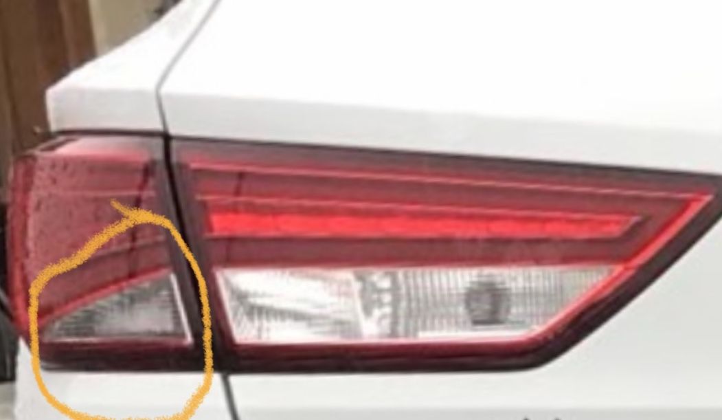

Hi Damo, I've got my hands on the face lift head lights but they came without ballast module, and I was wondering if I can get one off ebay, providing they fit and the pins connect. I've attached a picture for clarity. If anyone knows more information on this, please help me out :D.
