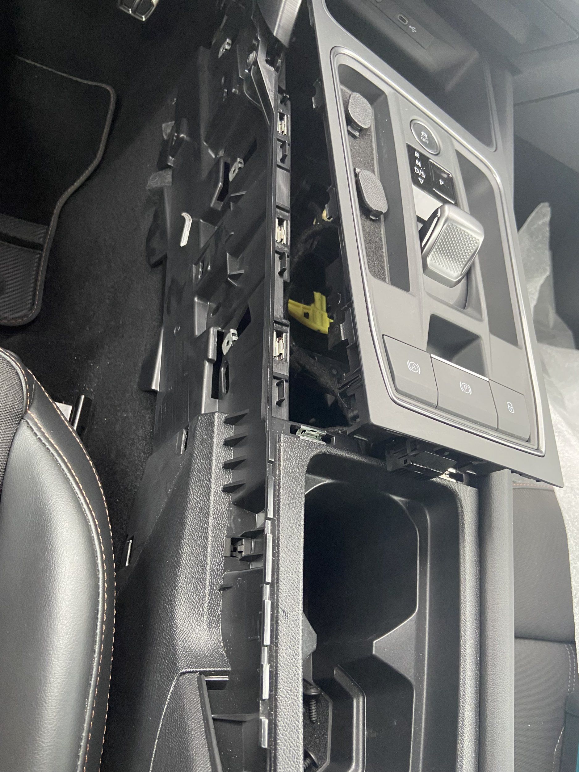

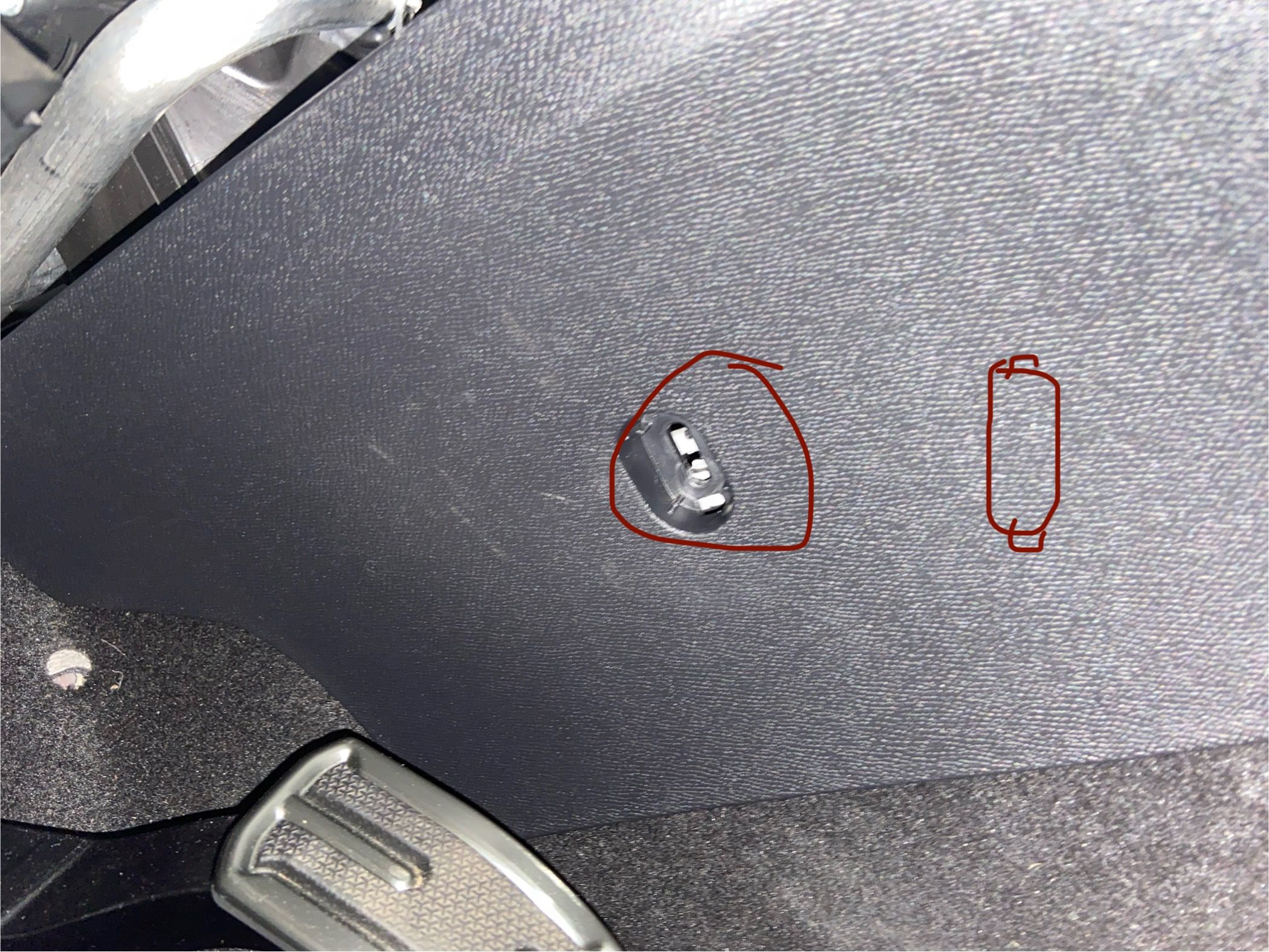

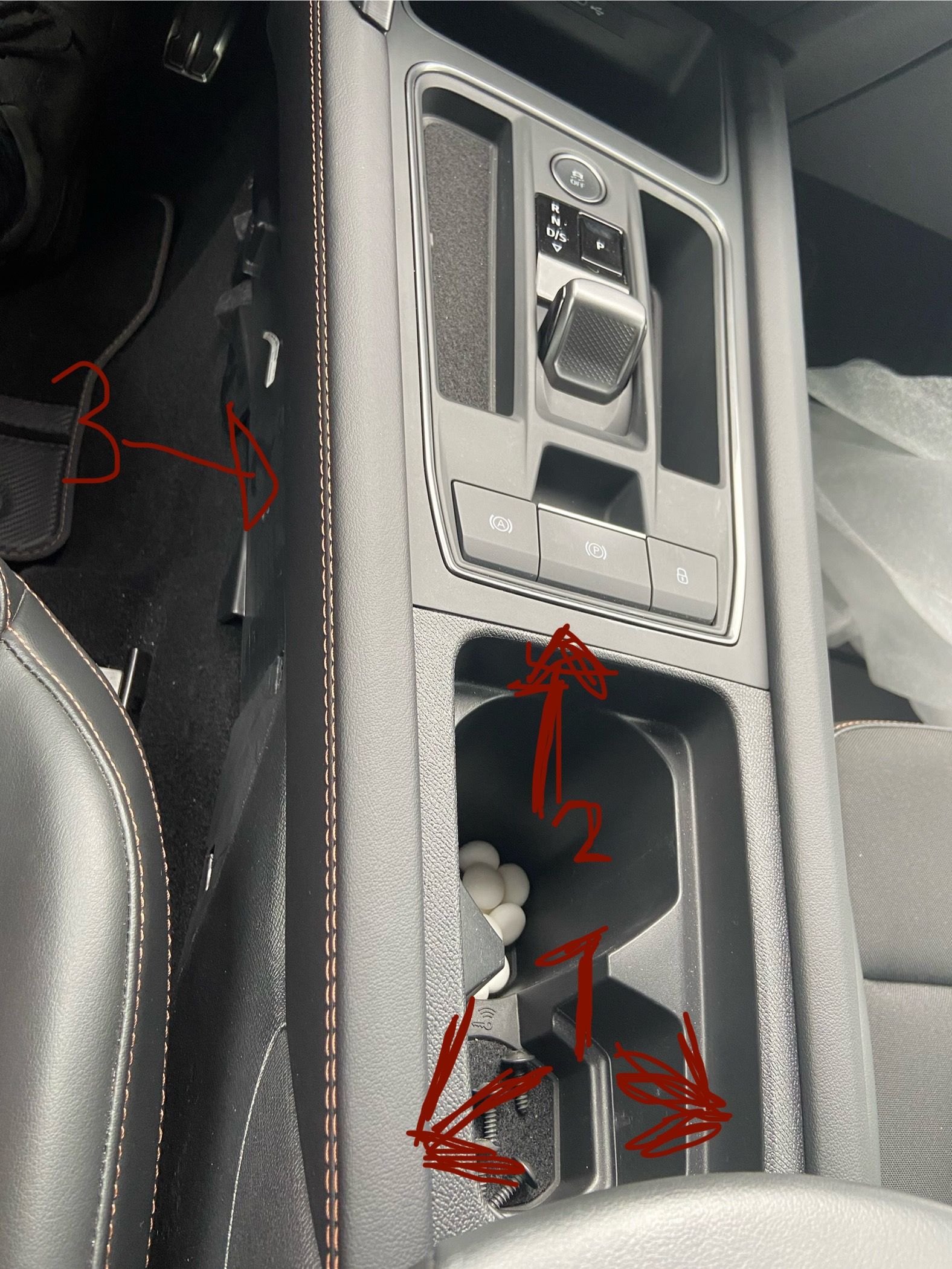

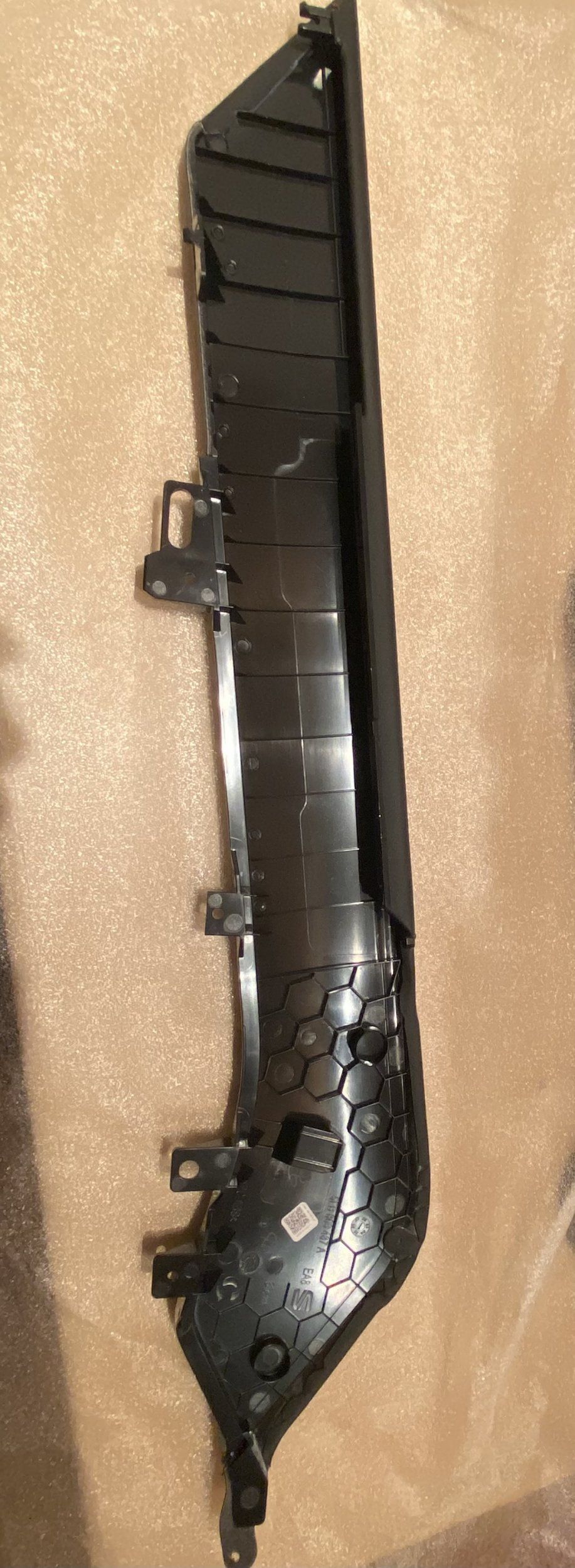

1. check if your panel has the same attachment points as in the picture, but I doubt there are different versions (apart from left and right)

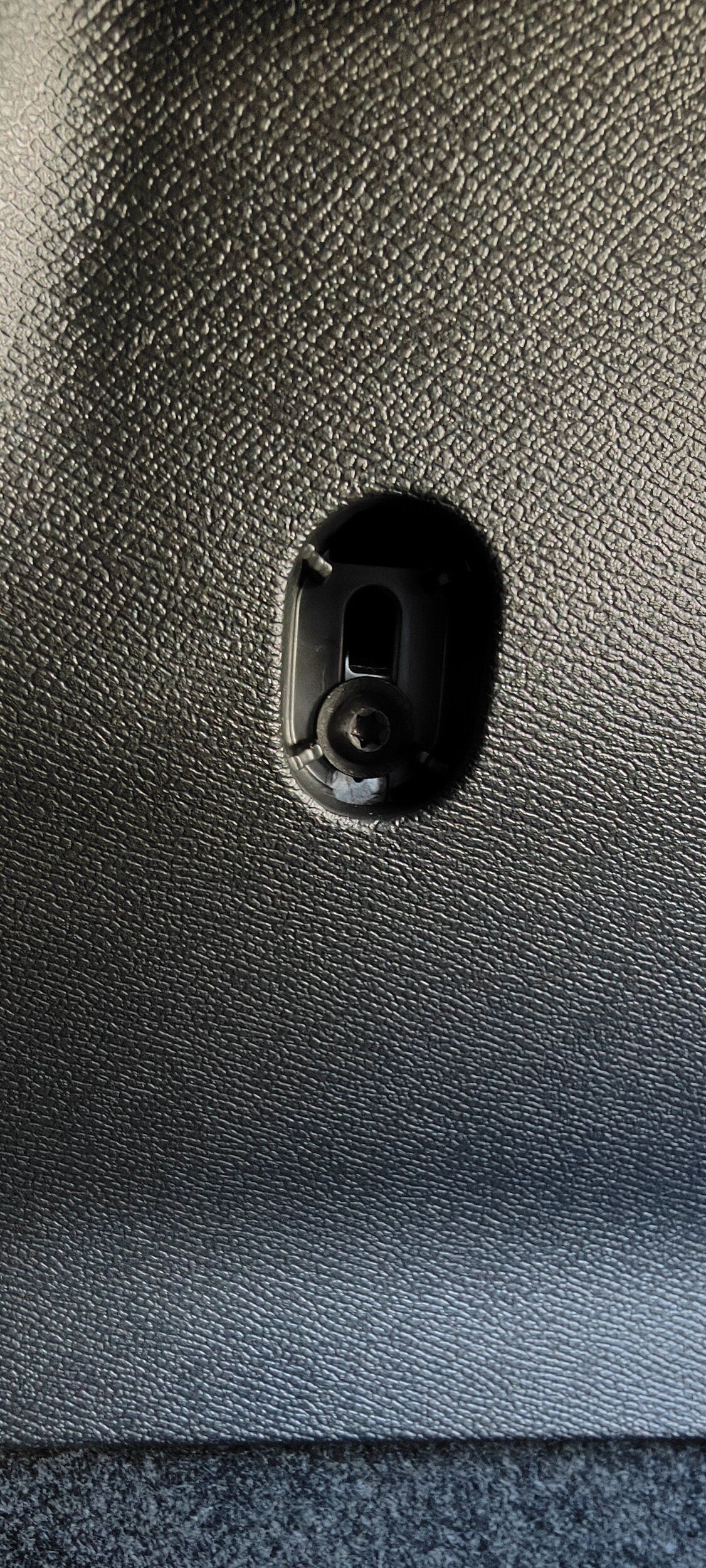

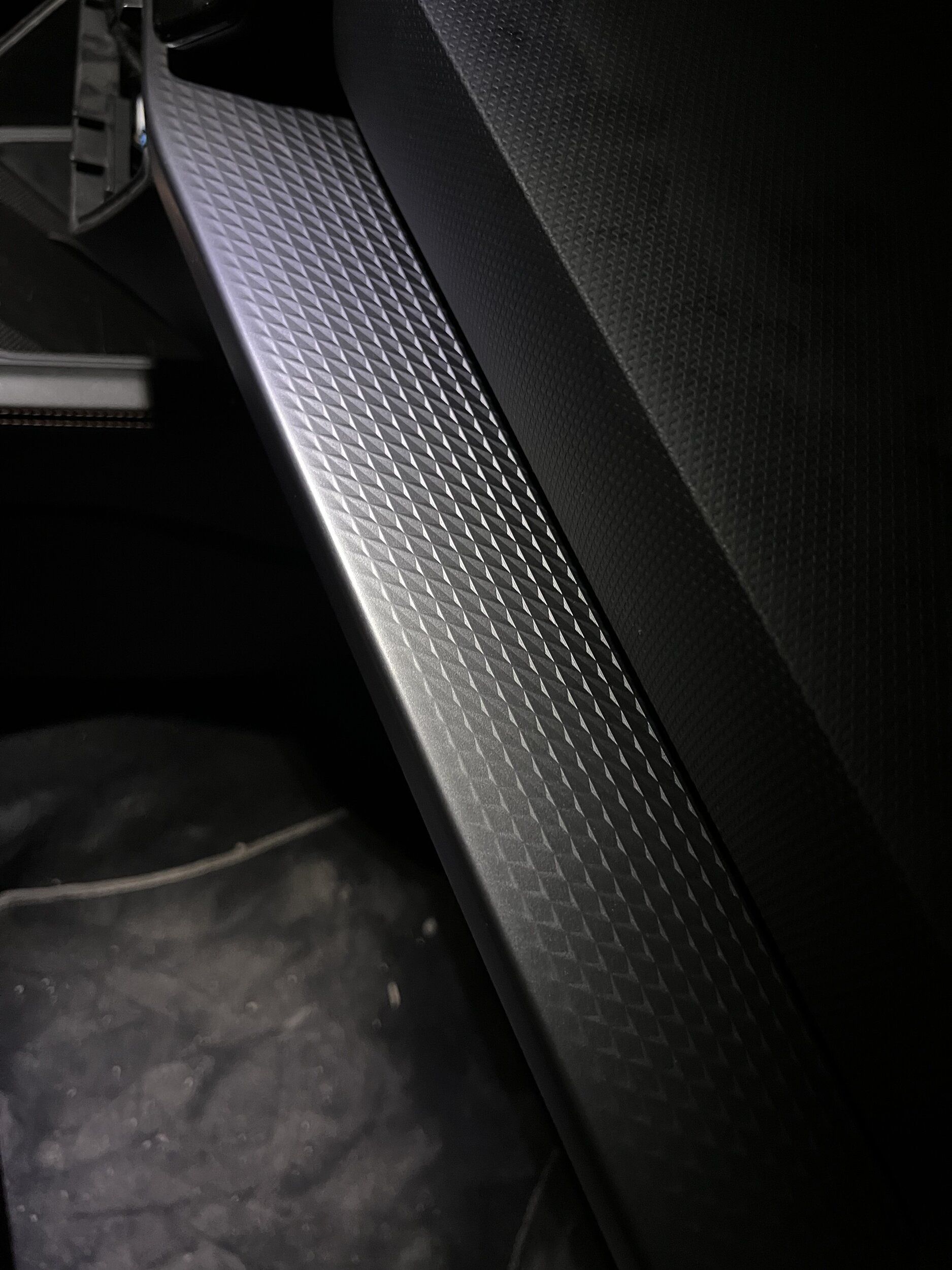

2. remove screws front side of the lower panels (can also cover these in leather, but I like the contrast between panels)

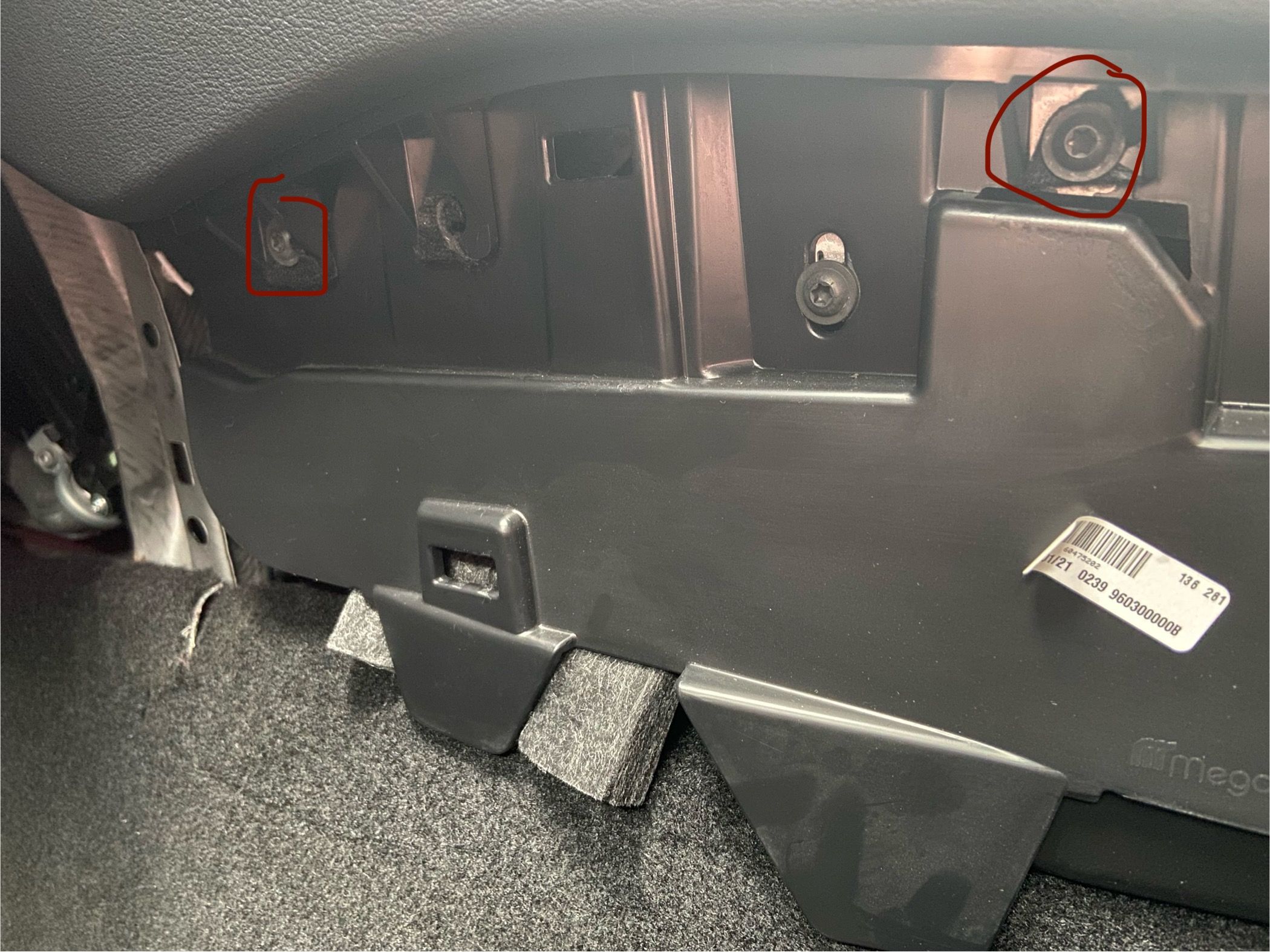

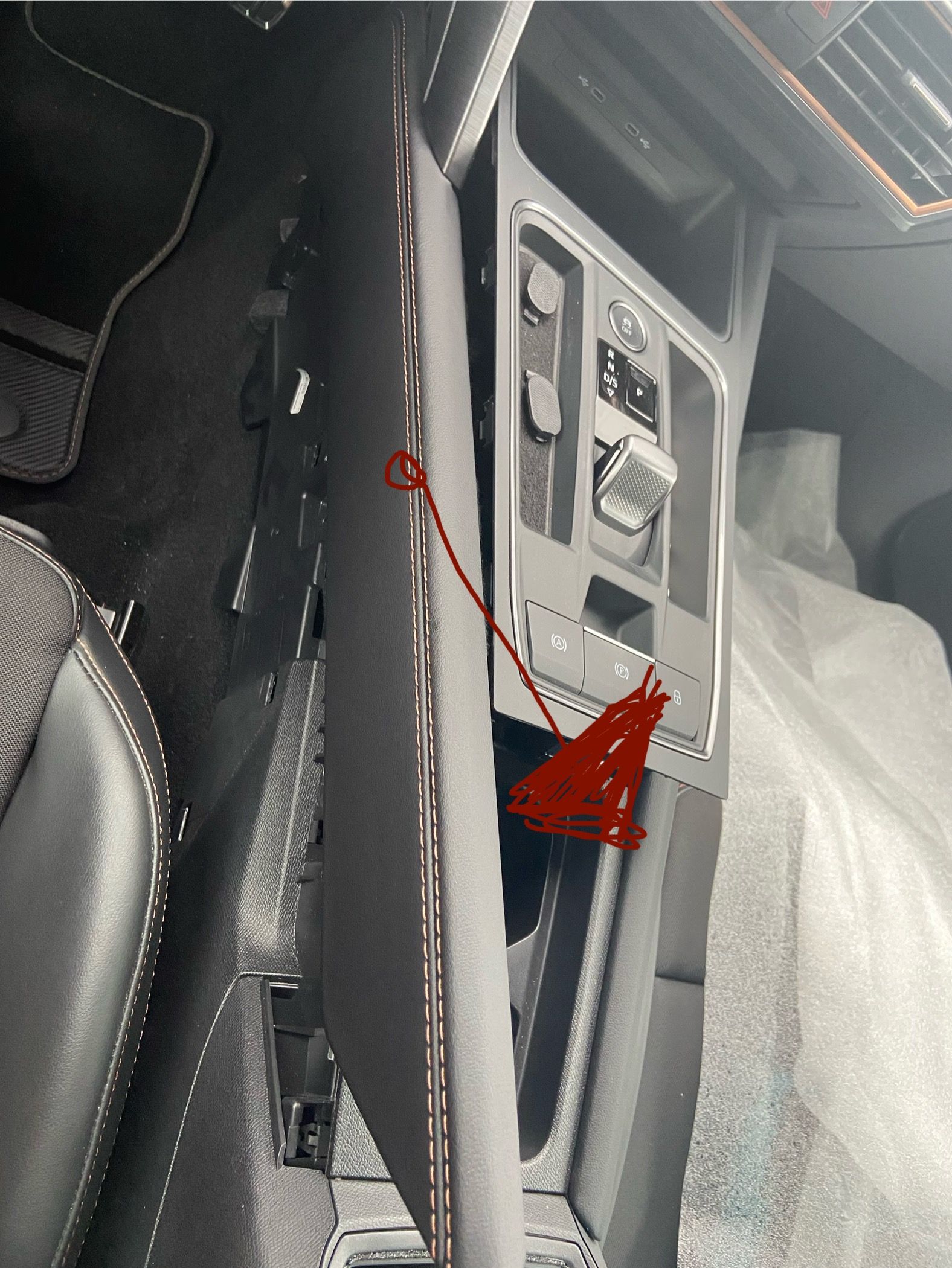

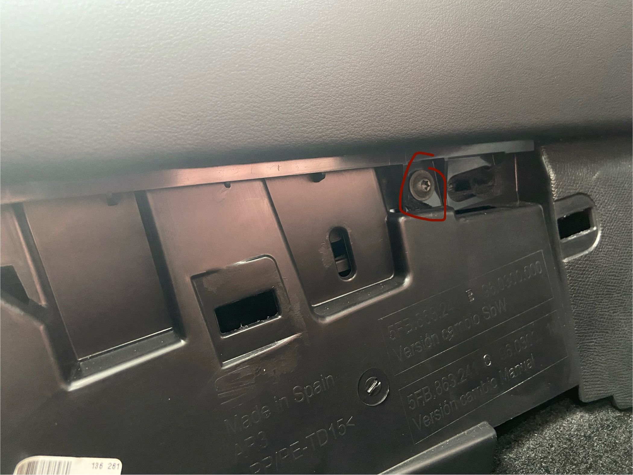

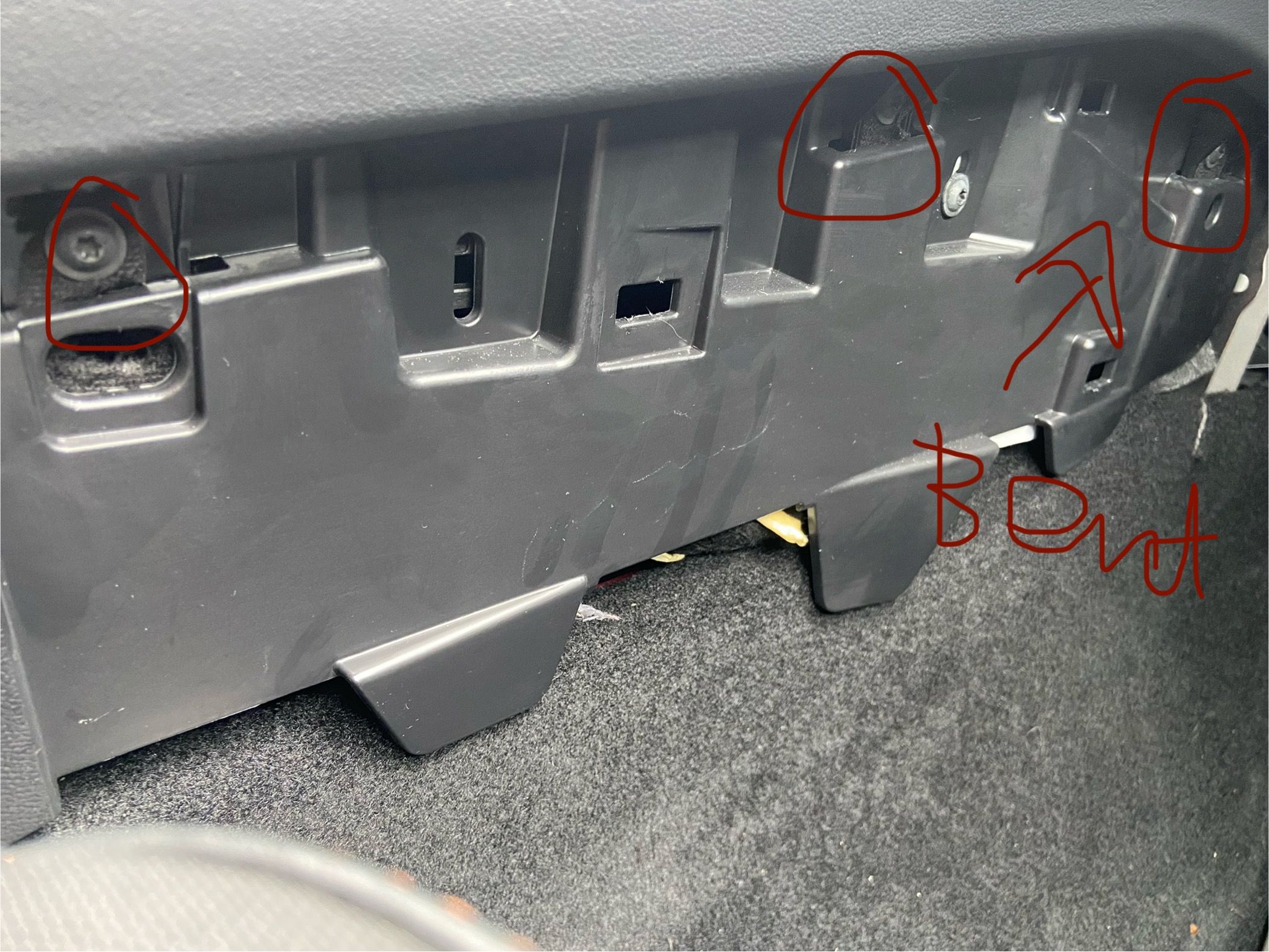

3. Remove 3 screws from both sides, locations in pictures for both sides
4. Remove the upper panels by first lifting the rear up, then ‘sliding’ them out.

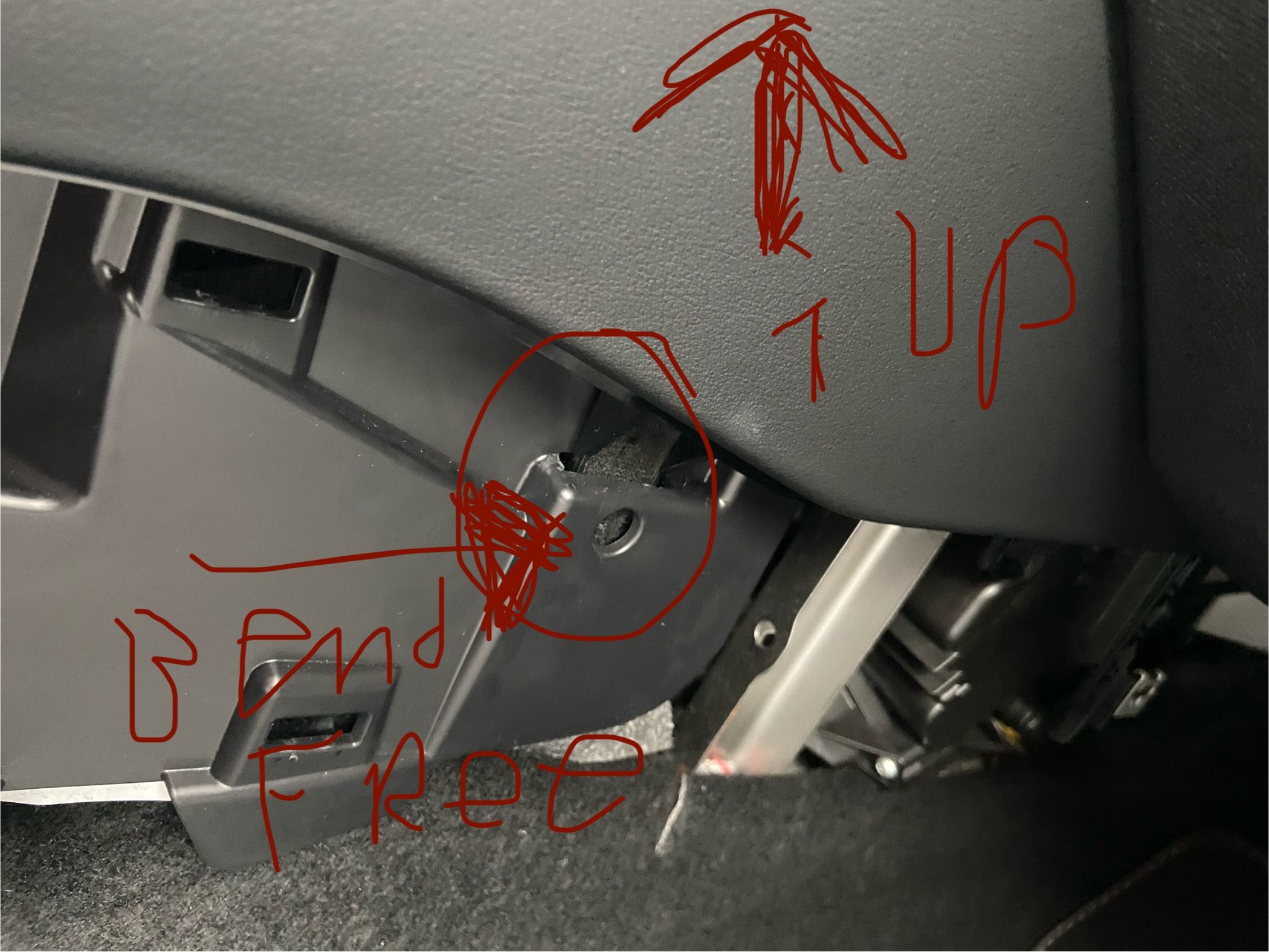

*Note that with the right side (passenger seat) you have to bend the screw hole to get it out. I marked it in the pictures.

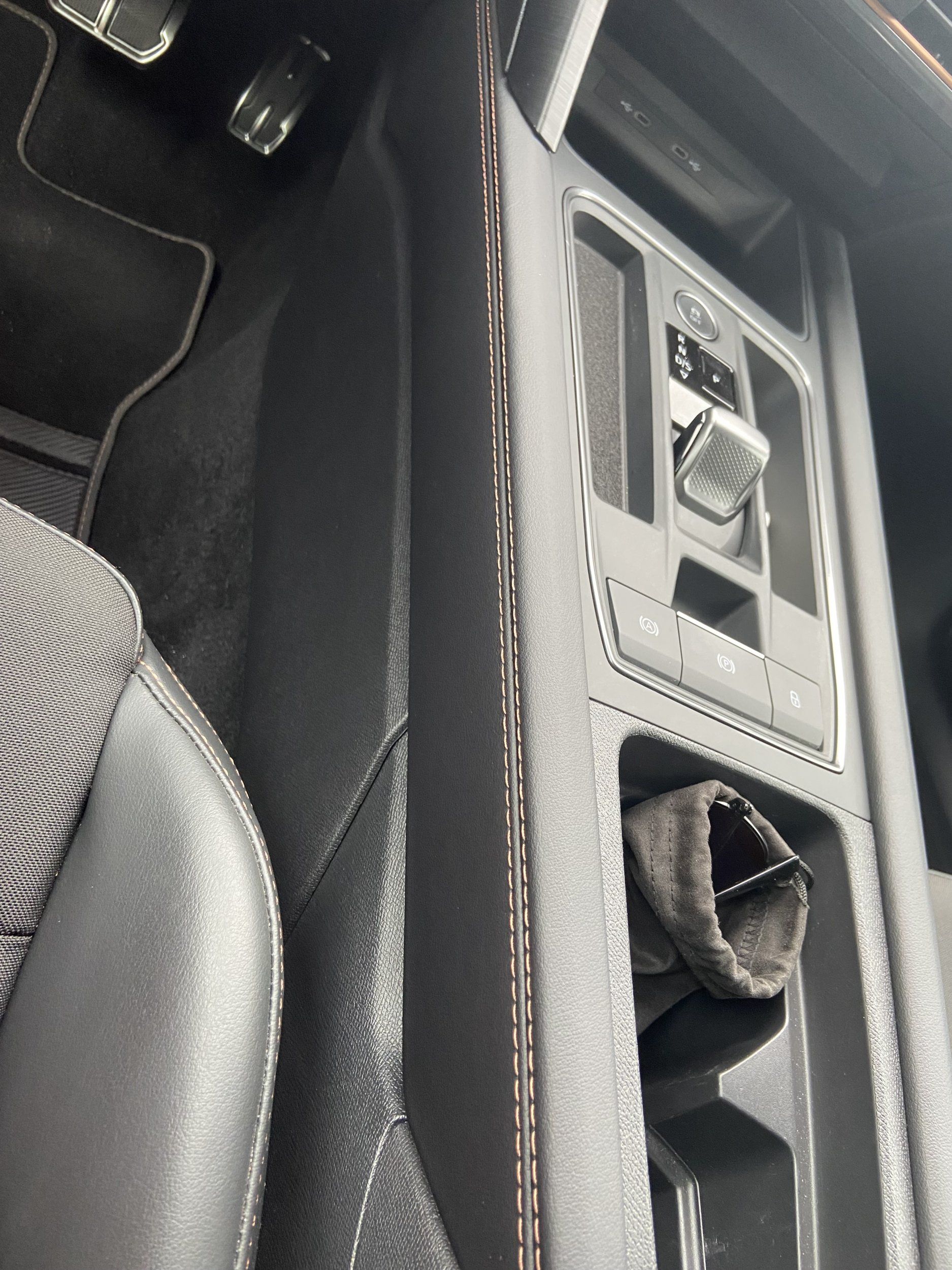

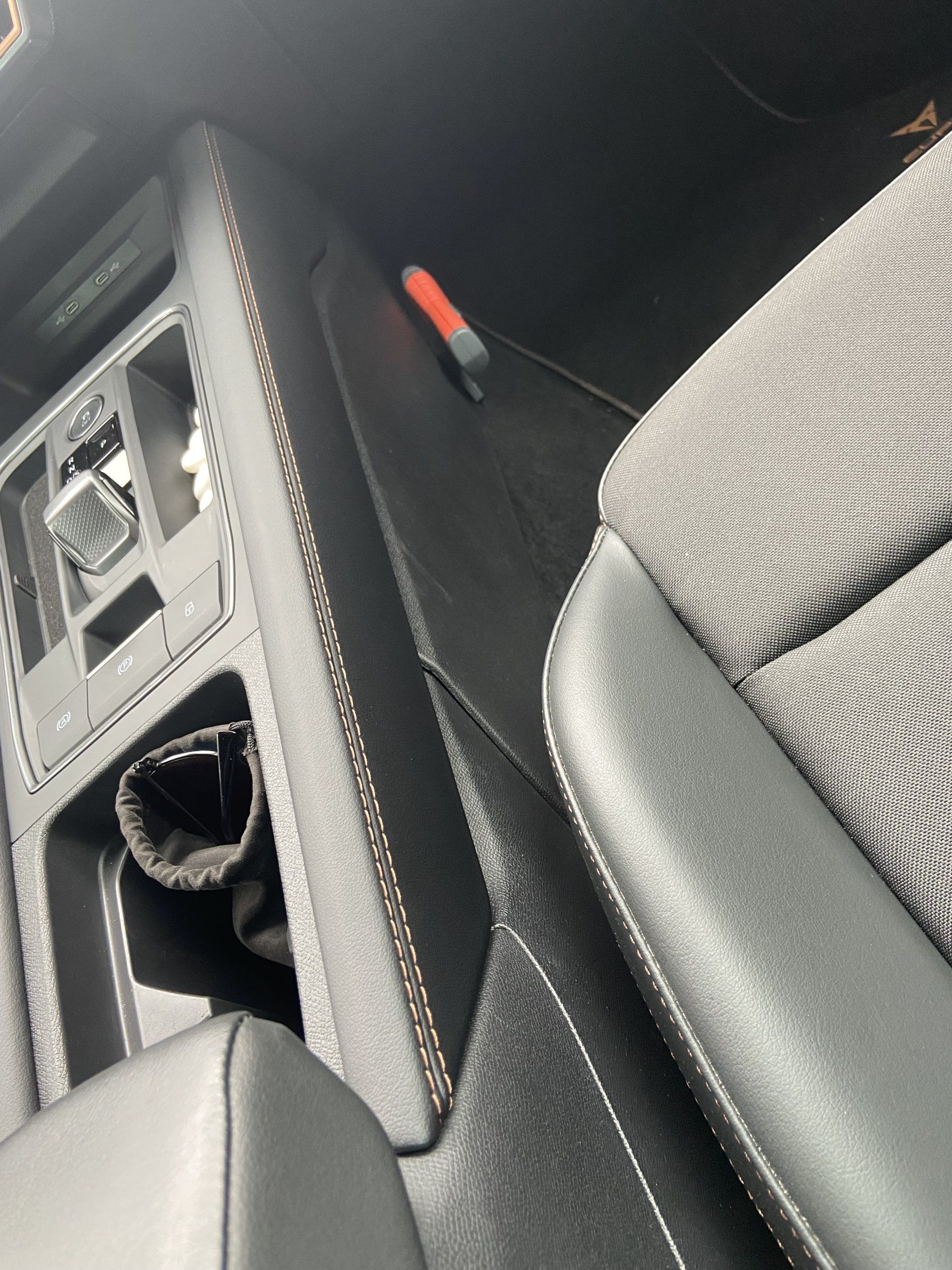

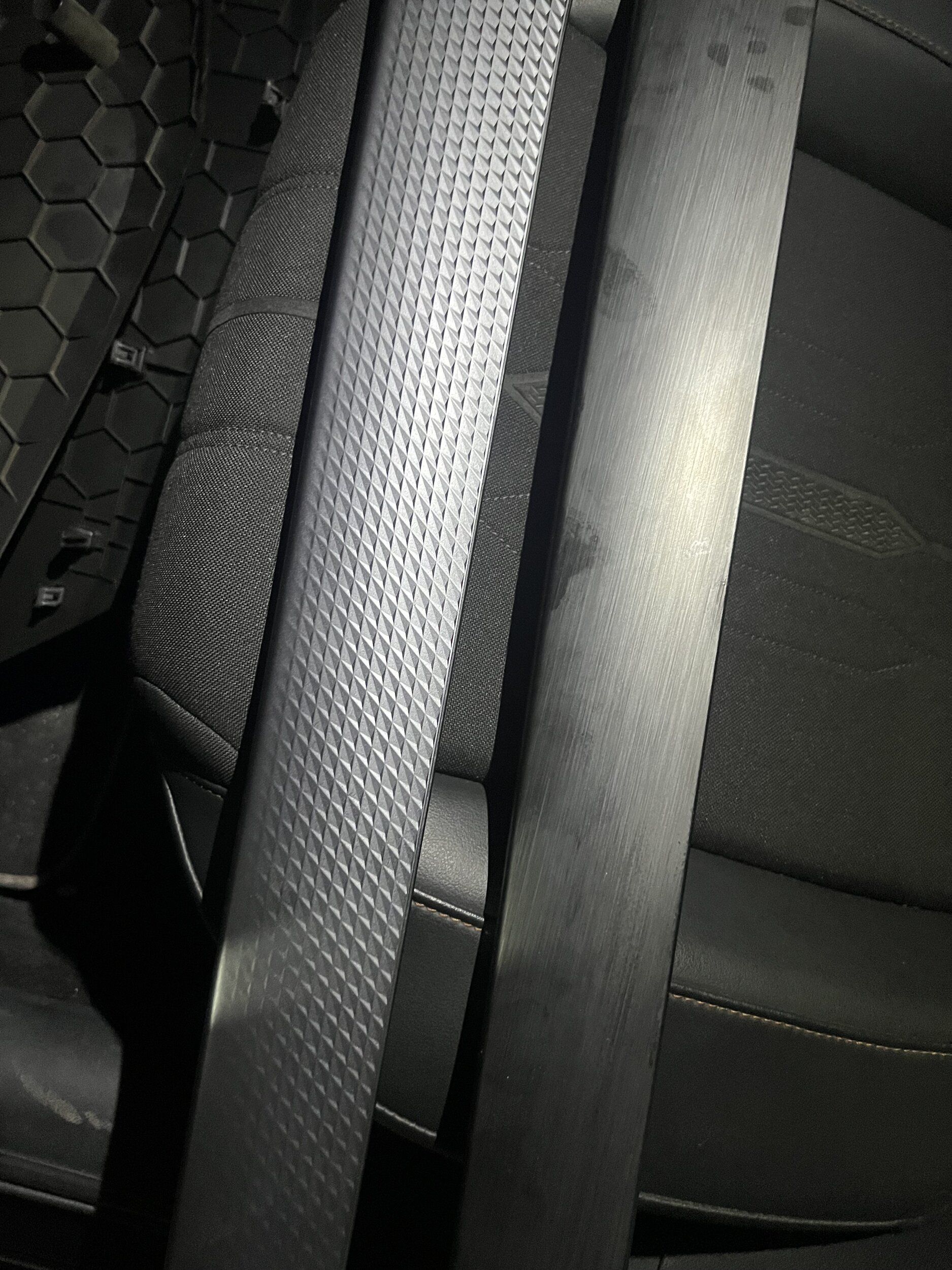

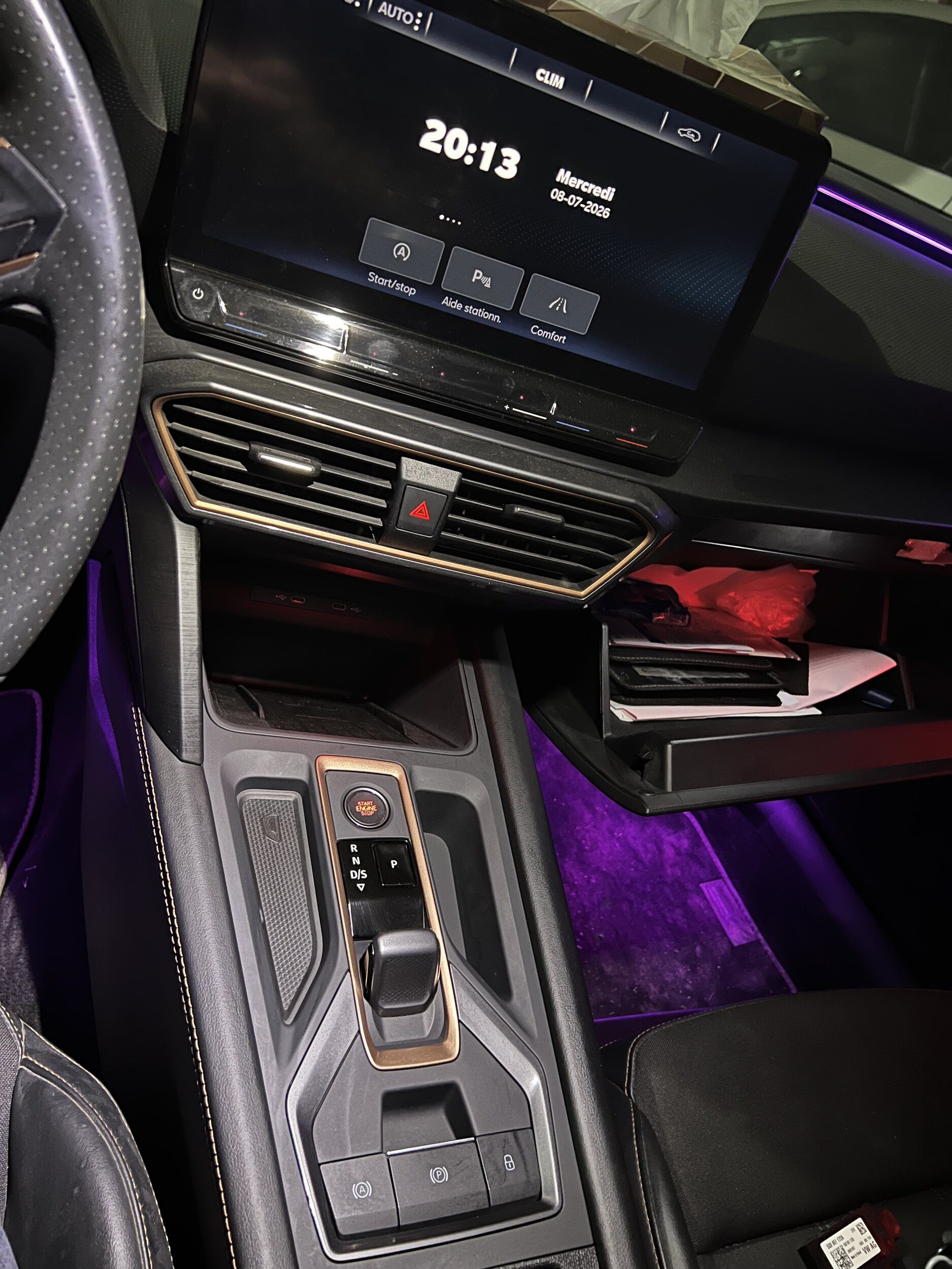

7. End result. It looks like factory made. You can also remove panels and let a company add leather to it, but it might not fit as well afterwards.
