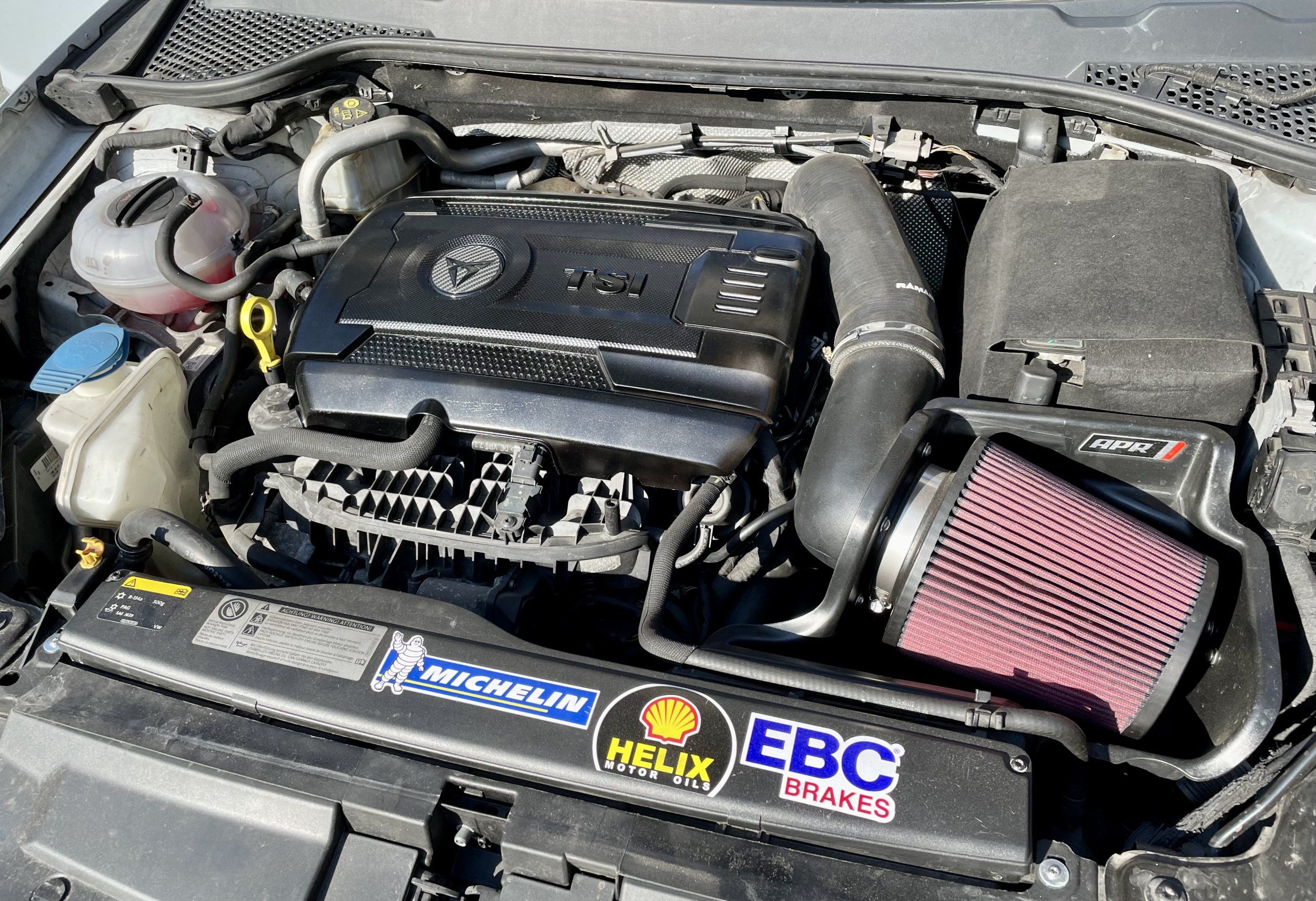

I have this setup on my mk3 Leon Cupra. APR intake, Ramair elbow and hose. Not loud at all. Slight noise when lifting off, that’s it.
