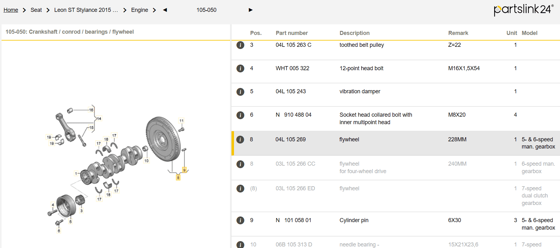

Here's the flywheel look-up result for your VIN.
The drawing at the left is just for illustration purposes, actual parts may look different.
A search on Google using the part number may return results with actual photos of used parts and that would also help, I believe.
The part number is 04L105269

That part number is a solid flywheel.

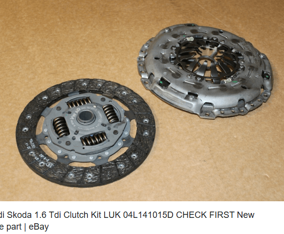

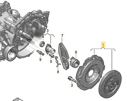

Personally I would suspect your (sprung) clutch plate first rather than your release bearing for a rattling noise - if you have changed your gearbox oil.
You have a simple clutch release lever and remote slave cylinder - rather than the stupid concentric type.
