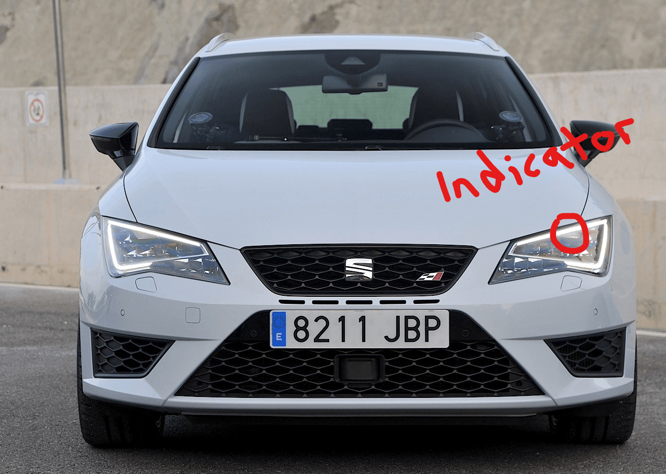

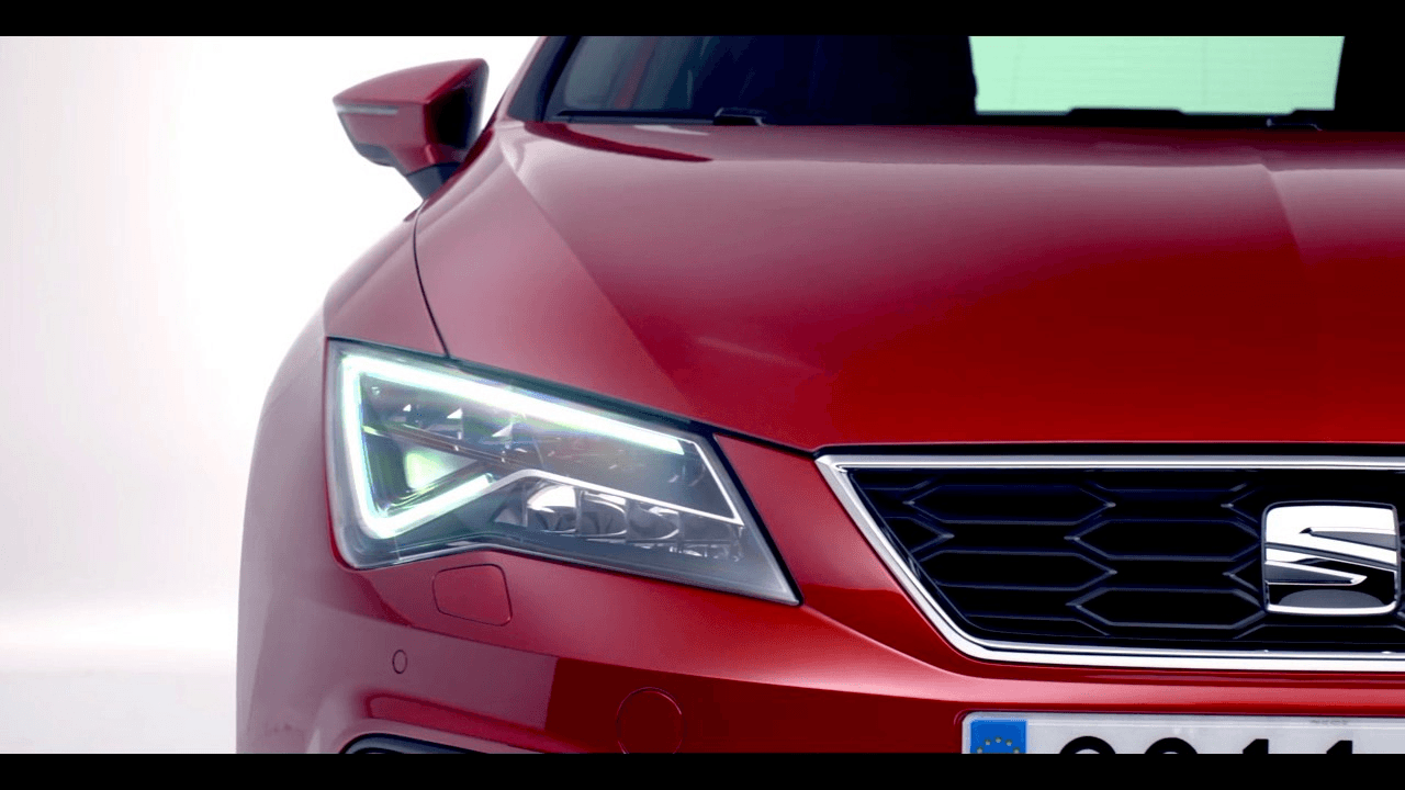

OMG, you'd really expect a dealer to know whether your car is a facelift or not.
If your car is a Cupra I coudl easily list a number of things to help identify whether its a facelift or not, but as you've not stated what car you have its a little harder.
Simplest is the Seat badge on the front:
Pre facelifts on the front have the Smaller S, the facelifts have the larger one.
If you have LED lights there is a difference in their style, indicators are little triangles (and bulbs on the rear), where as on the facelift, on the front the day time running lights flash orange and on the rear are along line that flashes on both parts of the rear light (ie boot lid and body).
Facelift on the left:
There are plenty of other potential differences, but model spec can confuse matters...
