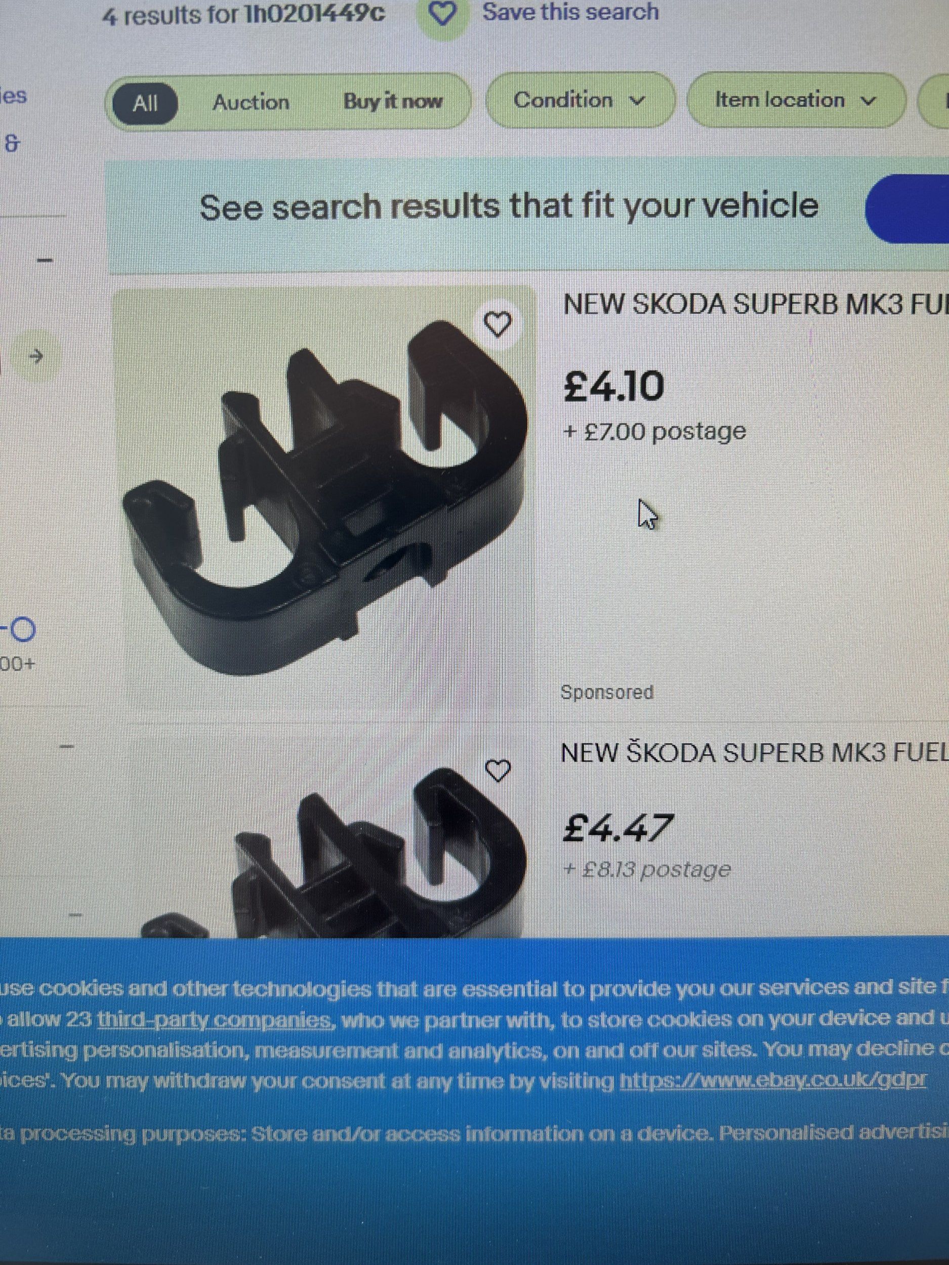

This was the cause to my problem. The fuel line was vibrating as this was cable tied together.
