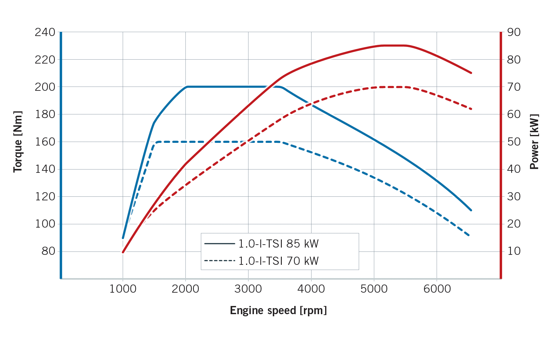

Here's 1.0TSI torque graph:

It’s not only about torque, it’s about power too. From the graphs you can clearly see the power at 2000RPM is less than max power (about 55hp). With my engine it feels easier on the engine to drive at 73mph than 68 in top gear (Especially uphill) even if both are in max torque region.
