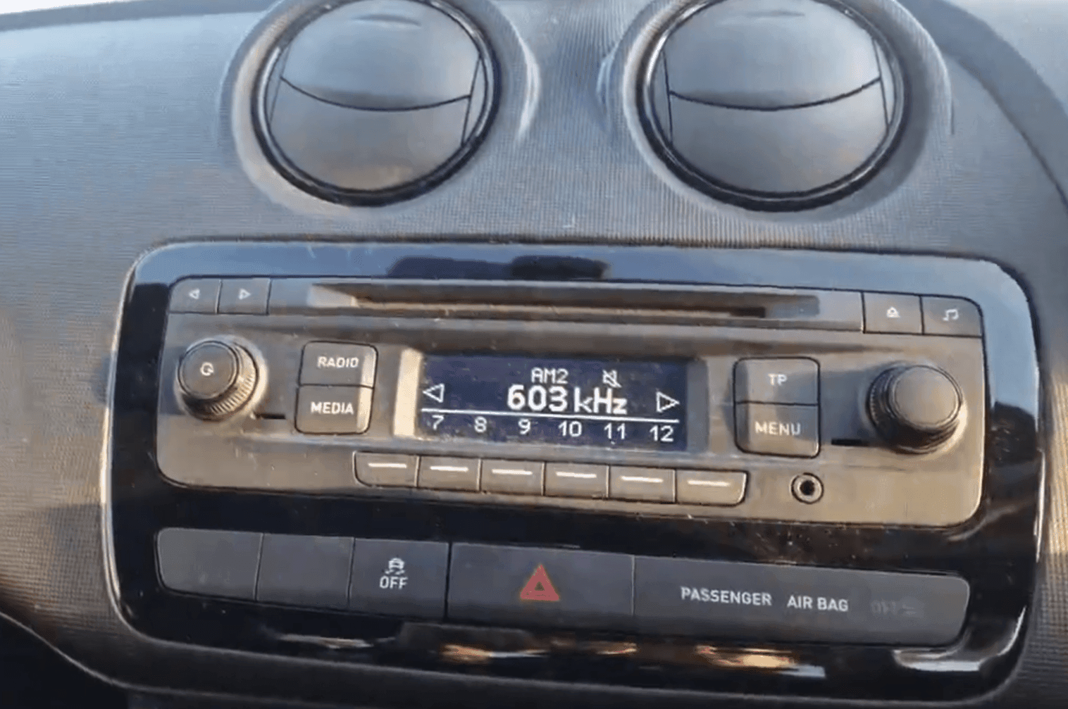

Looking to update the head unit / radio system on my 2015 Ibiza cupra 1.4 But due to it having the hazards and those buttons as part of the head unit its proving to be a bit of a challenge, Has anyone else changed a head unit on one of these and if so was this a problem at all? Thanks.

The buttons can be relocated, I have done this to mine. You need to buy the updated button panel for infront of the cup holder and the wiring to match.
