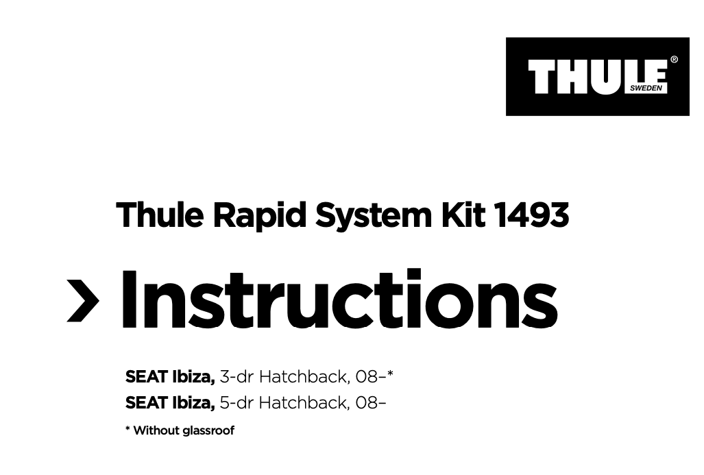

Hi to all!
Does anyone know if you can have roof bars/rack mounted on Ibiza 6J 5dr with panoramic sunroof? There is some mixed information on the internet and don't know what is true?
Thule has only remark for 3dr that it's not suitable for sunroof....what about 5dr?
Thanks to all :)
Not a good idea, very good chance you could break the glass. The car also isn't well suited for tailgate mounted bike rakes.
Best bet to get a tow bar fitted and use a tow bar mounted bike rack, storage box or even a trailer (depending on what you want to do). However note the car is only rated for about 1000kg towing.
