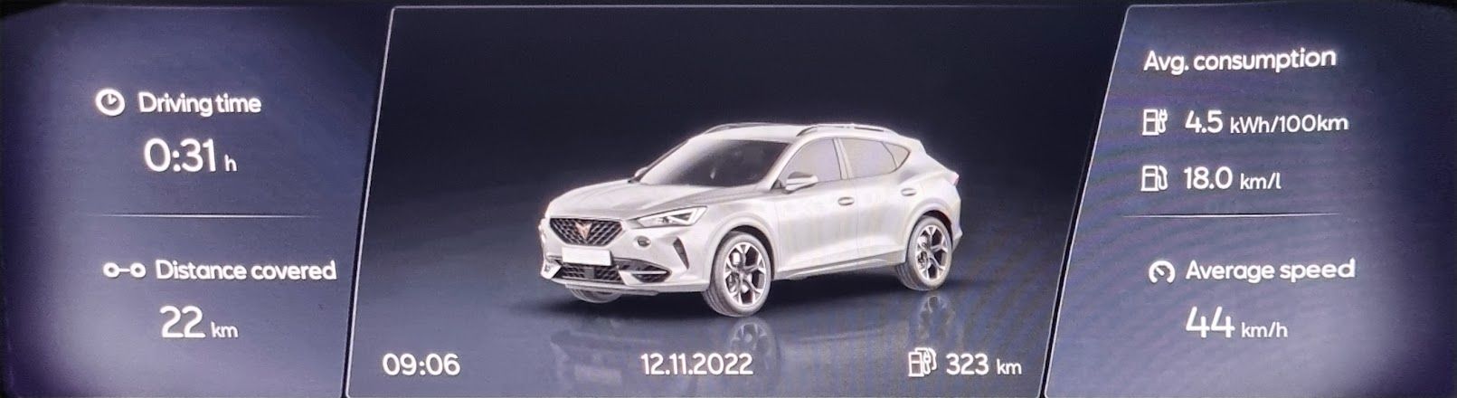

1: Like Hizzards say, start the engine by pressing the accelerator all the way (while in Park or N). It will always use electric range when you start it up on electric, as it uses the battery to run cabin heating etc.
2: ECO-mode can be found when setting up the Individual mode, but right-foot discipline is always the best. Learn to roll and break evenly so it regenerates as much as possible instead of using the disc brakes.
3: It is indicated in some of the cockpit views by an orange RPM meter that drops to a blue bar when the engine switches of. That's the only visual indication you get
4: 40% points extra charge sounds right for 2 hours in a standard wall socket.
From my own experience, when in hybrid you use very little battery on the straights. I get around 40-50 km on a full charge running pure electric. Around 200 km in hybrid, but that depends a lot on whether you're in Sport or D, and driving in city or rural/highway.
Sport will conserve battery the best, since the threshold for starting the engine is at much lower throttle, and lower speed. I'm driving a lot in sport these days, since petrol is cheaper until I get a new electricity plan.
Using 40% of your charge on a 4 mile trip in hybrid sounds like a lot! Try getting some more miles and more data.
Note the consumption after each trip:
This is an average everyday trip for me, mainly straights with 4 km of city driving. If you have an issue, it's either high consumption or low capacity - this data will tell us which.
EDIT: Adjusted numbers and added picture
