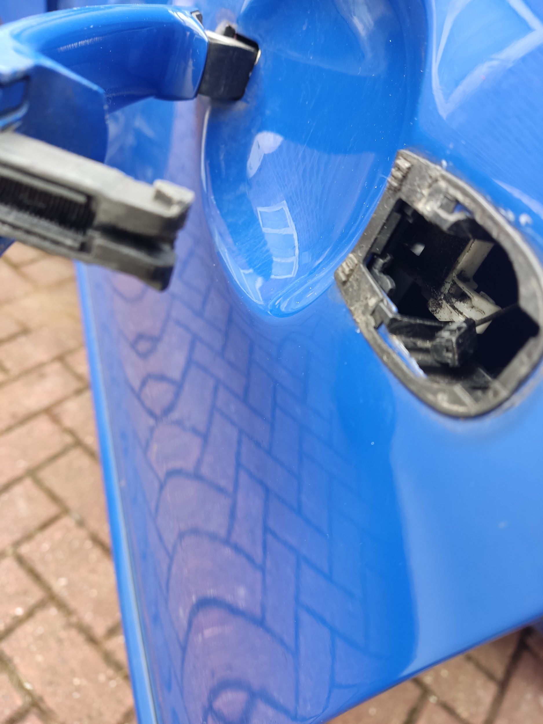

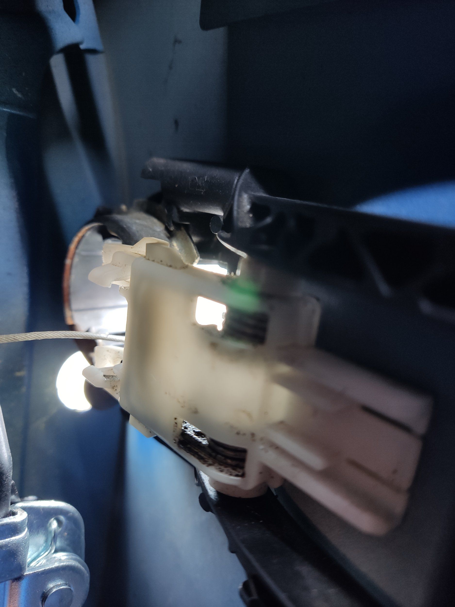

I have replaced the door actuator again but the door handle came off in the process can anyone tell me how to clip it back in? Thanks

looking at the second photo looks like you may have to manipulate the hinged side in a bit more,

Happened to me that, you need three hands lol, that plastic part with spring needs lifting to guide it in hard to explain but it only goes in one way it helps if you can see what your bloody doing
