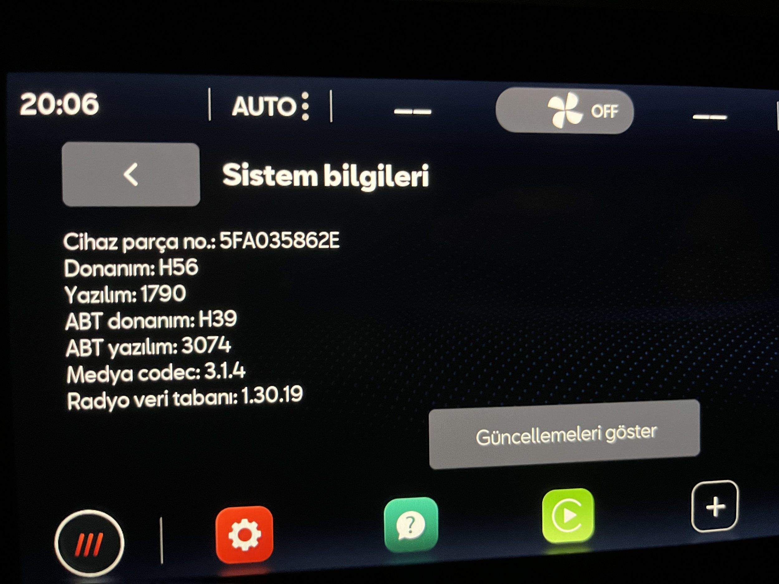

Hello everyone, I drive a 2021 Leon FR 1.5 TSI Manual. The car is without the options such as smart ambient lighting etc.
I live in Turkey and unfortunately we don’t have Seat Connect. So, OTA updates are not available in my case.
I have heard that software updates can be done with only a USB stick and having the right installation files. I am not sure how it is done and don’t know where to get the update installation files.
My software version seems to be 1790. The System info menu screen is included in the attached files.
Any chance you can inform me about this issue? Thanks in advance and have a good day.

The warranty was 2 years, thus the car doesn’t have one anymore. There aren’t any major issues with it but it could work a little bit faster and smoother. Also, resolution when using car play isn’t great, in my opinion.
I have found installation files for the software update, now need to get a type C usb stick drive.
