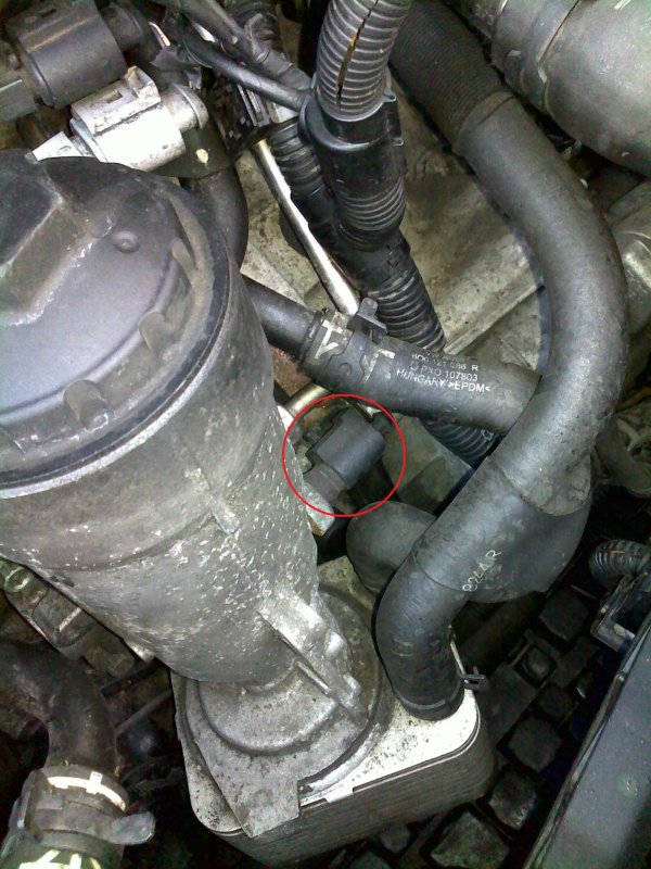

basically i was told that the oil filter isnt like most cars where it screws in, so i cant fit the sensor for an oil temperature gauge (which i already have)
anyone know if someone has ever fitted an oil temperature gauge and if so how?
how did seat manage to fit the standard one?

The sensor for the temp gauge screws into an opening in the filter housing. All you would do it take out the blanking plug, fit the sensor and wire it in.

anychance you could get a picture?
