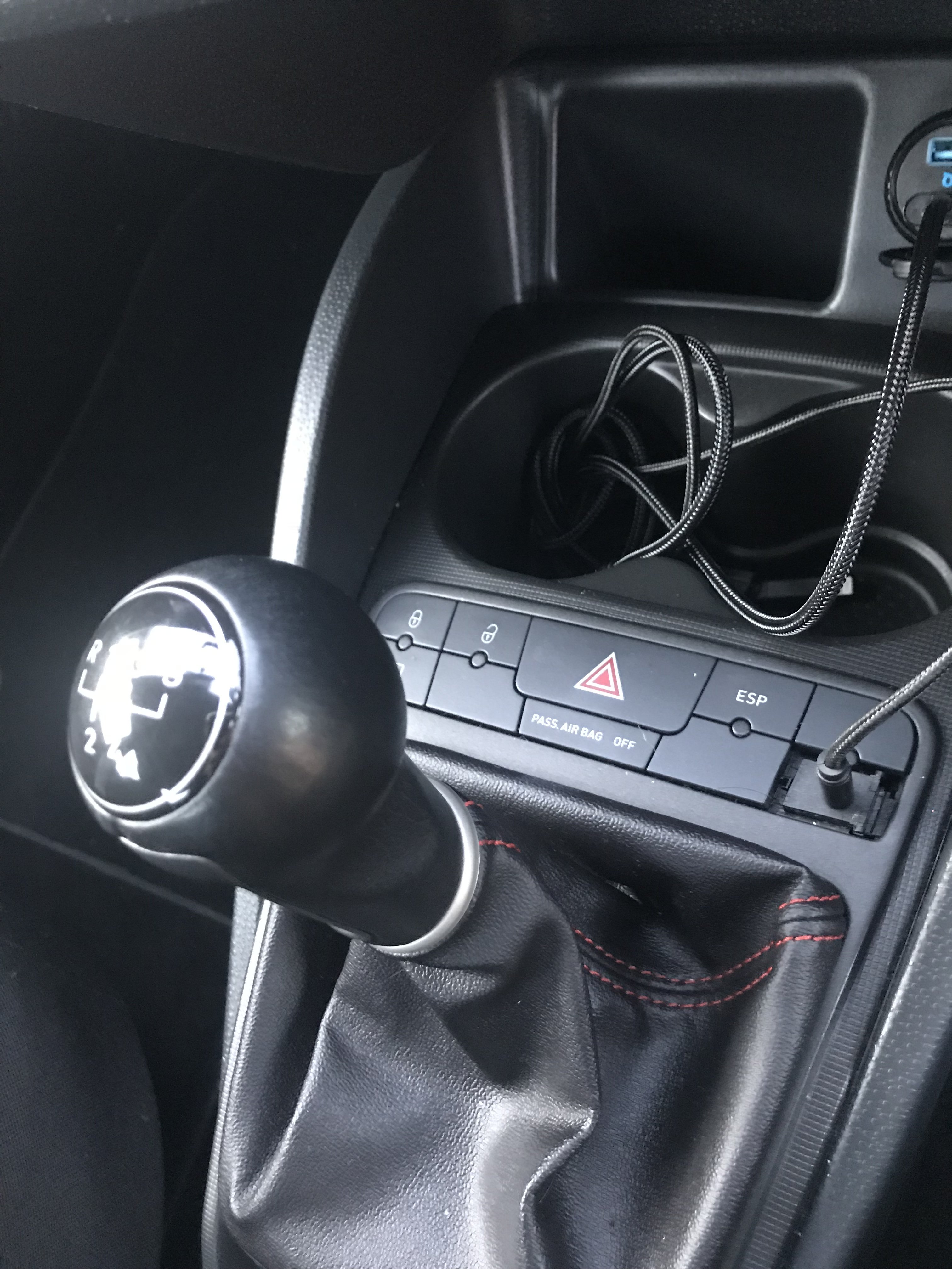

Not sure tbh it states in the manual if I’m my car has esp then I will have hill assist, photo inside car:

Try it out. Stop facing up a hill. Put the handbrake on. Ready to pull away, release handbrake. Does it roll backwards or not?
Although, our Ibiza can simulate hillhold with rusted on rear drums :)

That’s what I’m gettingat, I will give it a try this then if it doesn’t work, will pressing the esp button have anything effect ?
