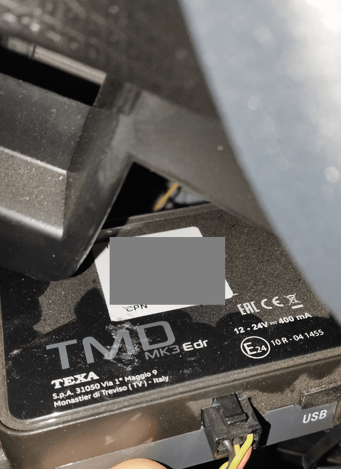

Trying to find an annoying rattle behind the dash, and I've noticed this mounted immediately behind the driver's side end panel on the dashboard- it has a green flashing LED live all the time, and a mini USB port. It is a part of the car, or a tracker fitted by the previous owner??? Wanting to know if it can be removed. The earthing point does not look OEM to me.
Thank you.
It's a TEXA TMD MK3 Edr module.

Yes the vehicle was an ex-Arval lease hire. I've spoken to Arval and they have denied any knowledge of it, and say they do not fit them to their vehicles.
My main issue is that the green LED light is constantly flashing, so obviously transmitting data to someone at somewhere unknown. As I have owned the car outright for over 12 months, obviously any data it is logging is private and should not be getting transmitted to anyone unknown or unauthorised.
Question is how is this fitted - can it simply be unplugged and removed, or it is integrated into the car's systems. Last thing I want is to remove it and have the car disabled and undriveable.
Many thanks
It won't be integrated into the cars systems, does that cable go anywhere else or connect to anything else?
It might not be transmitting data, it might be trying to pair with a control module that's already been taken out?
Quick update - Arval have again confirmed in writing that the tracker was not fitted by them, and the single user of the vehicle under a PCP deal from Arval that had the car before me also denies any knowledge of it being there. A copy of the email from Arval with the previous user's details removed says that he never had or authorised a tracker to be fitted, and that he himself is looking into the privacy legality of it all (GDPR etc), seemingly with the go-ahead from Arval to do just that. Only feasible place this had been fitted was one of the fleet workshops it had visited in its early life.
Don't know what capacity the internal battery is in the thing, but the LED on the unit is still flashing away 5 weeks after removing it from the vehicle - its sat in a tupperware box in the garage at the moment. Still hoping that someone, somewhere is getting a constant tamper alarm on their system for the thing being disconnected from the car!
But no issues with the car since removing it and it seems to have solved the battery drain issue I was having whilst it was parked up not being used.
Thanks again for the replies and suggestions, much appreciated.

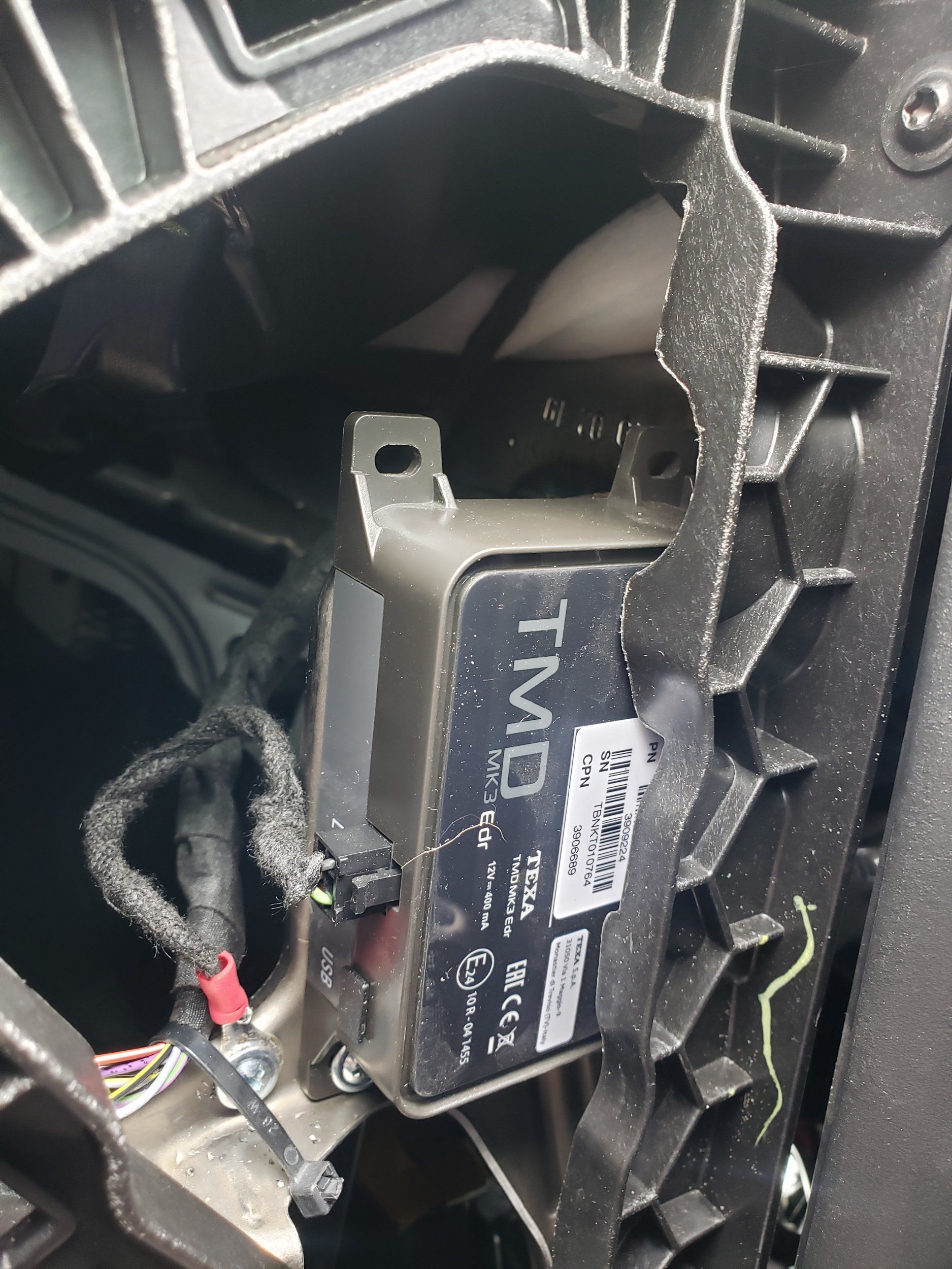

I realize this is an old thread, but I wanted to confirm that the tracking/diagnostics device was 100% installed by Arval - no matter what they claim. I also purchased a used Arval-fleet car directly from Arval in Hungary and discovered the same tracking device in my vehicle (see image below). It’s still connected because I haven’t taken the time to remove it yet. That said, you can be absolutely certain that Arval installed it.

As far as removing it goes, you'll find that there are only 3 wires - an ignition live, a permanent live and an earth. It is not connected into the canbus or other wiring, and is perfectly safe to disconnect and remove.

P.S.: I've disconnected the device and the car didn't blow up ;) I also found the user manual - attached.

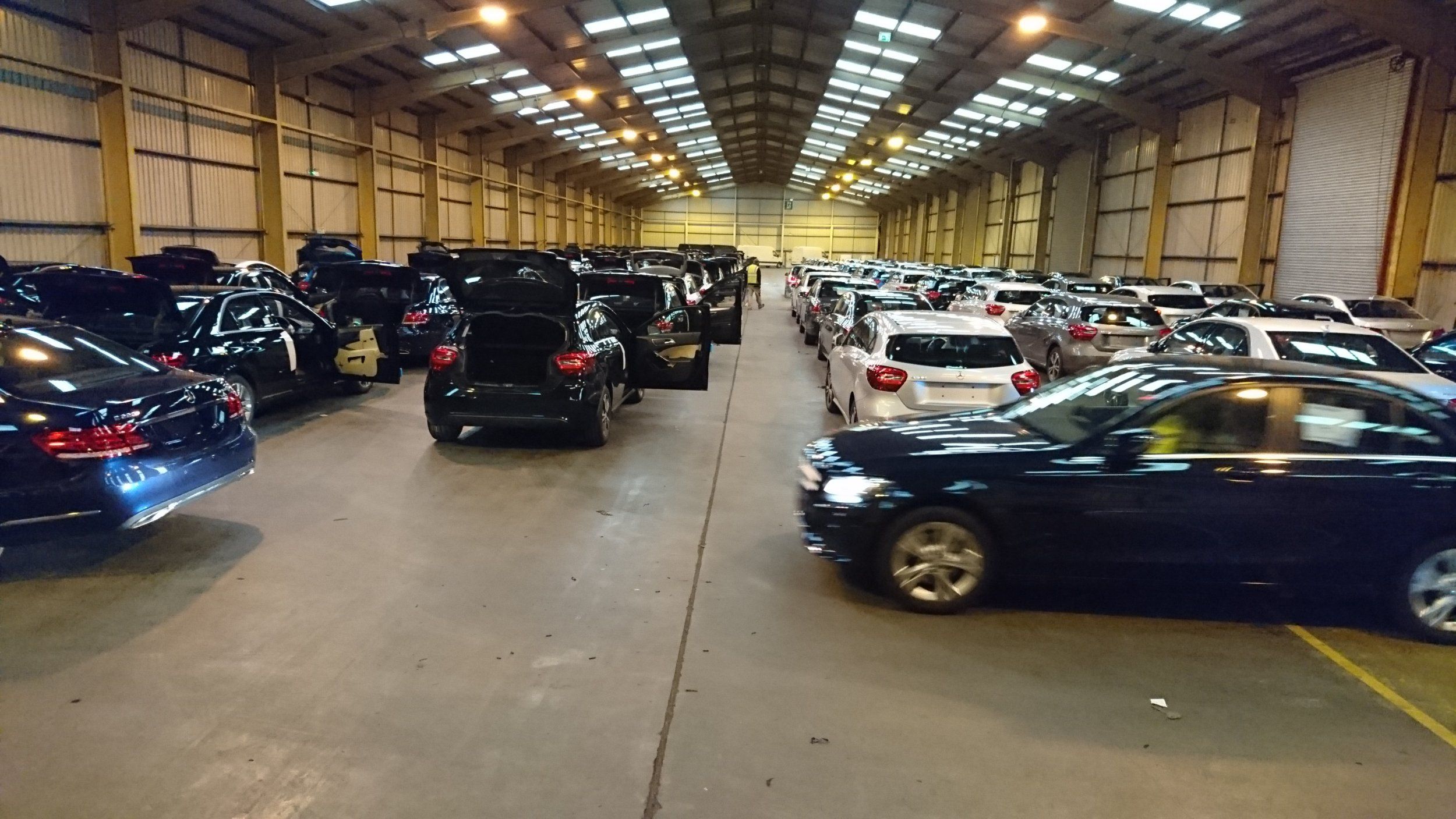

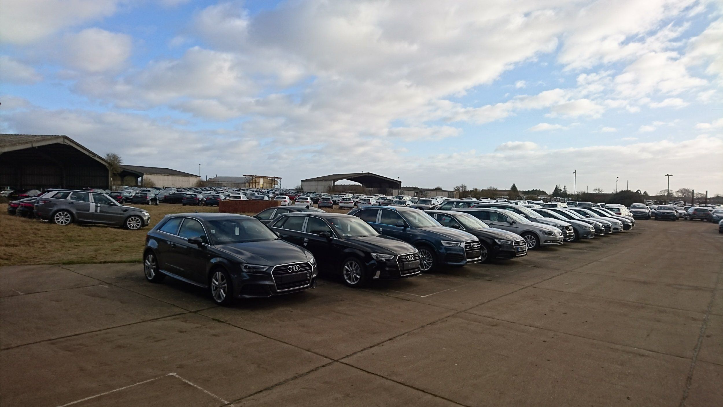

All hire/lease companies have asset tracking. Enterprise, Europcar, Sixt, Hertz, Avis, Zipcar etc etc etc... I used to fit/service/remove the trackers for most of the national brands.
The trackers are used for asset recovery if the vehicle is stolen/not returned and mileage data.
Just cut and chuck. 99% of people in the companies won't have a clue about the trackers. Some will know more than others but generally they won't know as they are fitted by 3rd parties on behalf of the companies when the cars are new at PDI centres before the cars even get to the hire depots.
Here I am at an undisclosed location with a team fitting units into a fleet of Mercs that are fresh off the boat
and another undisclosed location for VW Group/JLR Tracker fits
The data doesn't identify the driver, just the vehicle info such as Reg, VIN, Mileage, colour... Basically, only the info needed for recovering a stolen vehicle.
