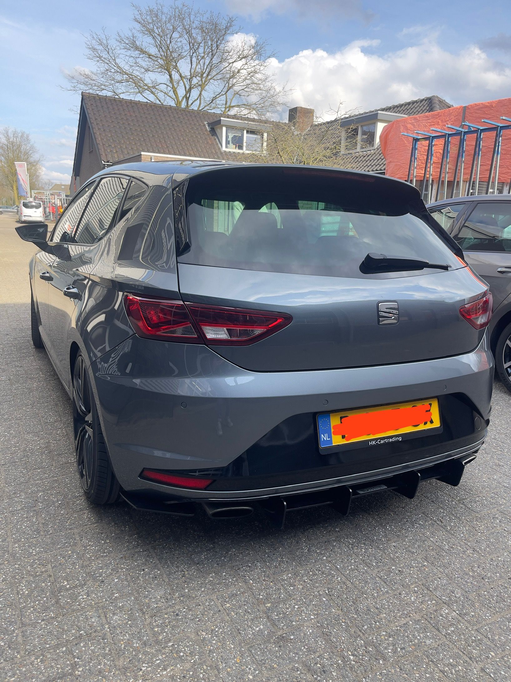

Today I close a deal for a Leon Cupra 280 from 2015 with 150.000km and well maintained! I’ll pick it up Wednesday

Congrats and nice Maxton bits. I would replace the old exhaust tips, that will upgrade the look immediately
Unfortunately I dont know about the difference in mileage, maybe ask the seller?
Thanks! I'm also thinking about changing the exhaust tips... not sure if I'll go for the double one or the single one. Need to get some inspiration elsewhere :p
