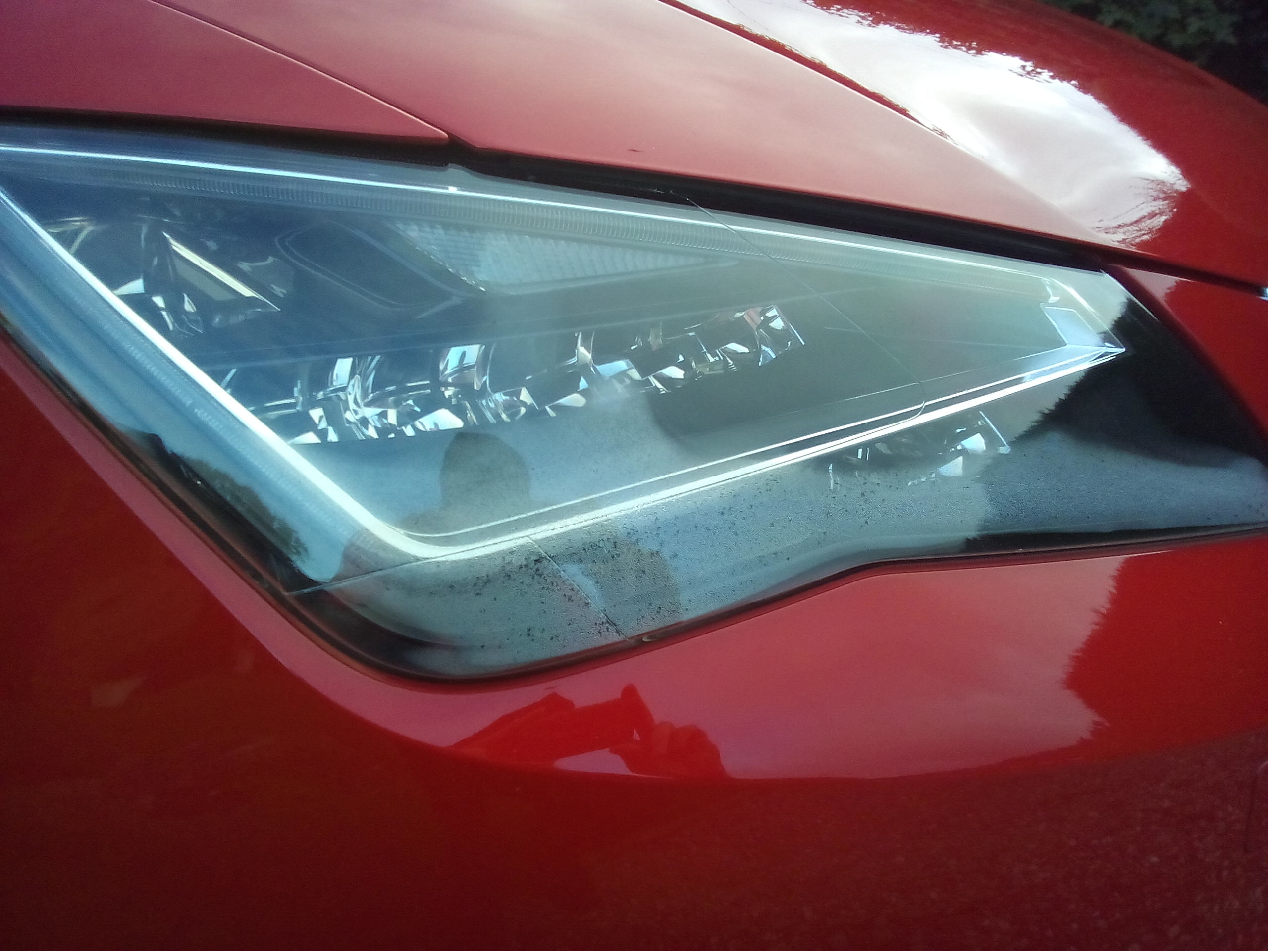

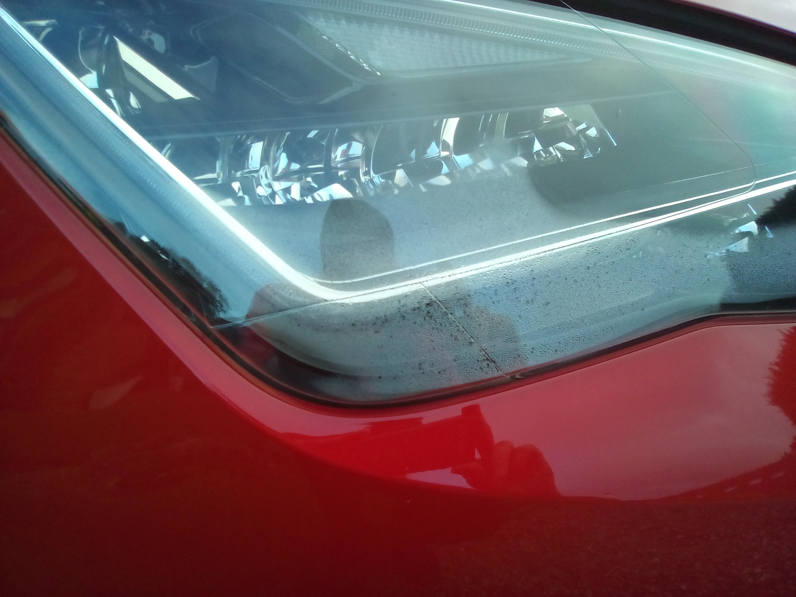

Hi,
Got lots of condensation in my headlights (led ones) mainly in the drivers side but a little in the passenger side according to the dealer I've spoke to this is normal, so does anyone else have this normal amount of condensation in their headlights.
Thanks.

I think at some point many years back Seat changed the manual to basically say condensation in the headlights is normal. Says something like using the headlights during normal use will dry them out.

The LED's generate very little heat, unlike the 'old' halogen bulbs, therefore never really drying the headlight units out. You've got to hope for a sunny warm day to dry them out! I've only had condensation in the lights after washing the car.

Mine had condensation in both when the car arrived new. I waited until a warm day then parked it facing the sun and removed the twist caps at the rear of each, letting them dry out all day before replacing the caps securely. I haven't noticed any condensation problem since.

It isn't possible to make a completely sealed unit, even if there are no serviceable parts inside, but there should be a filter and desiccant over the vent - which I think the earlier models skipped hence why so much dust and moisture in the pre-facelift headlights.

Yes I've noticed that the parts lists now show a filter over the end of the vent pipes, I might consider buying a few of these for my S4 and wife's Polo, dust is certainly a big issue with some car models.

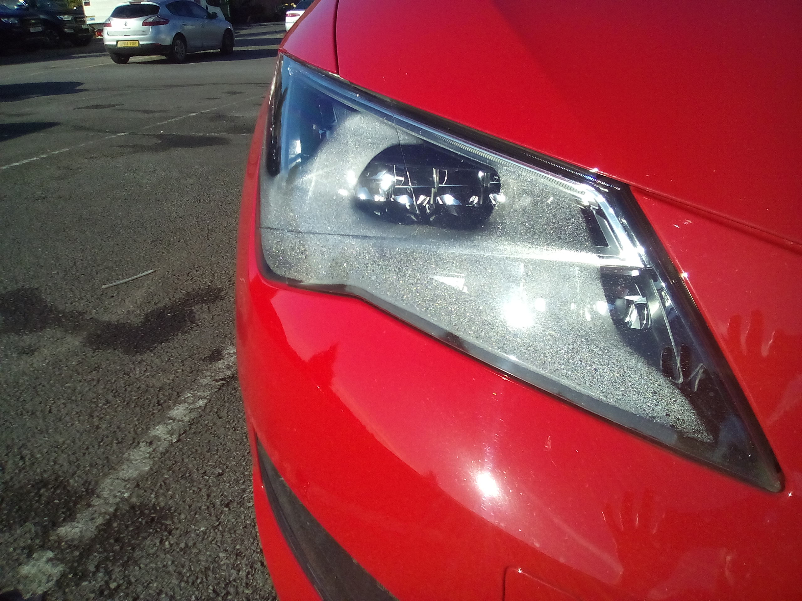

This was taken yesterday after it had been in the sun for a while.
I'll ring round a few other dealers to try and find a sympathetic one.

I've tried driving with lights on but as said LED lights don't create as much heat as bulbs.

LED, but the facelift version. The units aren't sealed and the rear cap just twists off.

I dried mine out by removing the rear caps and directing a hair drier on low into the headlight. Worked nicely!!

Yes it's pretty normal. At least a little like you have. I've seen the same on tons of different cars. I think it's only an issue if it turns into a small pool/lake I'd guess.
I assume the cause is the units aren't designed to be fully sealed, so will allow a small amount of condensation to get in either naturally or as a result of washing the car.

Pretty normal, mine does it (Pre facelift LED's) there is a vent in the headlamp body, however the LED's don't produce any forward radiating heat to clear it, like a normal halogen headlamp would.
