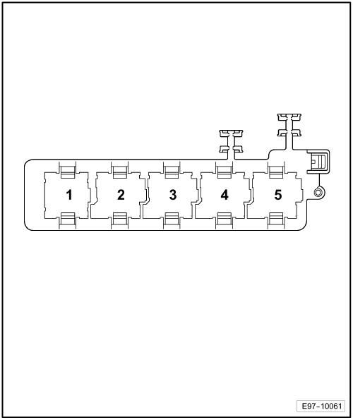

Fusster
Jul 19, 2011
148
Position 1 is for headlamp washer relay,designated 53 or 373
it located in drivers side above pedals ,think you can see it if you remove diag cover,also check fuse 38
hope this helps

Cupra_Jay95
Oct 28, 2010
52
Belfast
hope this helps
Good diagram there. Helped. I used contact cleaner on the relay and replaced the fuse. still no joy. I think the relay maybe burned out. But thanks for the help fellas. Looks like im off to the stealers. Lol.
