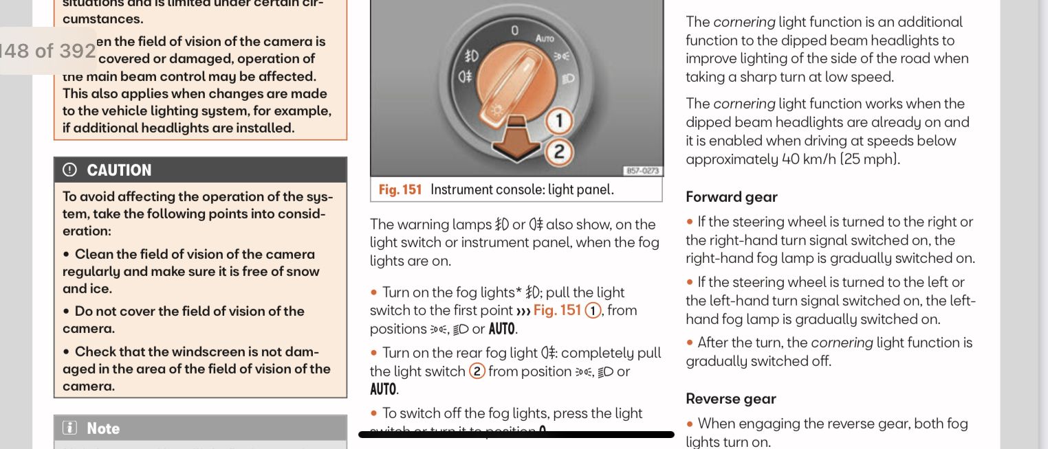

Are you pulling the light switch out towards you when still on the auto setting? Or trying to turn the switch towards the fog light setting?

There's no dash light for the front fogs only for rears
None of the VW’s I’ve owned have had a warning lamp for the on the instrumentation panel for the fog lights - I dare say all VAG cars are the same. I think mine has a warning lamps for the rear fog light but can’t remember as I very rarely use the rear fog light.
If you pull the rotary light switch outwards and turn it to the front fog light symbol, the colour of the symbol (next to the light switch) should change.
I maybe making an incorrect assumption, so apologies if I am, but you’ve not said in your original post whether you actually got out of the car and physically checked the front fog lights - I’m assuming you didn’t. If not, once you’ve turned the light switch to front fogs position check that the symbol next to the switch has changed colour and then check the front fogs are actually on.
From page 144 in the 2018 owners manual;
