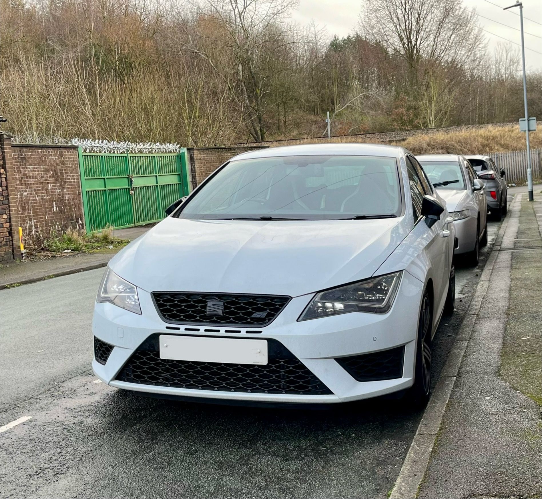

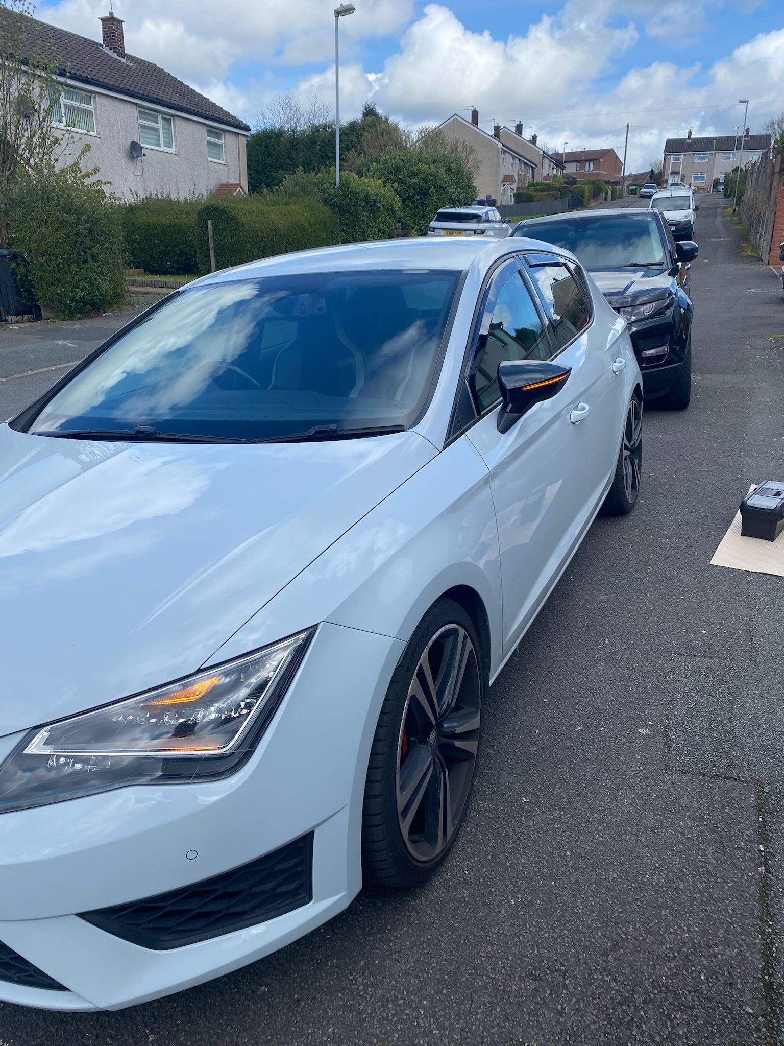

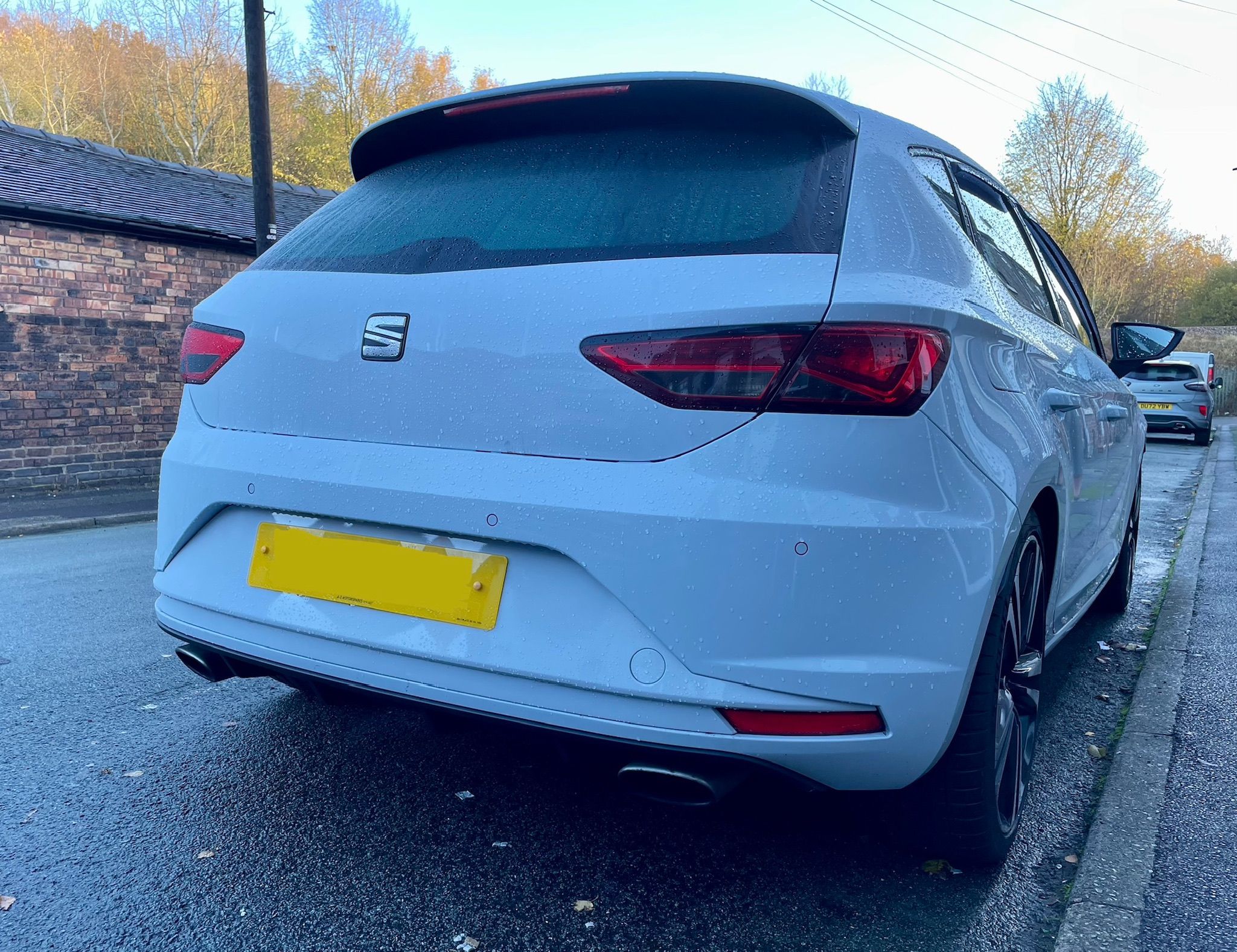

Thought I’d start my own Readers Rides. It’s about time. It’s a 15-reg Leon Cupra 280 DSG, 5-door in Dynamic Grey. Bought the car in January 2022. It has heated bucket seats, no sunroof though. Mods so far (kind of in order):
  • Rear wiper delete (previous to my ownership)
  • Painted engine cover with CUPRA logo (had VW logo when I bought it)
  • Dynamic wing mirror indicators
  • White LED reverse bulb

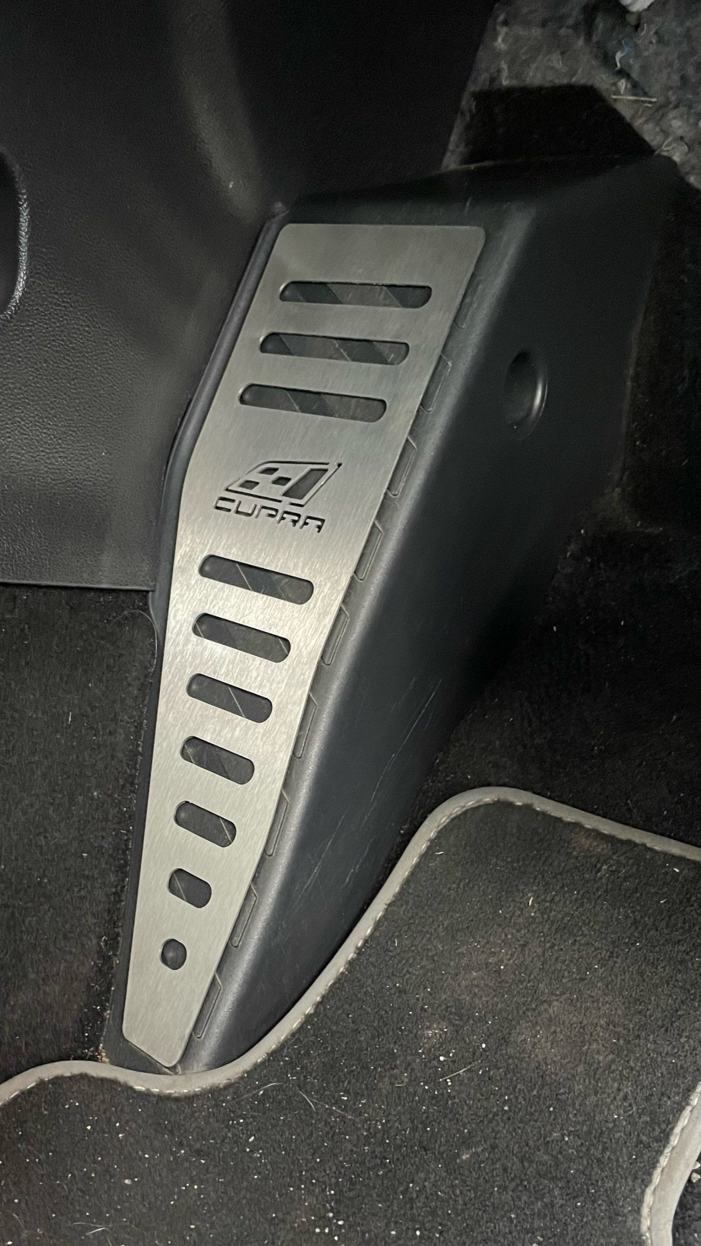

  • Leon Cupra footrest
  • Stage 1 ECU remap from Quantum
  • Powerflex bushes
  • Powerflex dogbone mount insert

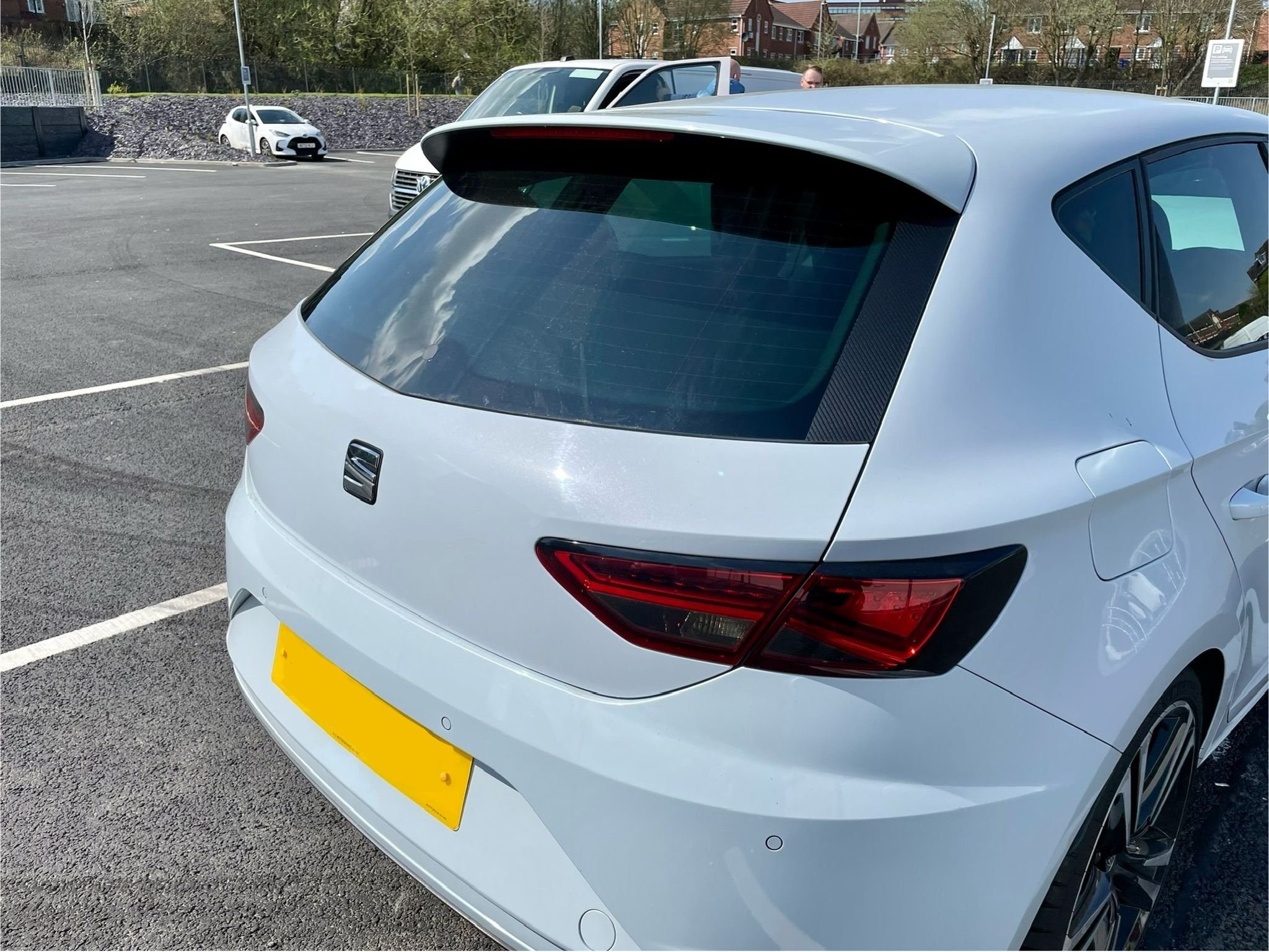

  • Removed rear window side spoilers
  • Rear light stealth overlays (EZM)
  • Airbag sticker deletes (EZM)
  • APR air intake filter
  • Ramair intake hose
  • Ramair turbo inlet elbow
  • Rear number plate panel painted body colour
  • Boot soundproofed

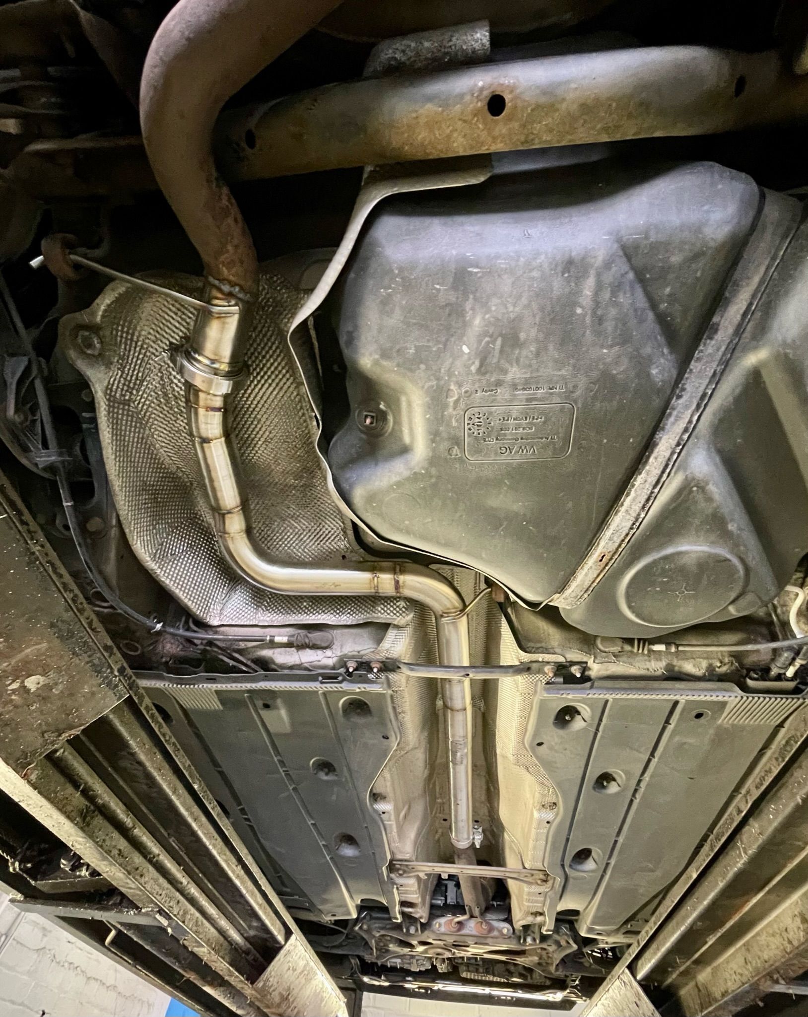

  • Double res delete (backbox still present)
  • 19 inch stock alloys swapped for 18 inch VW Cadiz alloys on 225/40R18
  • Front Seat and Cupra badges painted
That’s it at the moment. I’ll keep updating this thread as things go on!

Nice 280, love what you've done with colour coding the rear, certainly very different! Makes the colour of rear lights really pop. 😊

That’s a very tidy looking car - love it! I actually REALLY like the rear plate area being body coloured… I’m definitely going to get that done on mine now having seen yours, the off-black matte plastic has always looked janky to me.

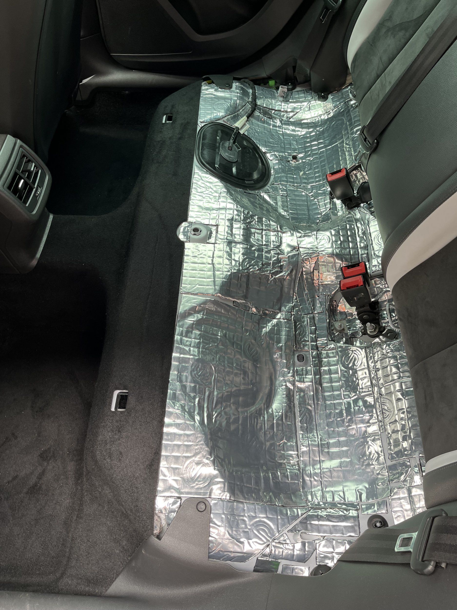

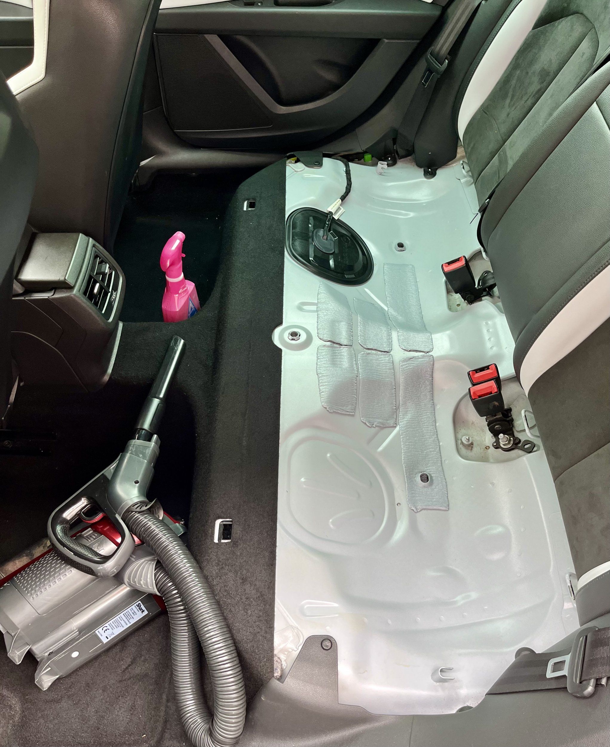

Soundproofed the rear bench too. Boot was already done. Difficult parts were the spaces around the seat belt clips. Thought about leaving those at first, then decided do em anyway seen as the bench was off.

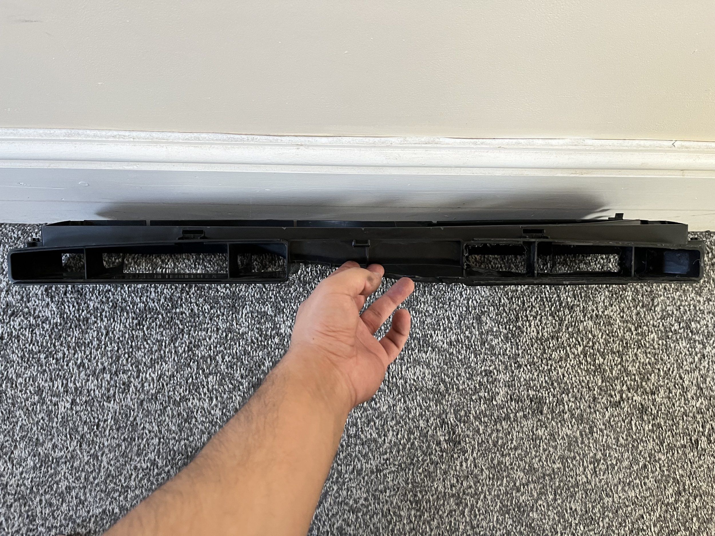

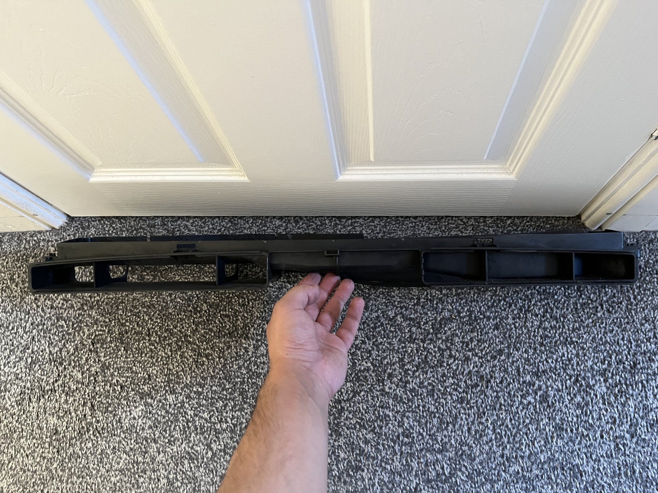

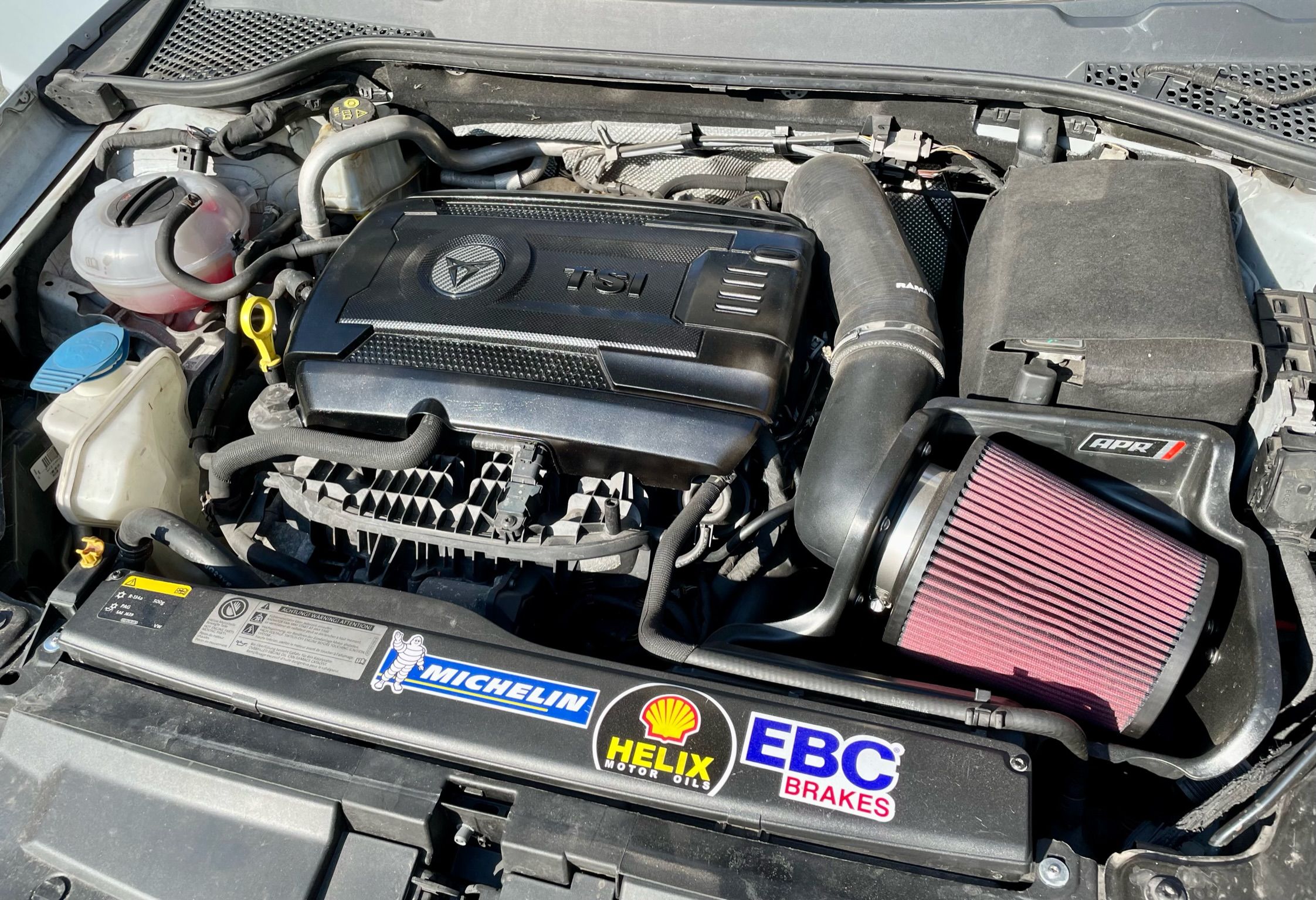

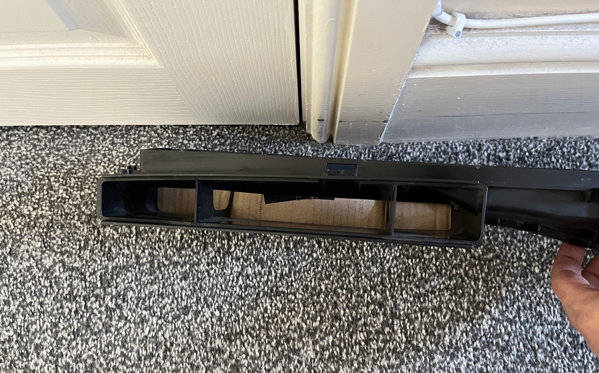

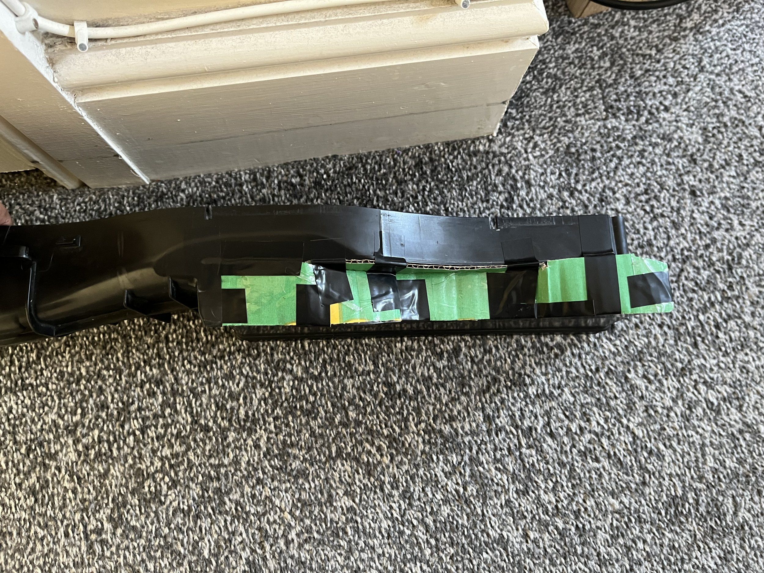

Gutted out the side the air filter (as best I could with a drill), and blocked off the engine side. Hopefully it holds. I know there’s an OEM part (MQB rear blanking plate - 5Q0129849), but thought I’d have a go myself.

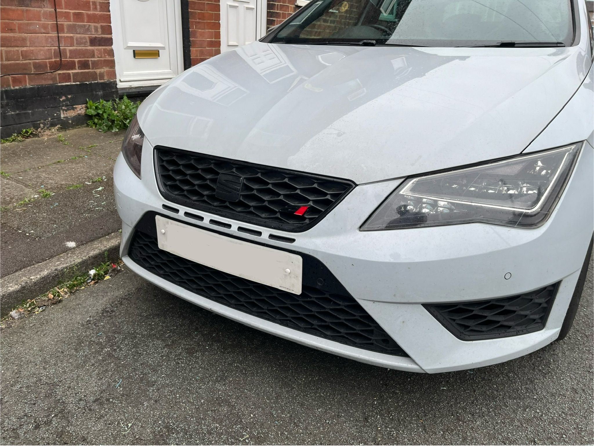

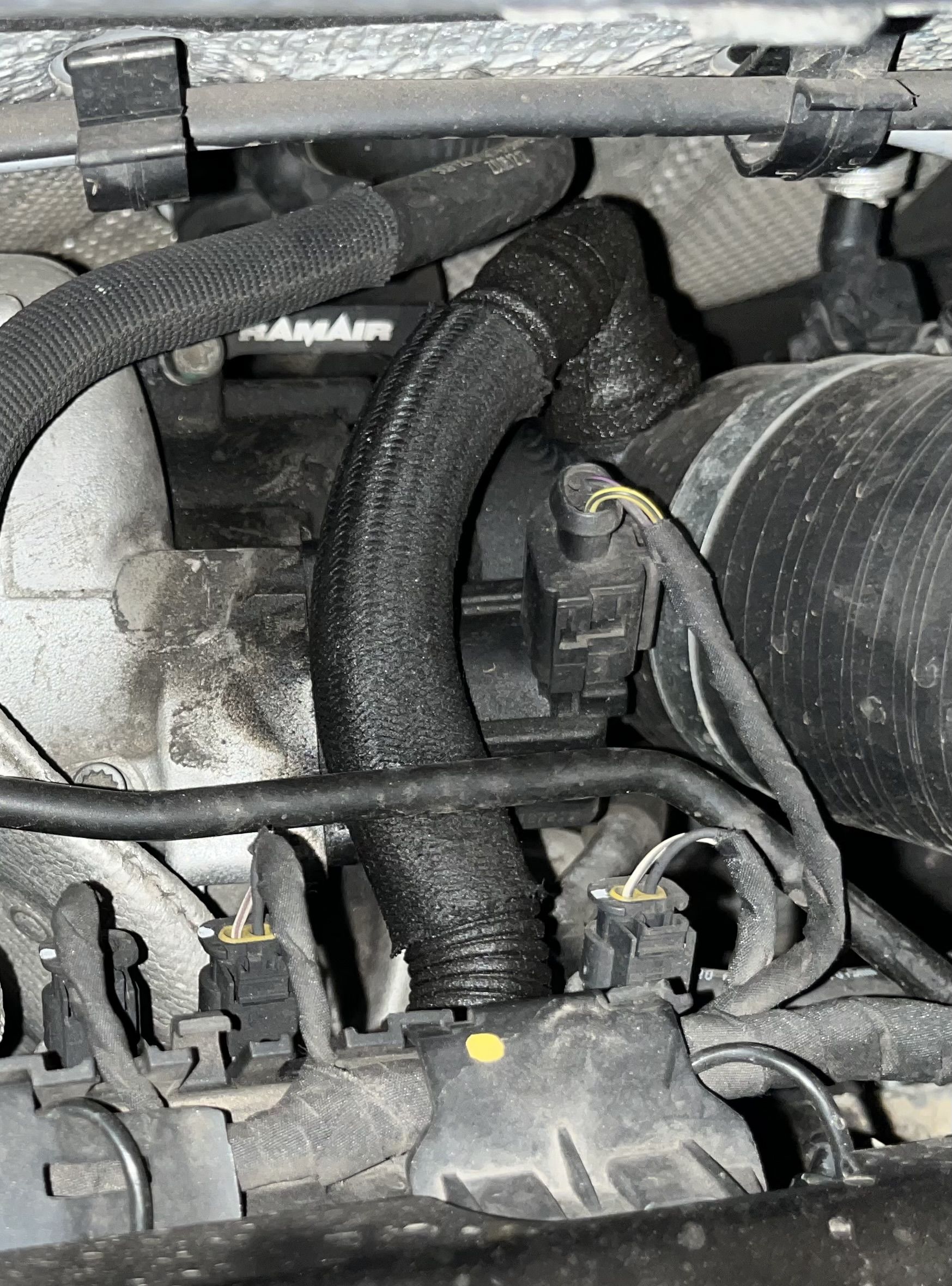

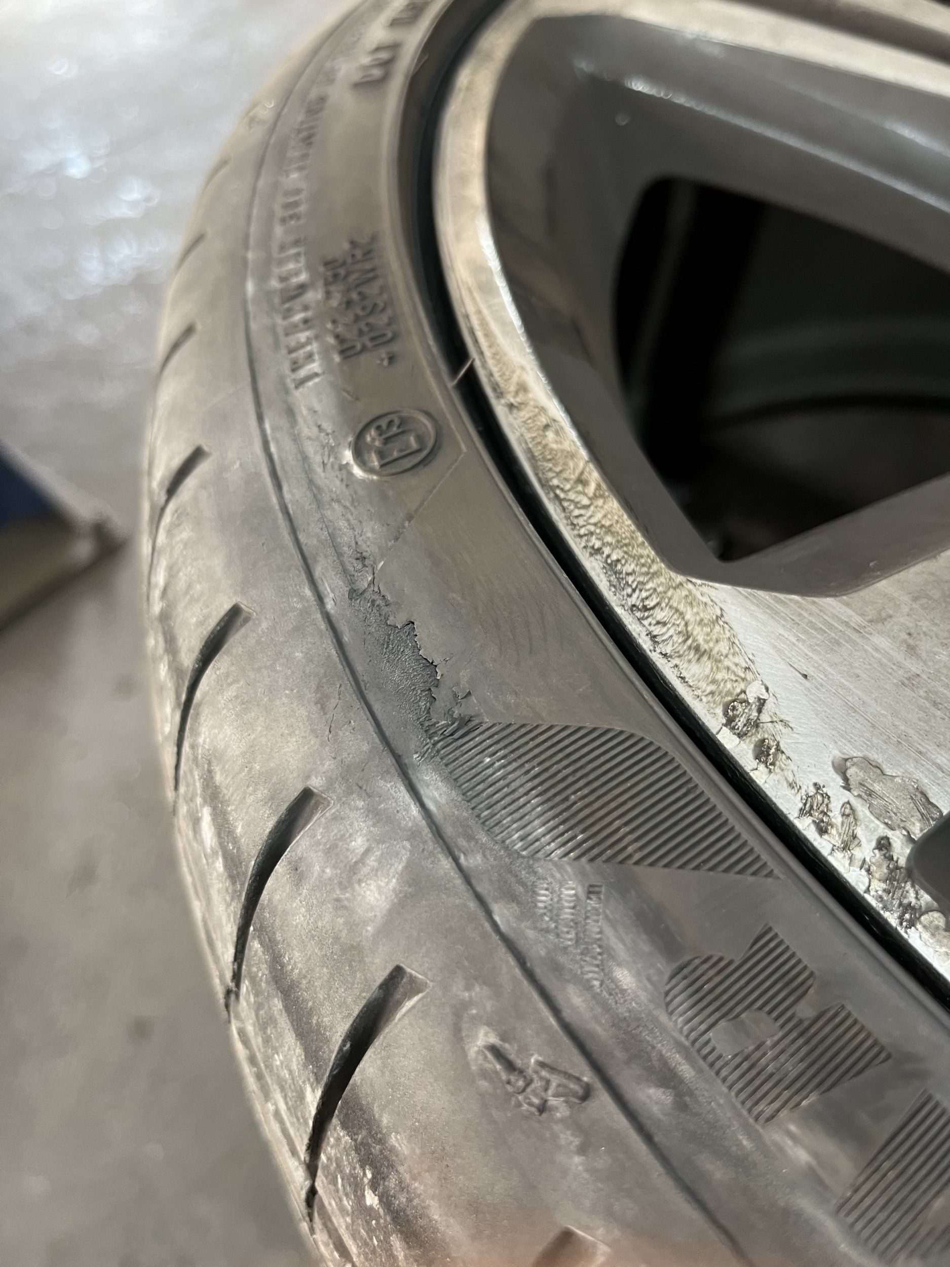

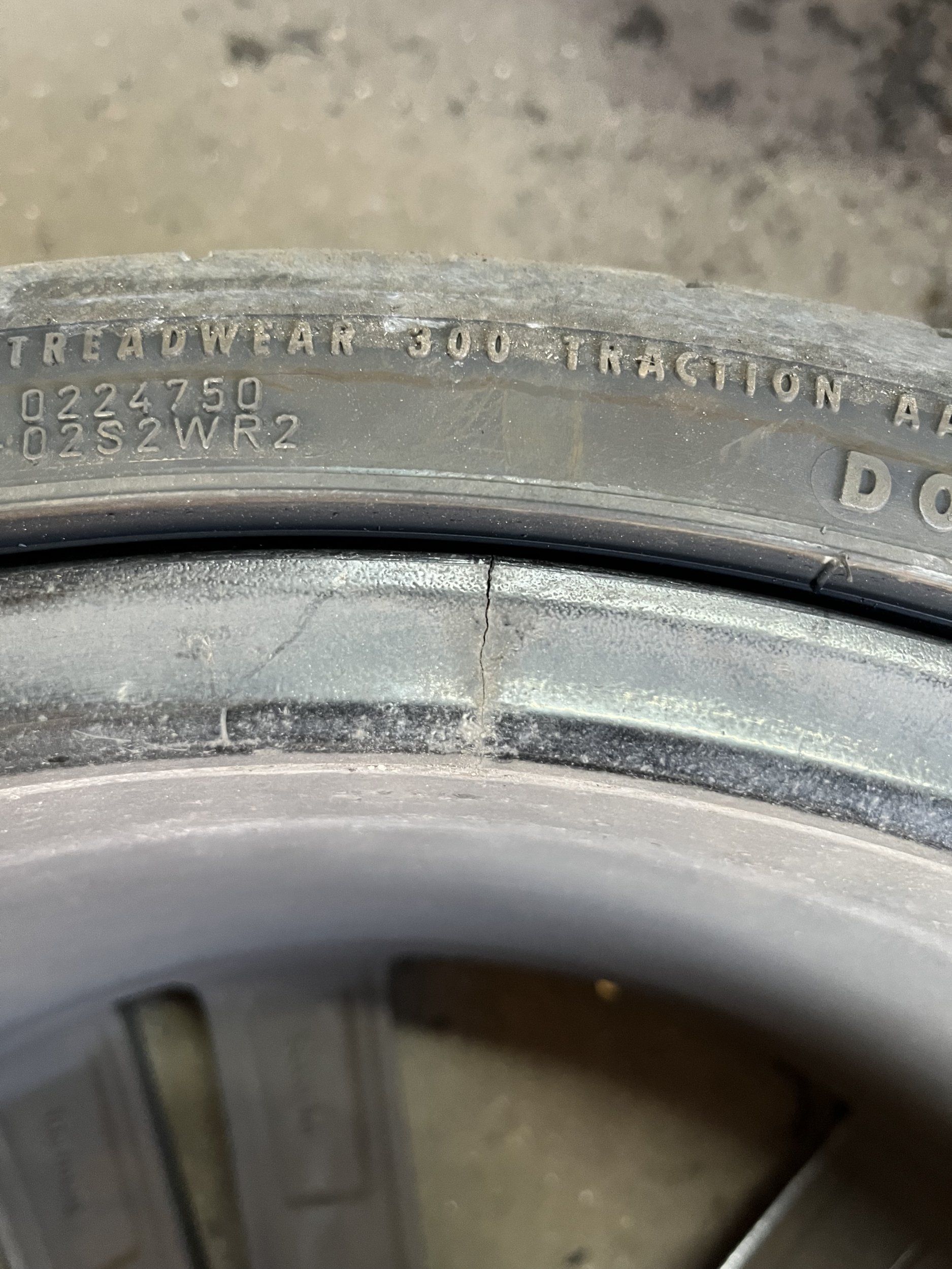

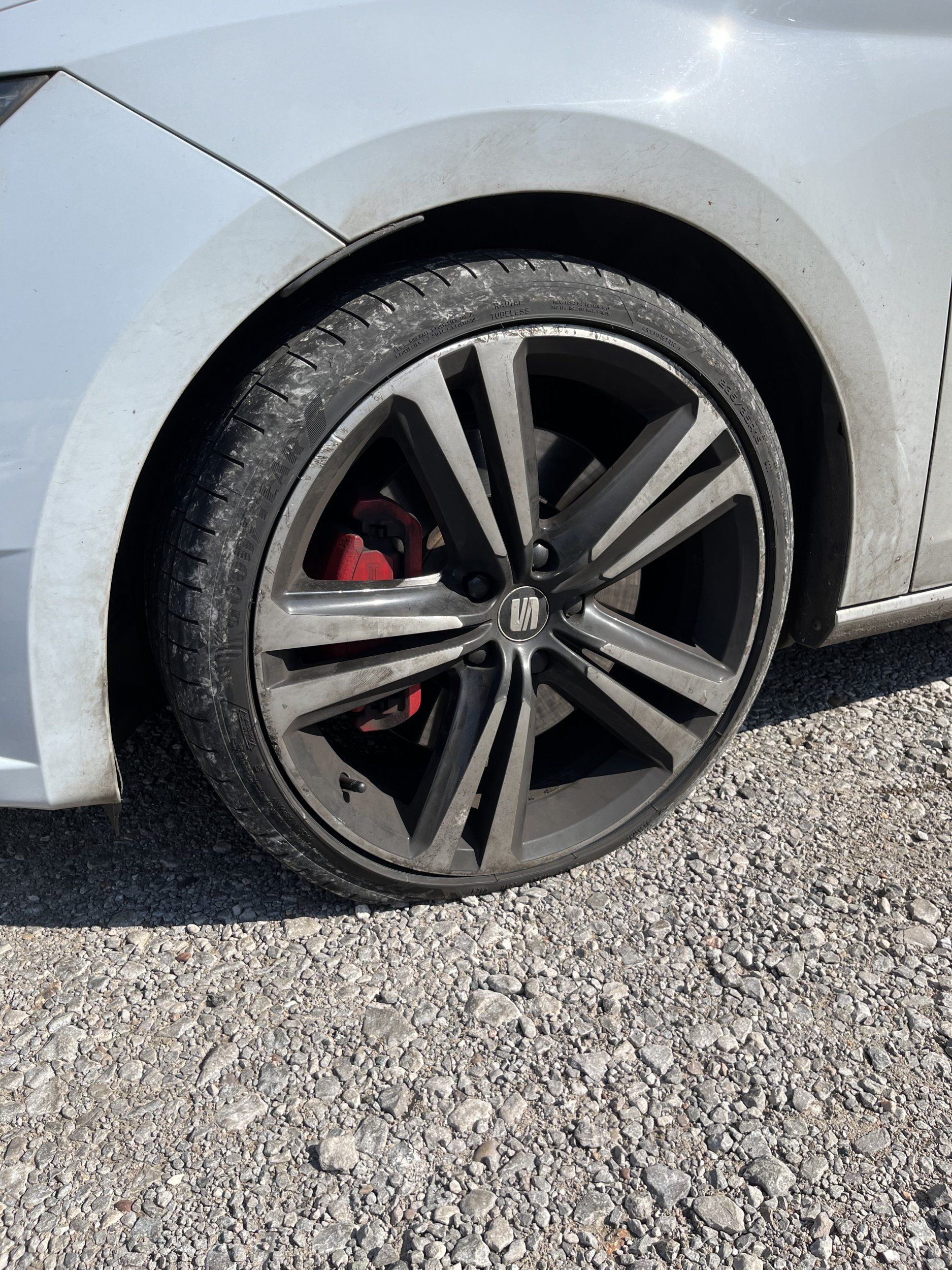

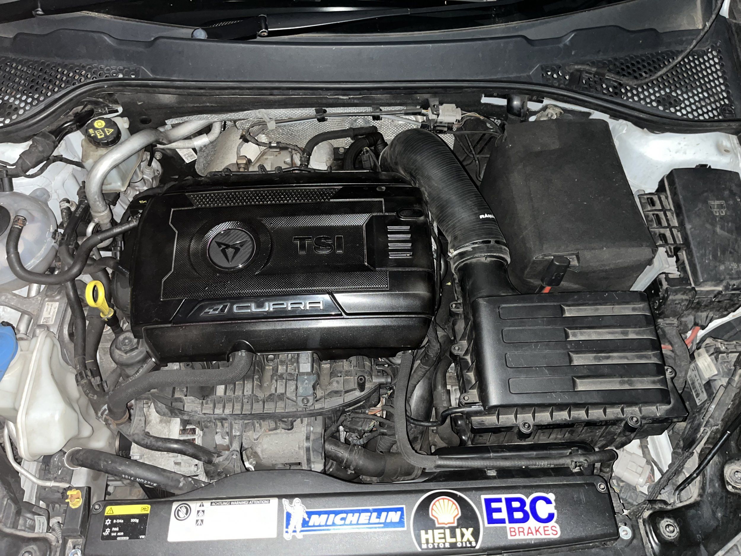

Changed the front Cupra badge to red and black, Audi RS style. Had 2 new shocks on the front as a fault appeared with drivers side, but turned out to be just a corroded DCC connector. Swapped the APR cone intake for the stock box and filter (Mann filter), but kept the Ramair hose and Ramair turbo elbow. Also saw some oil on the outside of the PCV breather hose, so will investigate later. Hit a huge pothole too, which cracked the wheel and popped the tyre.
