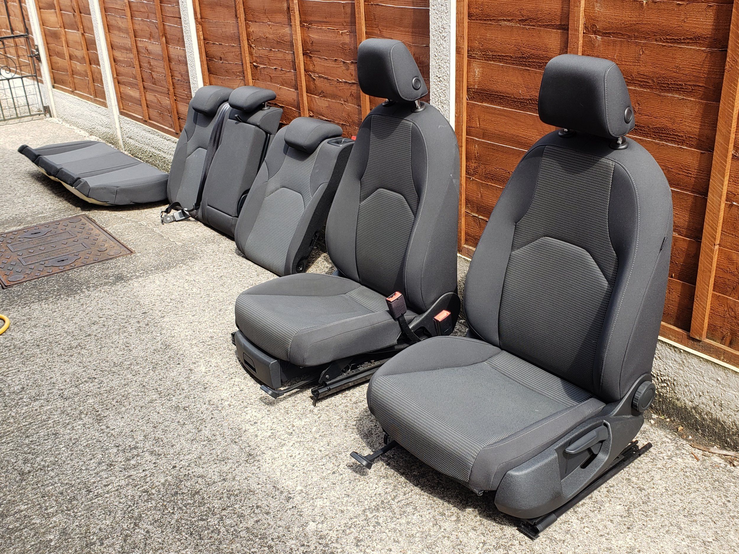

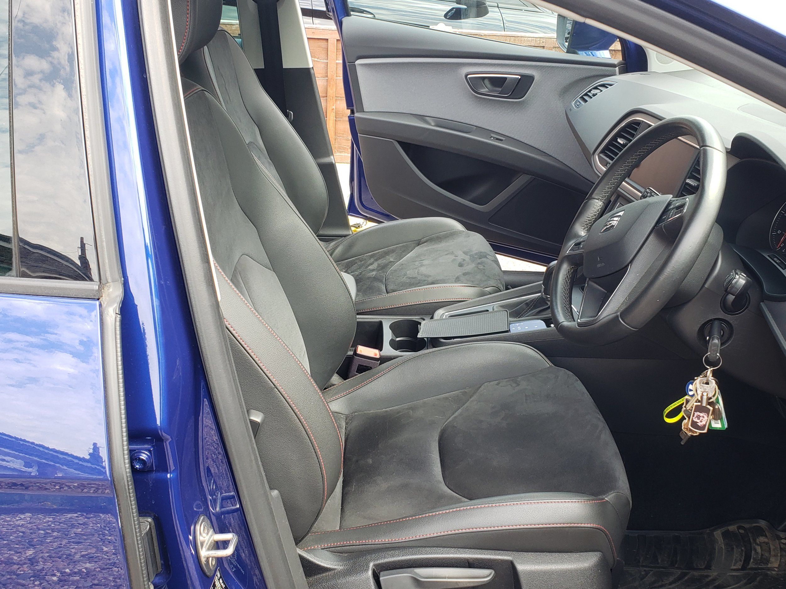

Absolutely yes. I've replaced both front and rear seats in my ST with half leather/half alcantara from a hatch, they swap between them no issue. Only thing going to ST seats is that you'll have a little black panel on the side of the seats against the wheel arch which hides the latch, which has an extra cable in there to operate the backrest releases on the boot side panels. This has no effect whatsoever on the fitting or use of the seats

They are a direct fit, but are missing the side panel which has the latch for the remote folding via the boot levers. So you'll to fold them down from the lever on the backrest as you would in a hatch. I'm running Mk8 golf hatch rear bench in my ST.

You've just quoted my post, and asked the very question answered in full in that post......yes the hatch seats fit the ST no issue, except the little side panels used for the seat back releases in the boot space on the ST are not fitted to the hatch seats (since writing the quoted post I have swapped over the latches so those boot mounted latches are now working)
