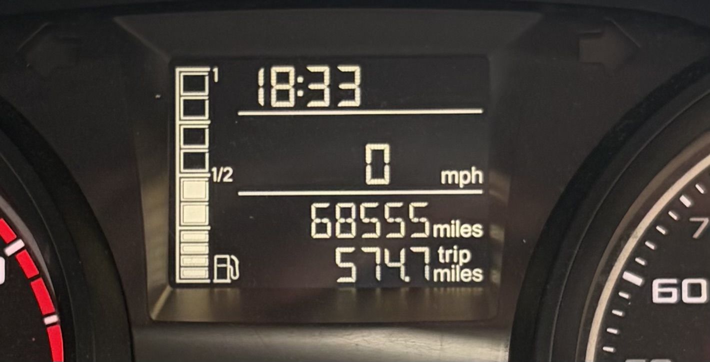

owen123
Jun 11, 2019
To clarify this is how it looks after the change, as far as I know there is no way to make it small like the KMH readout.
