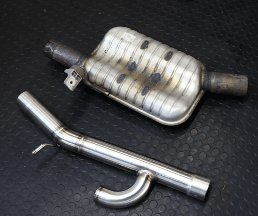

So, effectively getting the GPF exhaust will be like having a res delete, which for me it droned awfully, (I swapped it back). If the internals are even less restrictive it may drone even more, just factor in you may want a resonator adding back.
It wasn't until I got an anti drone res delete that I could live it on my carbon edition...
For reference it looked like this...

I'd say if the price is right, then go for it. Absolute worst case scenario is you need a resonator added (or the extra tube like on my anti drone res delete.)
