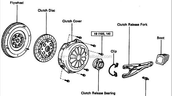

Sounds like clutch release bearing.
Try double clutching. So 1st gear clutch down into neutral. Bring clutch back up and then down again into 2nd gear. See if it works like that. I would suspect release bearing if so

I'd also say that the link between the clutch pedal and the clutch release bearing is compromised. Maybe the fork engaging the bearing, or the clip fixing the fork?
