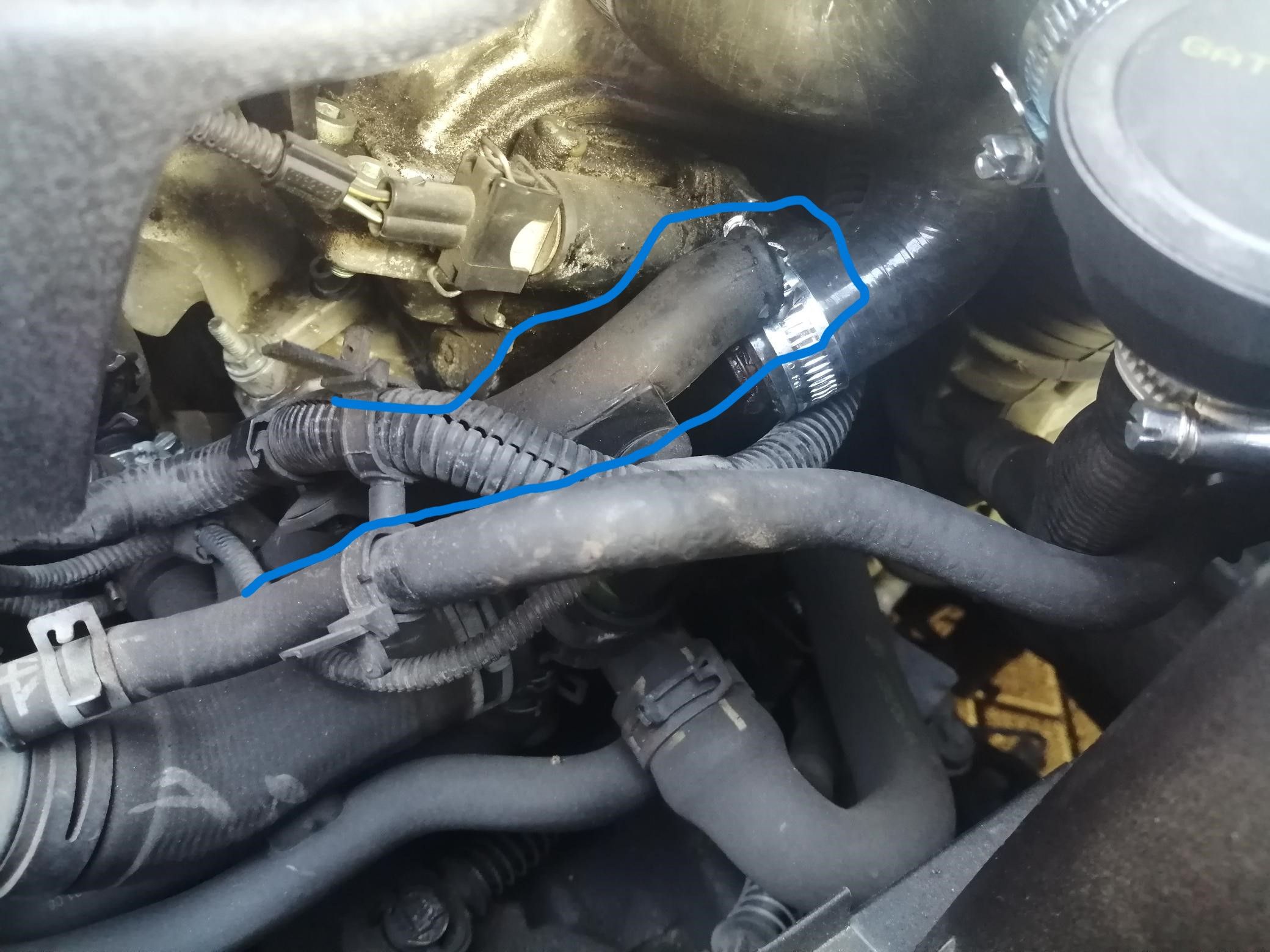

i decided to attempt the sensor, wasn’t where I thought it was and was a bit of a pig to get to without moving a lot of pipe work and the oil filter. I managed to replace it though without disturbing too many bits.
The ECP light has gone out and the car started first time. Fingers crossed all fixed.
