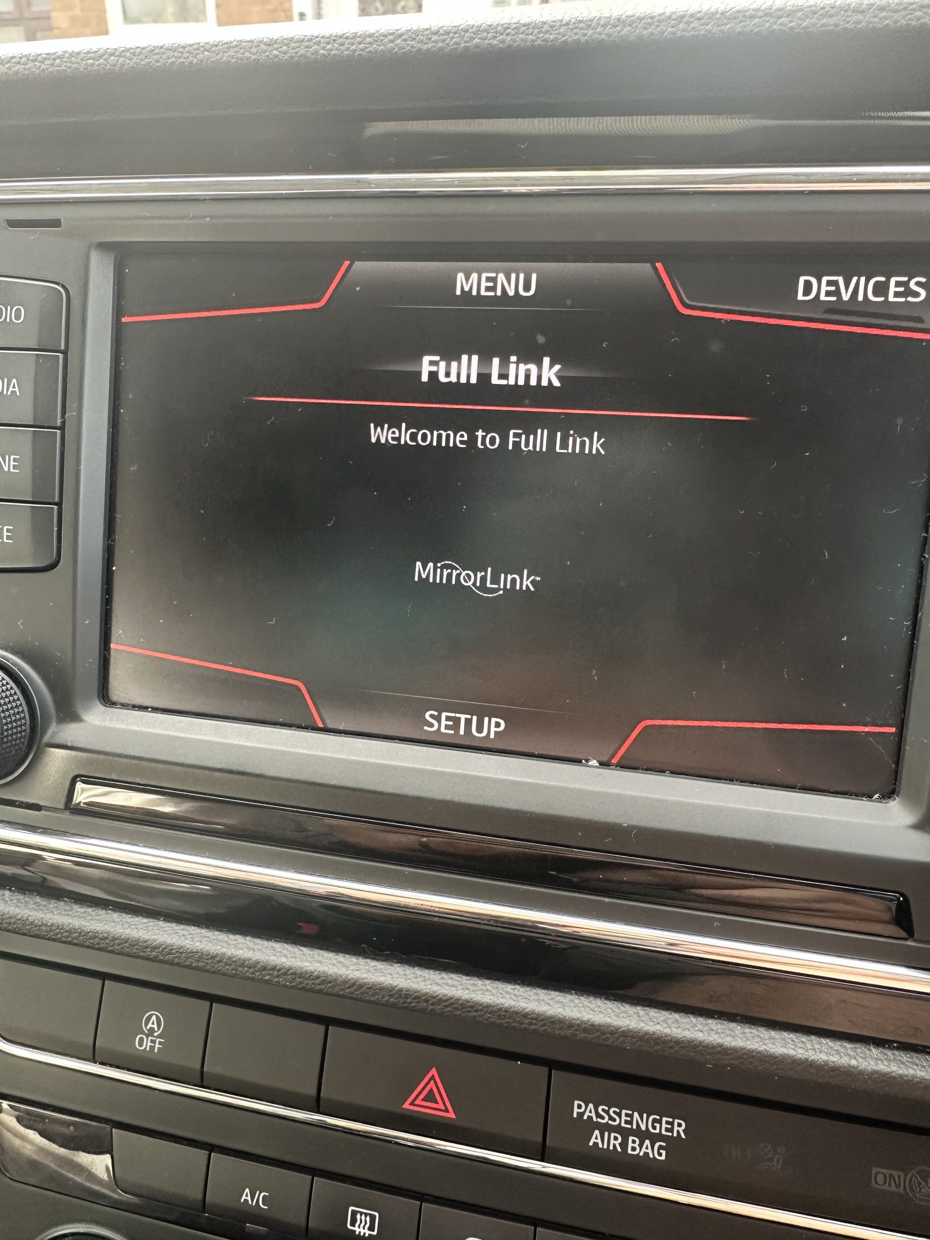

Ive changed the usb port in car to support apple car play and I have also unlocked Full Link via MB2 toolbox. I launch Full link and it only gives me Mirror link option.
What am i doing wrong ?

Incorrect coding
You'll need to enable android auto & apple carplay, and code to suit the new usb port
