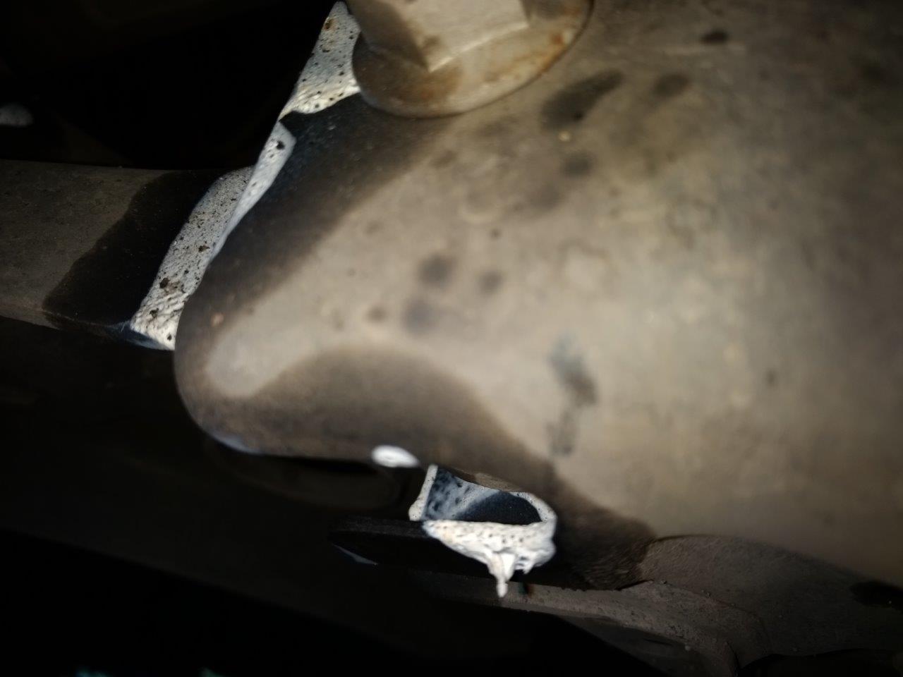

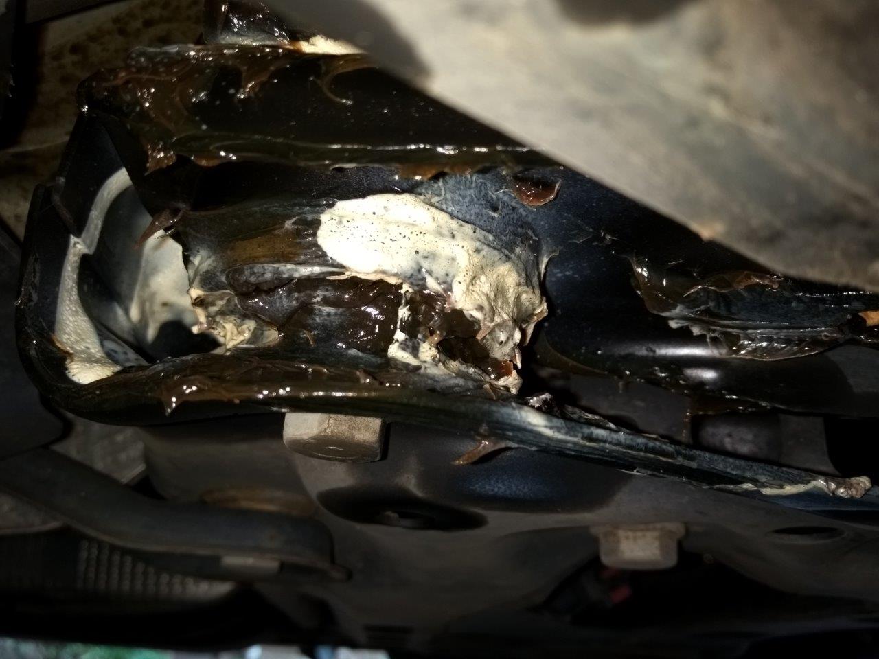

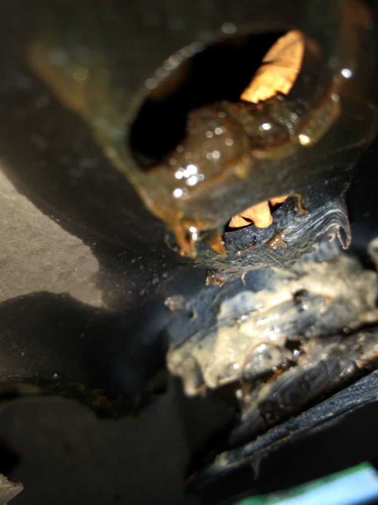

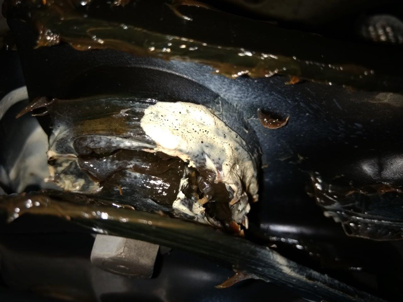

Here are the photos I took of the grease points. Hope you can work them out. I found that the problem was solved but only temporarily. I am currently working on the theory that it's actually the handbrake adjusters in the rear wheels which creak and groan when going over bumps. Try applying the handbrake in motion on first hearing it and I think it goes. I am one of those with an autobox and so rarely apply the brake from bitter experience with seized handbrakes. Probably irrational nowadays.
