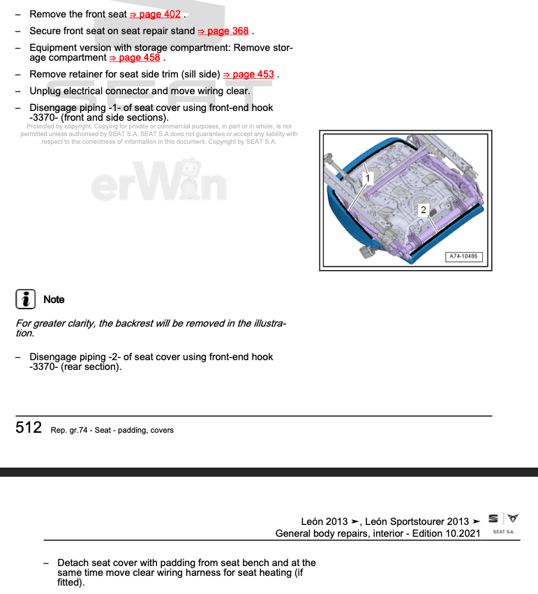

Hello, unfortunately a cat has urinated on on the front seat in my partners car, I was thinking of ways to sort it out and one of my ideas is to replace the cushion, is there any guides available to remove the seat/cushion that anyone is aware of?
I’ve found a thread but it’s a mk 2 I believe.
any help appreciated, thanks.
grabania
Aug 14, 2022
129
153
Gdansk, Poland
grabania.pl

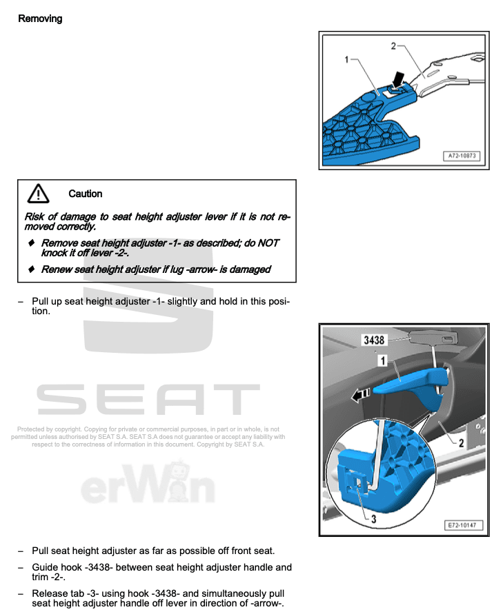

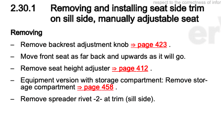

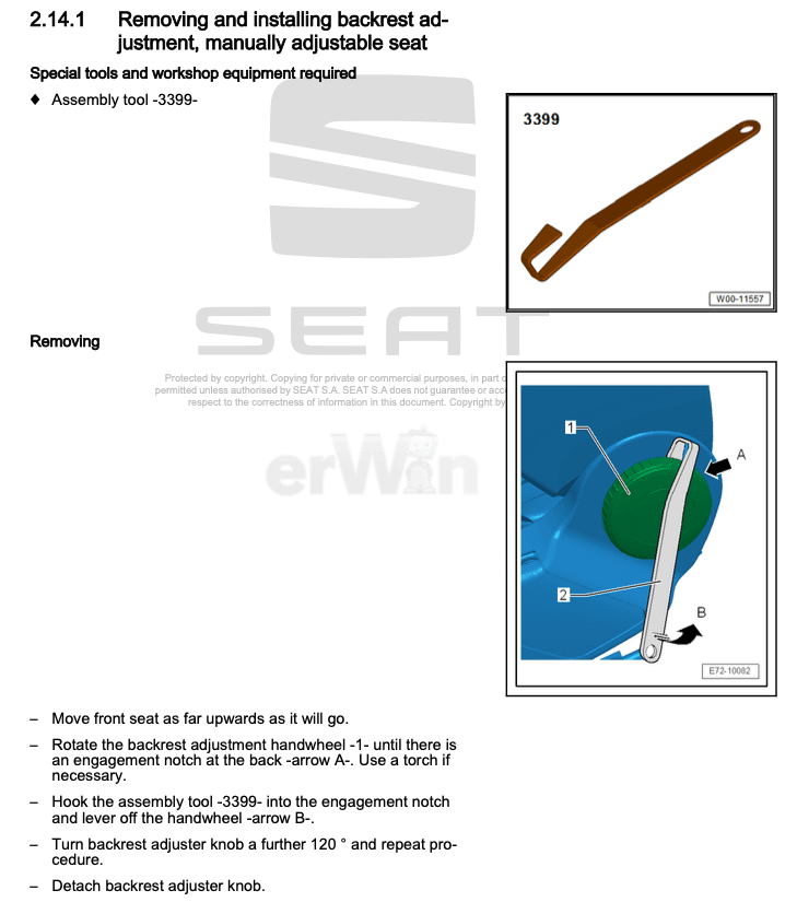

I would love to share full instruction with you but it was removed from Google Drive for some reason, don't know why. I've got local copy on my computer so here are few images that should help you.
