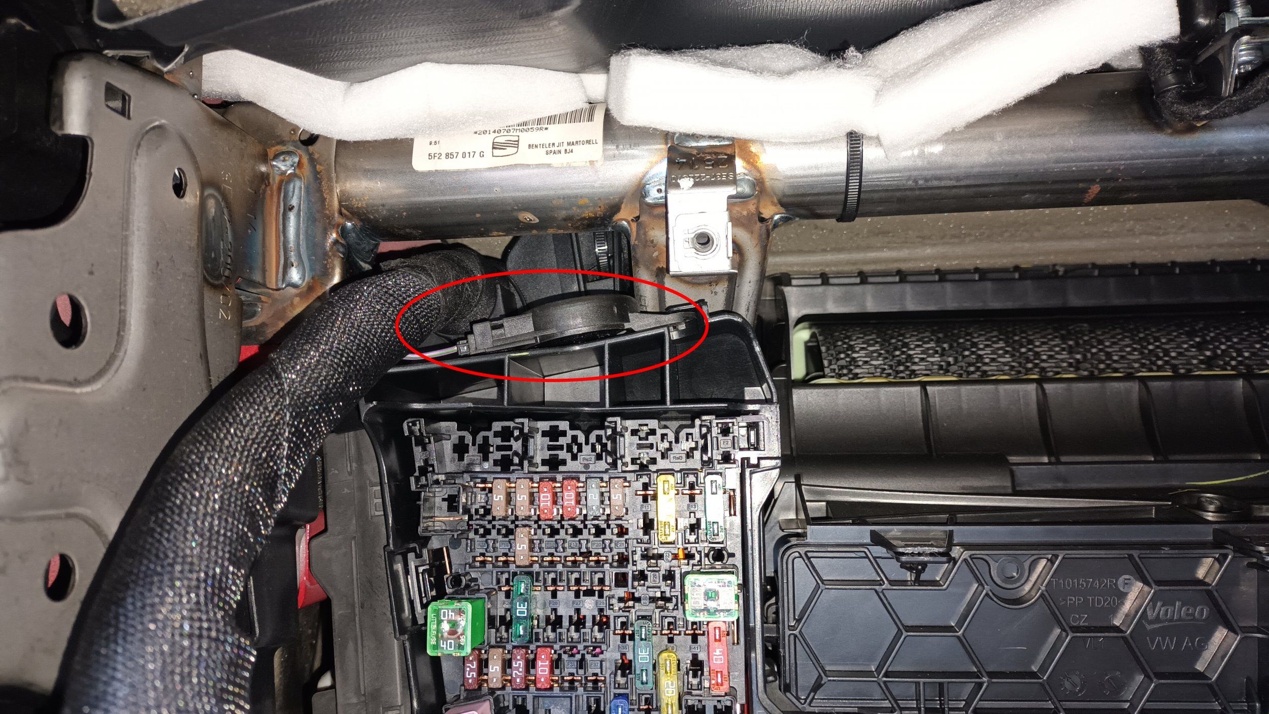

After my Park Front park assist showed a fault on my 2014 Leon Ecomotive, and Running a diagnostic it showed that the front sounder was faulty.
After reviewing the Seat Tec Data to the location of the sensor I found that it was not located where they indicated ( Possibly as the data seems to be for Left hand Drives)
I eventually found it's location Behind the Glove box In the upper right Corner Above the fuse Box.
