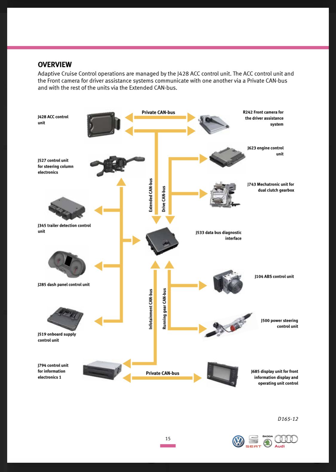

As per response above - this will need a diagnostic tool to assess:
The issue could be related to any number of equipments - some screen shots below are from the self-study guide for driver assist systems, showing sensors and controllers and how linked together - although for adaptive cruise control, the majority of these are present for the front assist function.

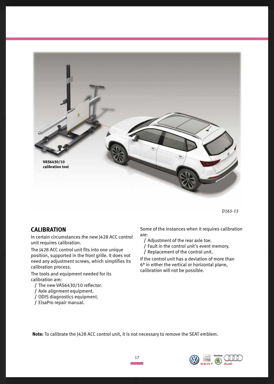

The second screen shot shows the rationale for sensor recalibration - ‘fault stored in controller memory’ being the most likely issue that you have - this can only be cleared using a diagnostic tool such as VCDS, and only if you are certain that the fault has been resolved.
There is a DIY sensor recalibration wiki here:
