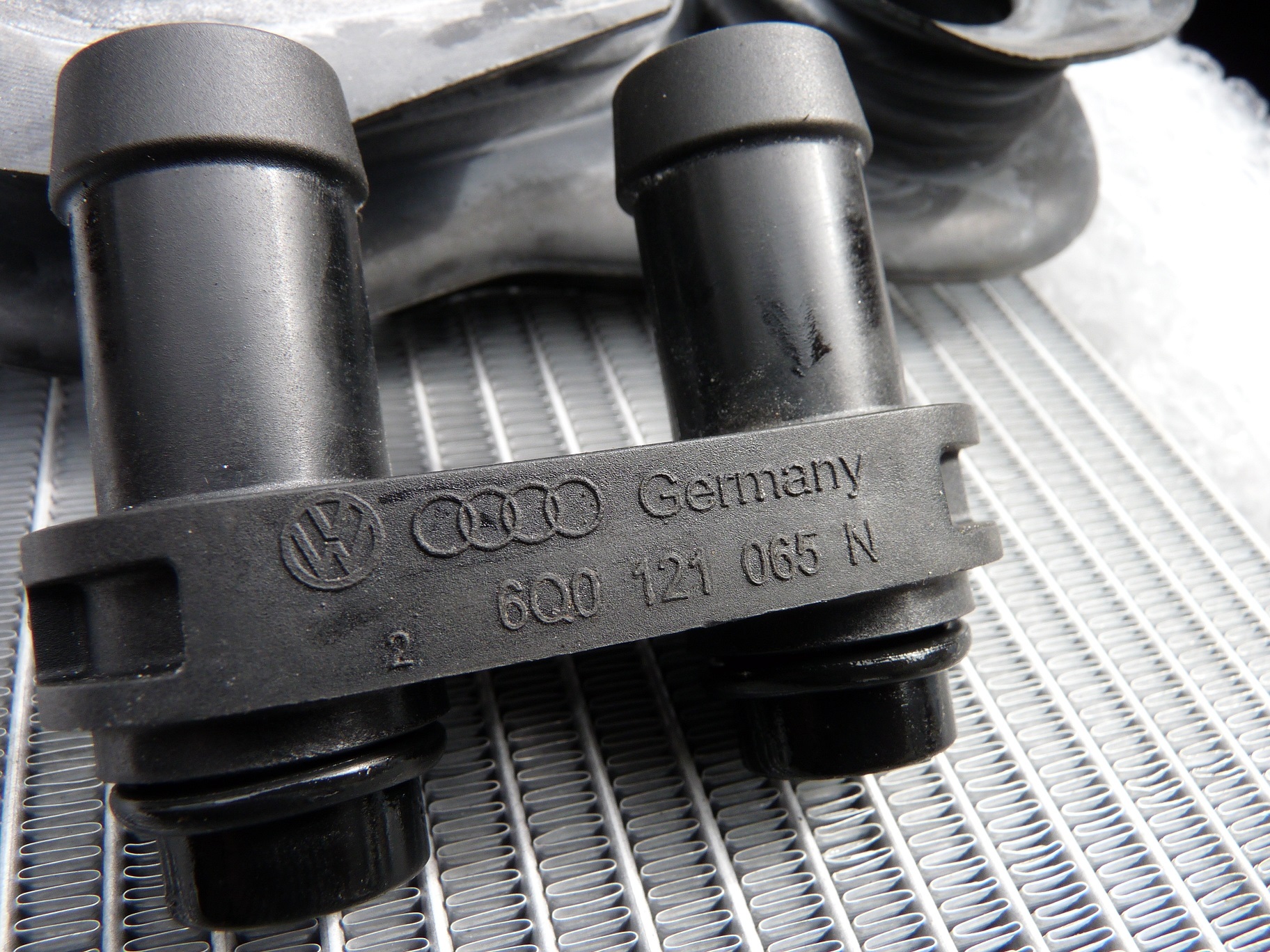

I know what you're thinking - new o rings should be the solution but for some infuriating reason it's difficult for the pipes to mate properly with the heater matrix. I had those pipes on and off half a dozen times and still no joy, coolant dripping steadily worse. I have a solution for you that requires getting rid of the metal pipes (you still require the new o rings).

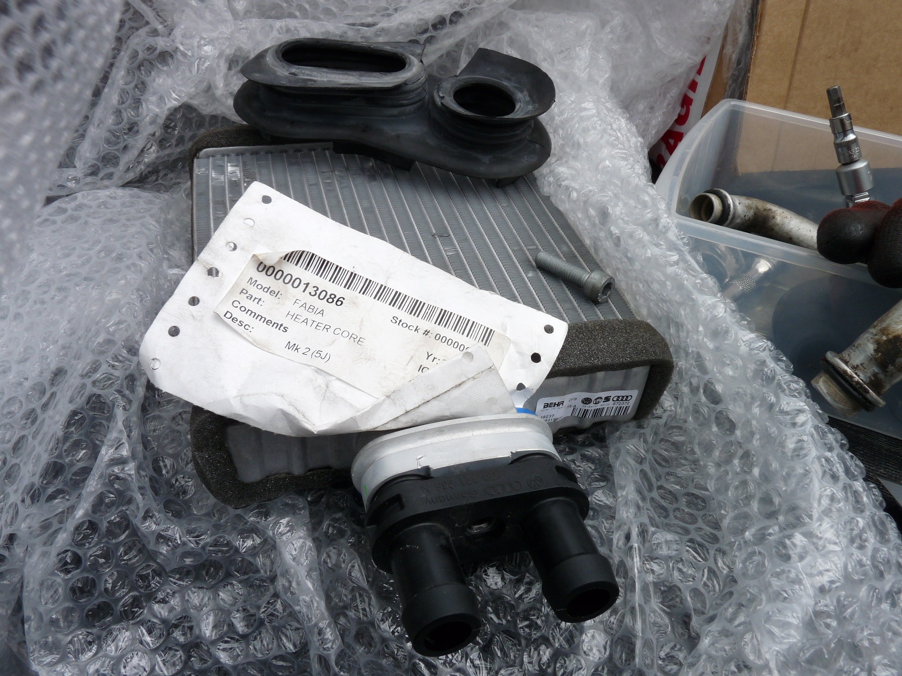

I found a heater matrix core on eBay. What I was looking for wasn't the matrix core itself but rather with 6Q0 121 065N. This now mates with the existing matrix core (use the new o rings). It's secured with a hex bolt - 7mm I think. I did this DIY about 18 months ago so it's not fresh in memory.

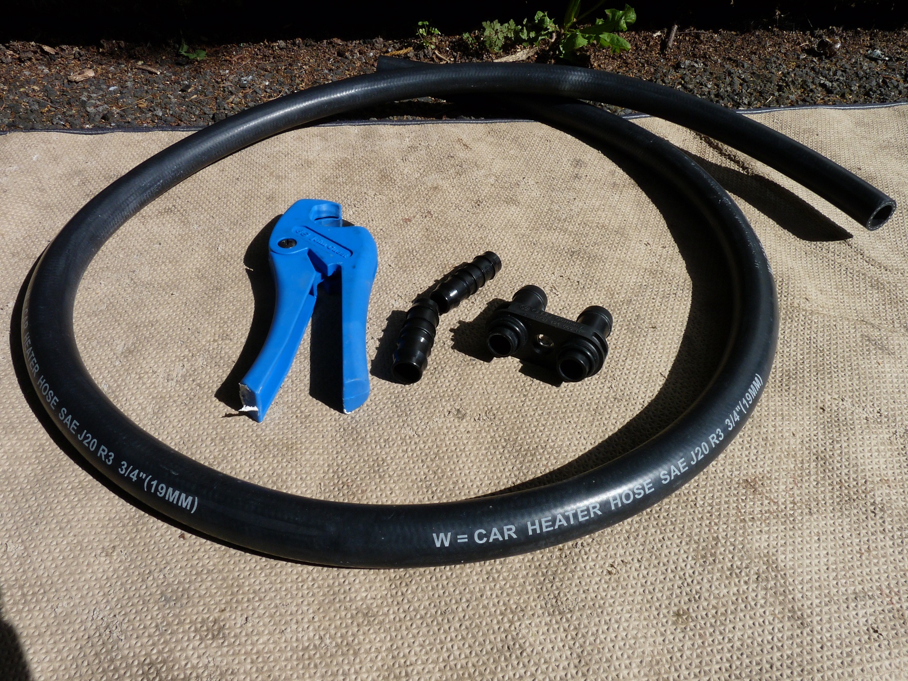

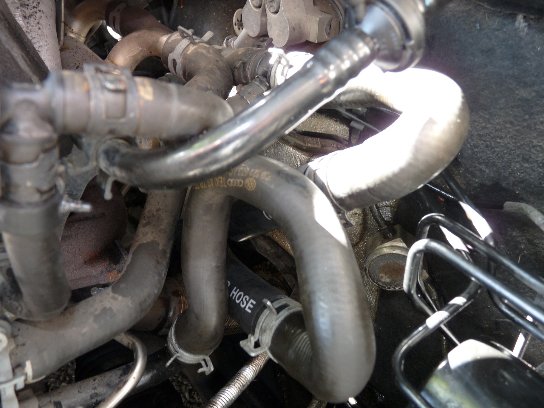

You will also need 19mm (3/4") heater hose (sorry, I don't have the exact length you will need but I spent £12 and had lots left over) and 19mm straight couplers (eBay). Include a couple of 19mm 90 deg fittings too. You will have to cut your existing hoses and use the couplers to mate up to the new heater hose.

Here's the photos from coolant leak fixing fiasco:
