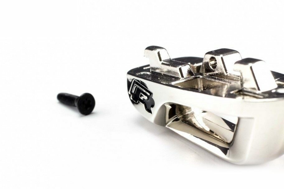

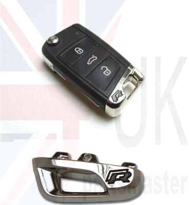

They do different versions - plain chrome, GTi, GTD, R
I've fitted a few to previous VWs (pull back off fob then use a torx driver to remove screw the slide piece out and fit new) - the last VW i had was a 2019 T-Cross and the chrome was slightly different fitment so i had to use a dremmel to "modify" it to fit - weird?

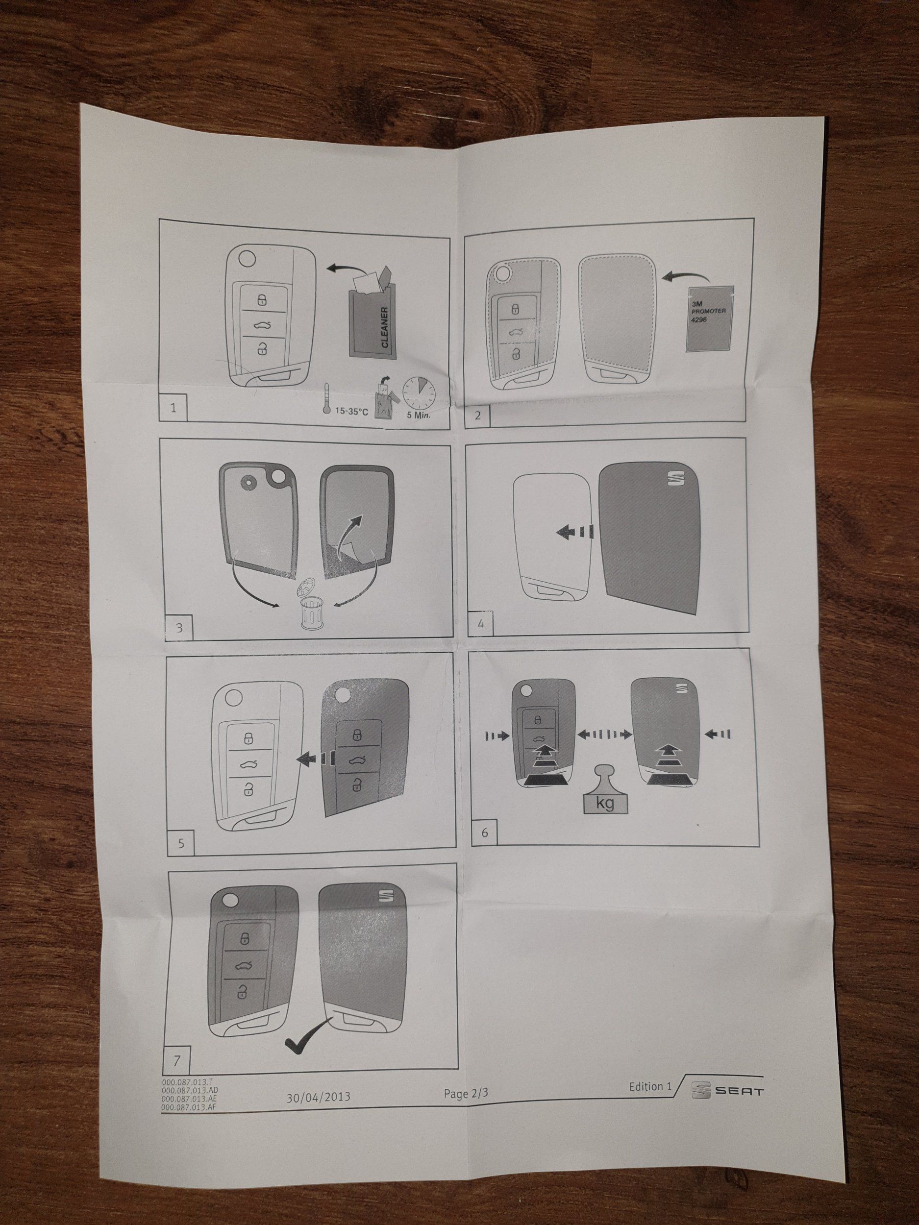

Not too bad the price. As it come with a alcohol wipe, 3m adhesive promoter wipe which makes the key tacky. Then you peel off film from the 3m pads and apply each section. I suppose a cheap version would be £5+. But might not fit right, lose its adhesive properties and design wear off fast.
Only time would tell if the genuine part lasts long.

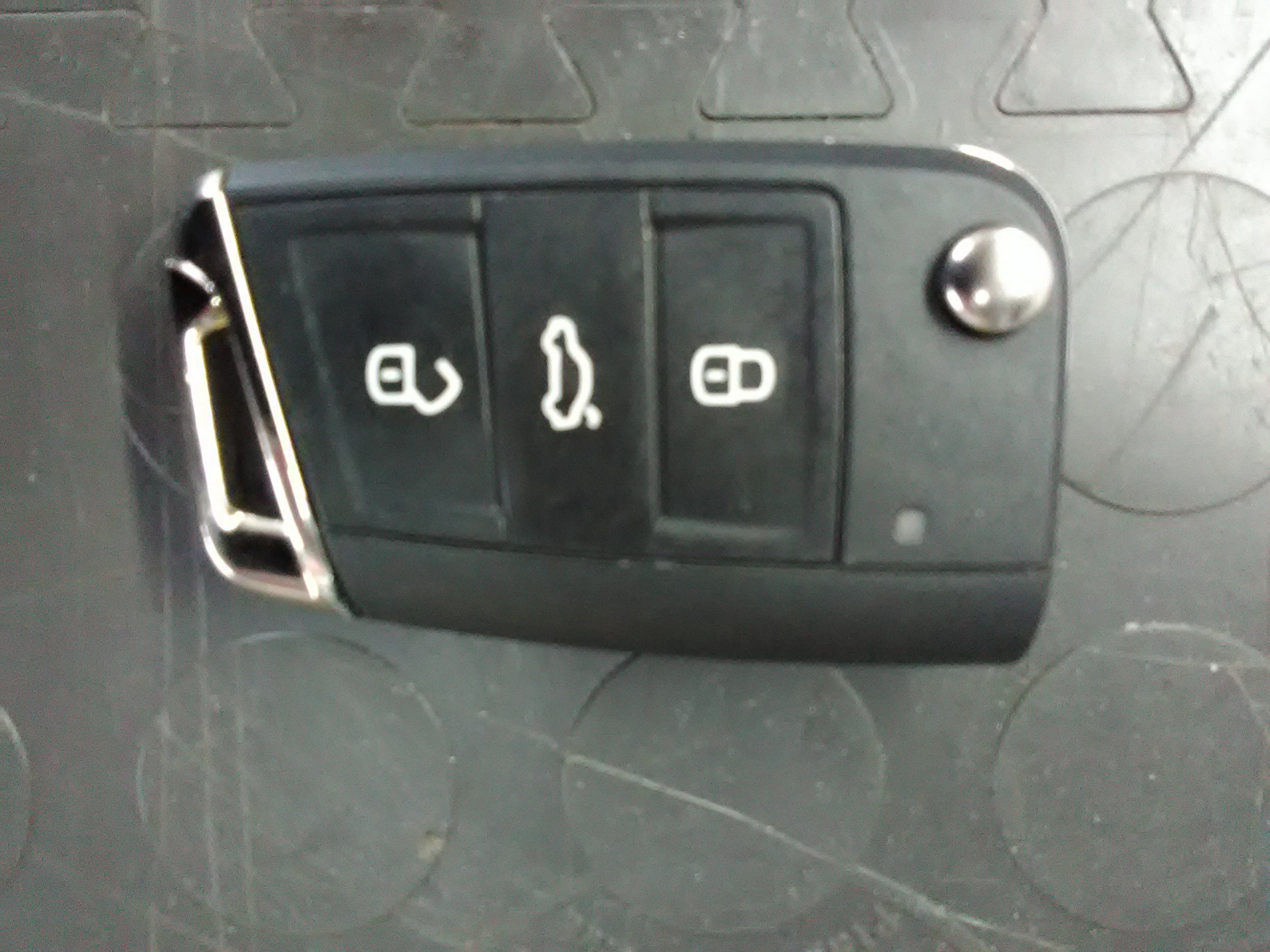

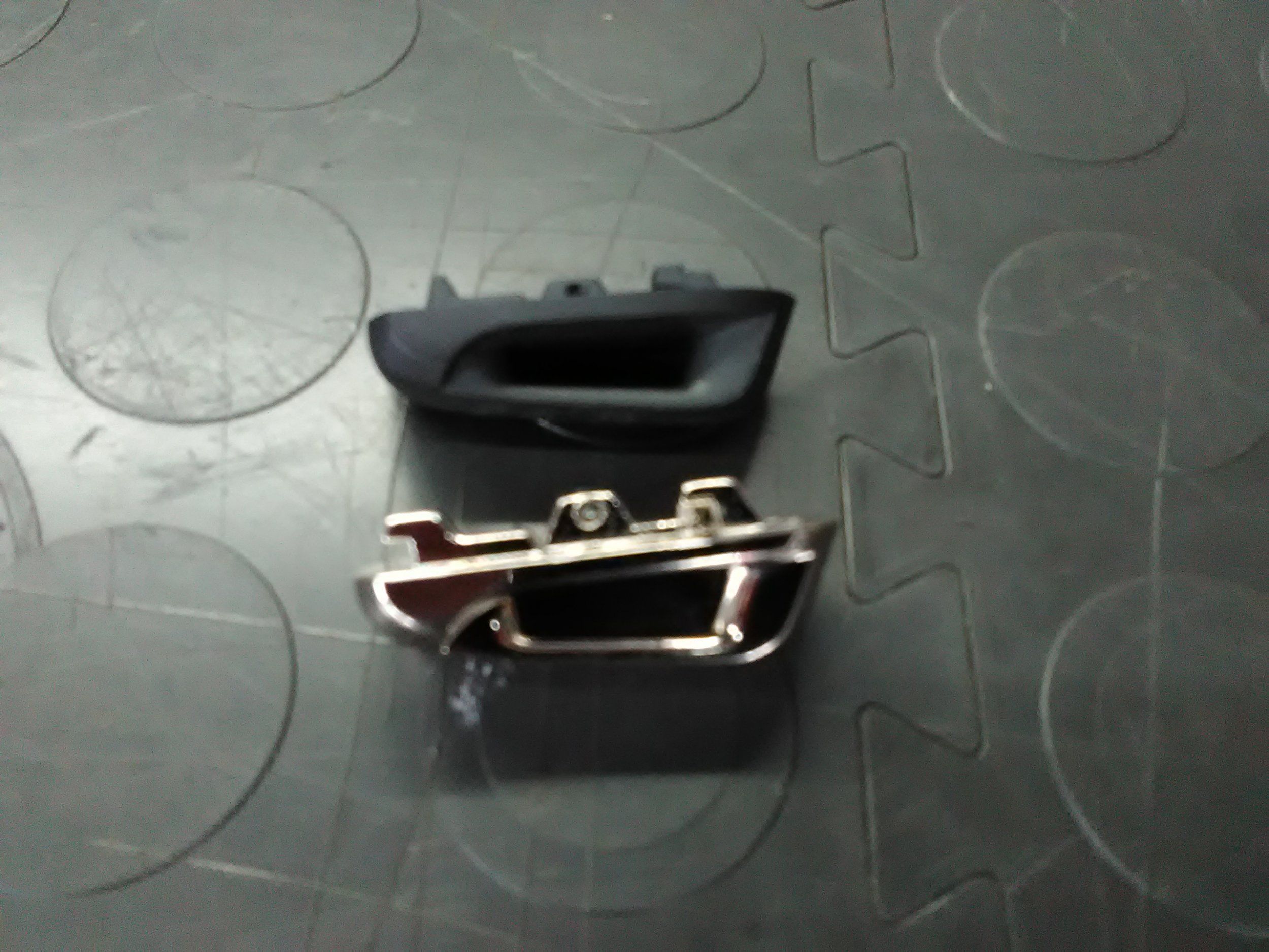

My chrome piece arrived today - same problem as i had with the T-Cross - it doesn't fit without modifying.
When you try to slot it in place it wont slide far enough so a bit needs cutting off (i used a dremmel) - you'll see which part but i've attached a pic showing the part - hope this helps :)
New Vs old

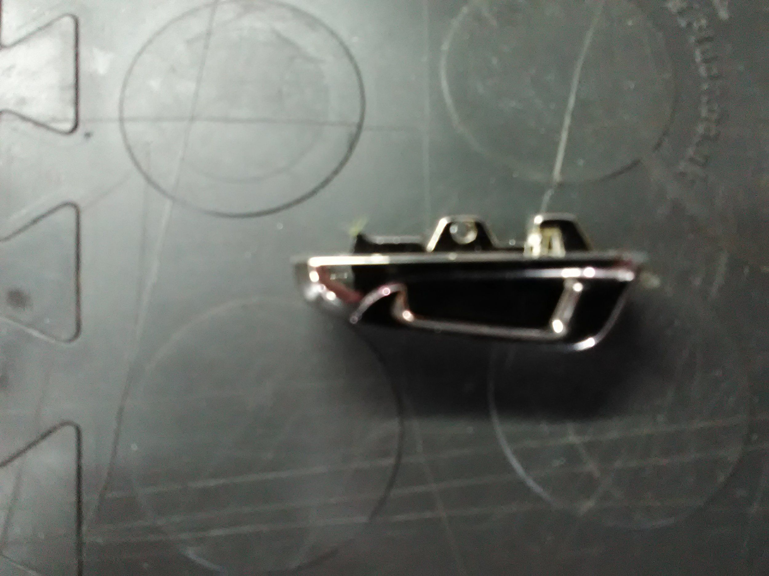

Yellow section needs removing
You're left with this
It now fits :)
