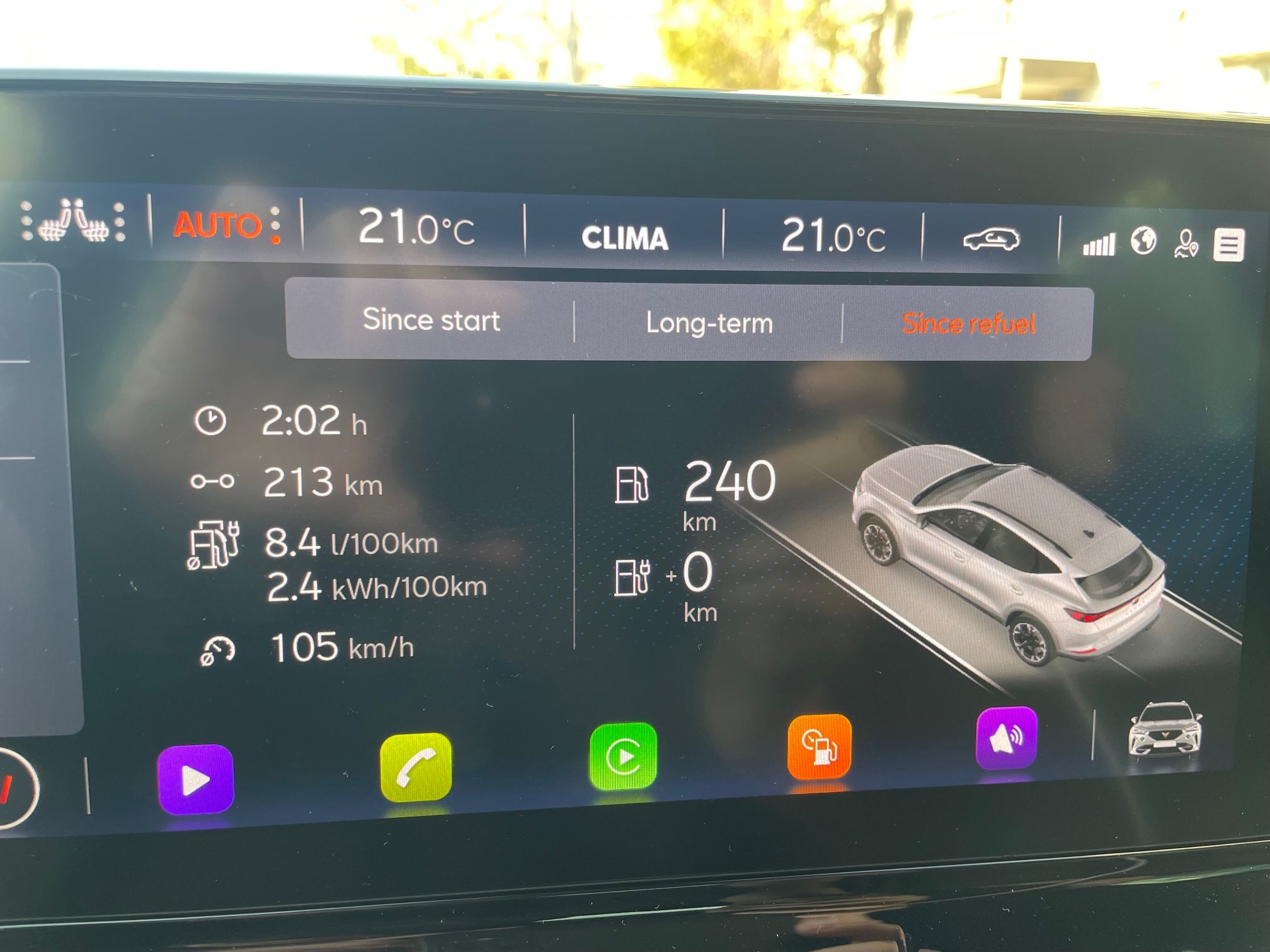

Took a trip:
- 10 degrees Celsius, temp set on Auto, intensity 1 at 21 Celsius. heated steering wheel and heated seats OFF
- No cargo
- Eco mode, hybrid setting, Adaptive Cruise Control with just lane assist but not automatic pilot.
- Fueled up to full and jumped directly on a highway for 213 Km with an average speed of 105 Km/h
- Battery was at around 65% when I fueled up
Arrived with 2% battery and a 8.4 l/100km consumption
Screenshot attached

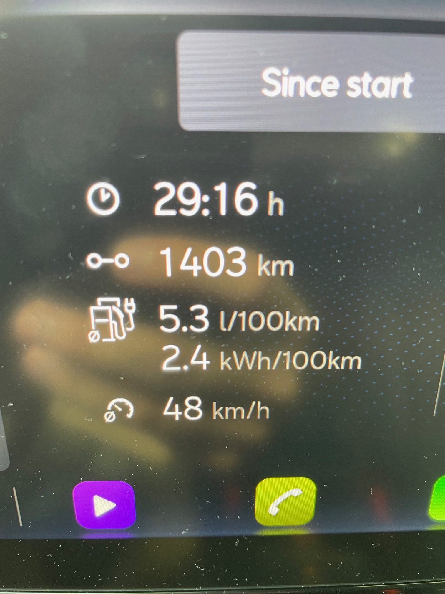

My best fuel consumption was on a 2600km trip. I expected it to be way worse. See the image for details.
Yea, but still the battery did not reach empty until the destination so there was no sense for the engine to charge it.
I had a similar one as you and I didn't even have power in the battery for most of the time since I had to place to charge and the average speed was way low. So I don't know what happened. maybe a faulty update that doesn't manage the battery well?

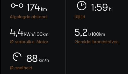

Below the consumption of fuel and battery of my Formentor on last Thursday.
Climate control was set to 21 degrees and the steering wheel and driver's seat were heated for the entire ride.
The outside temperature was between 0 and 4 degrees. 90 percent was highway and the rest 80km/h roads.
When I drive in the city limits, it is on electric (default after starting) and as soon as I go on the highway, I manually switch it to hybrid. And vice versa when I leave the highway again. Sometimes I leave it on hybrid when I have 80km/h roads. It depends on the remaining load of the battery. Battery charging is disabled while driving. I tried this once just to see how it works. I can charge the battery both at home and at the customers.

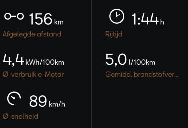

i had that in the summer. but now, I'm starting to believe there is something wrong with something.. idk..

I'm still getting around 40 km electric range in 0°C temperature, simply by not using climate control. Heated steering wheel and seats don't use a lot of electricity, so those can be kept on, no problem. But general heating uses around 10x more electricity than those 2.
If you're driving in hybrid mode, make sure to wait until the coolant is at 90°C before turning on heating, that will get you some more battery range.
But I agree, from the image in your first post, that's a bad consumption. If the battery only drops to 10% or below just as you arrive, you should be able to get closer til 5 L/100 km. Here is my latest long trip, full battery, 5°C weather, 120 km/h for the most part, climate control turned ON. Battery hit 10% after about 250km, then starting charging so consumption went up a lot:
8 L/100 km is alot, that looks more like city/sports driving. Is this general for many trips, or just 1? Because I believe it might regenerate the particle filter sometimes, resulting in a trip with insanely high consumption.

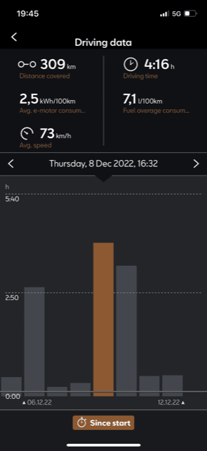

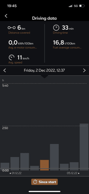

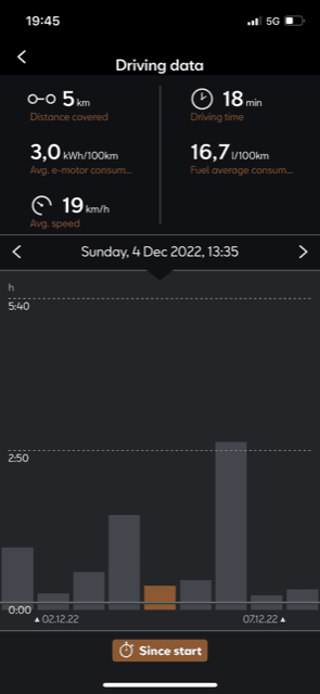

That's the strange part. it wasn't this bad in the past.
In this case temp was 9 Celsius so it's "warm". But I always keep climate control at 21 C, speed 1 so that hasn't changed.
The trip was one strip of highway.

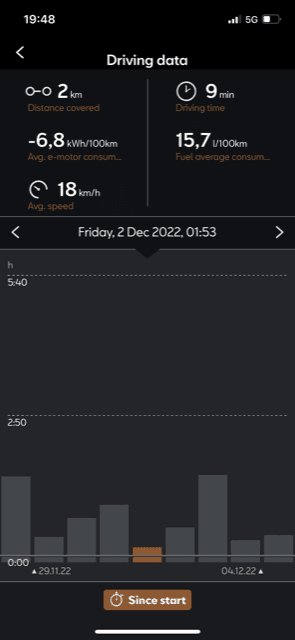

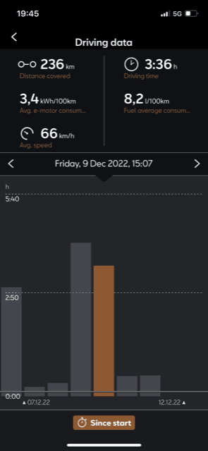

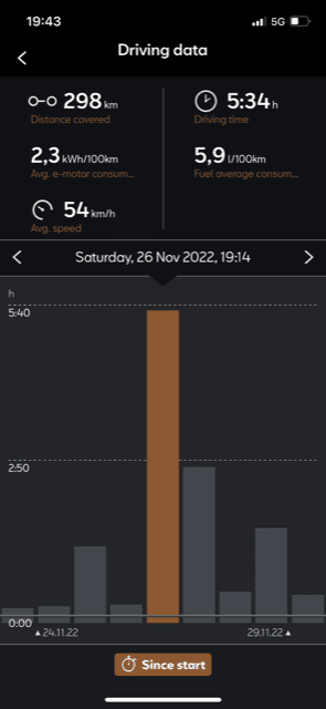

Attached more examples of consumption from the app.
Some of them are on short trips which have 15-16 consumption, around the city, no power in the battery and cold engine which kind of make sense. On the other hand, today I did a short trip, 9 Km with 8.8 l/100km.
Best one and the norm was on the 26th of November. Since then it's all downhill.

Ninjakebab
Apr 12, 2022
178
91
Damn, those numbers really aren't too good.
However, it could be the internal sensors that are a bit off. Have you calculated actual mileage on one of these trips by filling up the tank at start and stop? If not, I would recommend that as the next step on one of your 100+km trips.

That's the strange part. it wasn't this bad in the past. Temp was 9Celsius so it's a lot. I always keep climate control at 21 C speed 1 so that hasn't changed. The trip was one strip of highway. Attached more examples of consumption from the app. Some of them are on short trips which have 15-16 consumption, around the city, no power and cold engine which kind of make sense but today for example short trip but only 8.8
I did. They are accurate. After the last trip 220km I was missing 2 lines out of the 4, so around 20 liters out of 40. I'll monitor it more and go to the service after the holidays. I don't know what else to do.
Ninjakebab
Apr 12, 2022
178
91
I wouldn't trust the tank level sensor for something so important either. Try filling up the tank, do one of these drives and then refill the tank when done, the volume you fill in will be the actual consumption.
