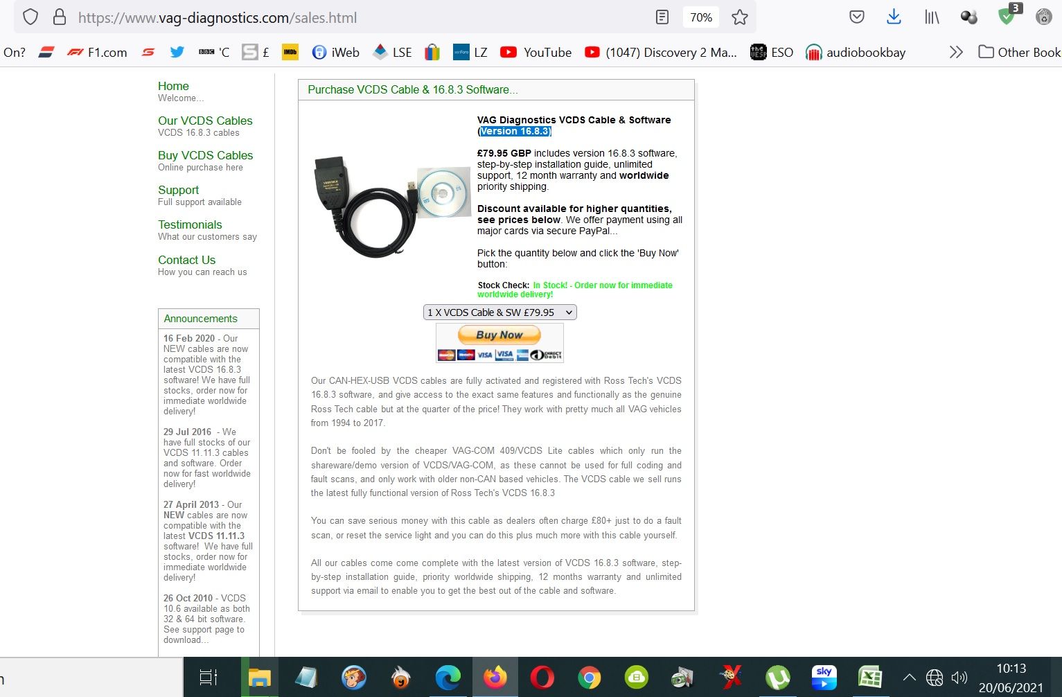

Sounds like a Seat equivalent to the Lynx dongle i use for my Land Rover. Is Calista any good?
I was going to buy VCDS from the people in the pic but they didn't reply to my question about whether it would work with my mate's Fabia too. Clearly desperate for sales...

I like to get the kit that covers all possibilities if possible. I didn't think £80 sounded too expensive for something that is suppose to match the dealer's equipment. Technically i don't need to buy anything as my cousin has his own garage and another mate has his own garage and does MOTs and both have multi manufacturer test equipment but sometimes i just can't be bothered to drive the ten miles to go and see them...
