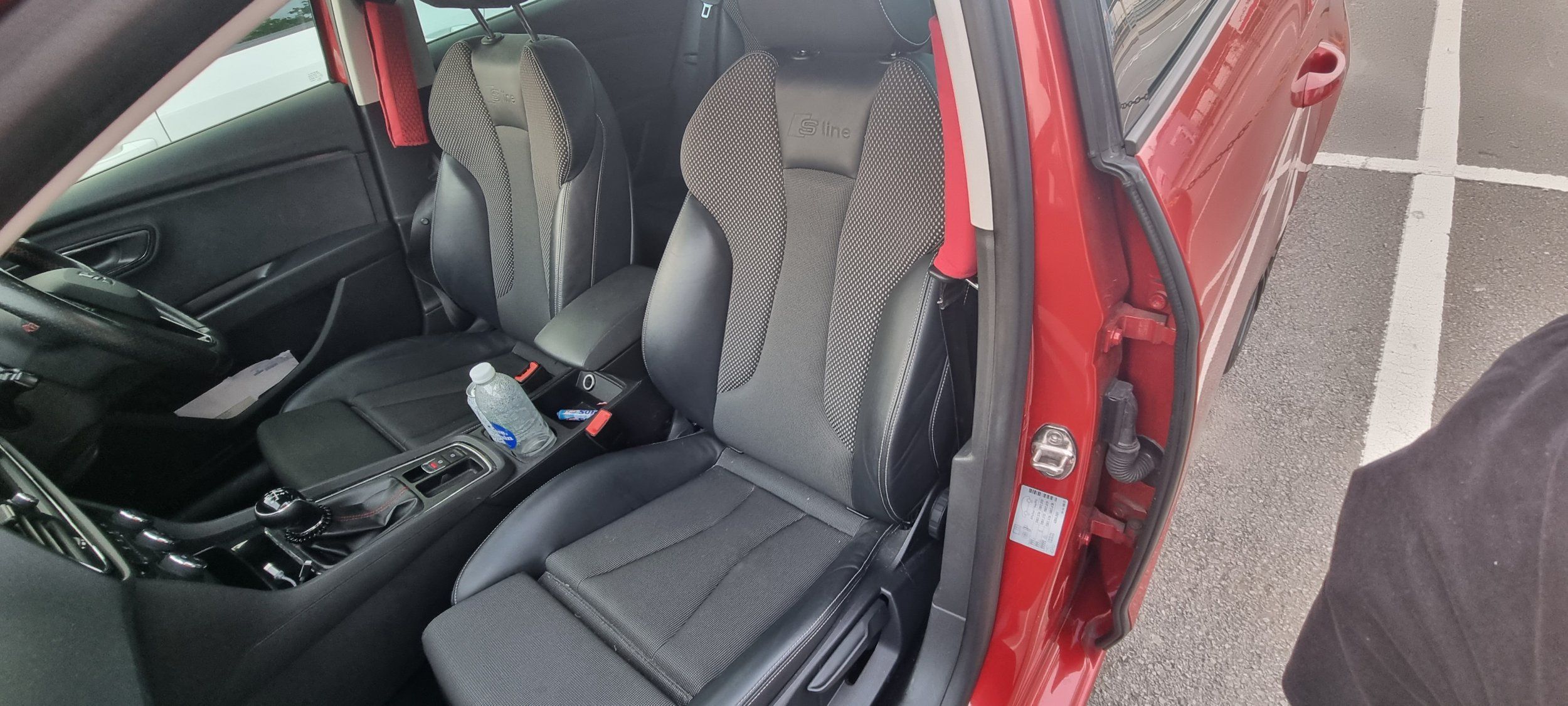

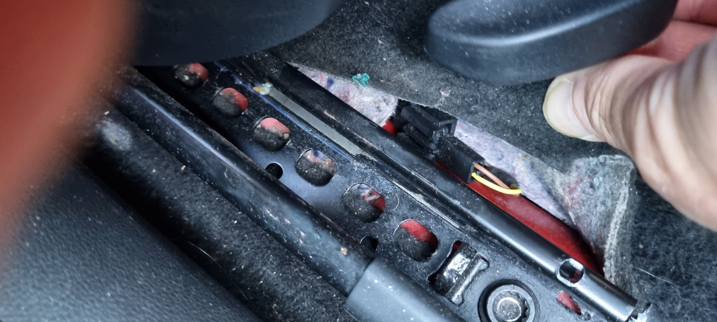

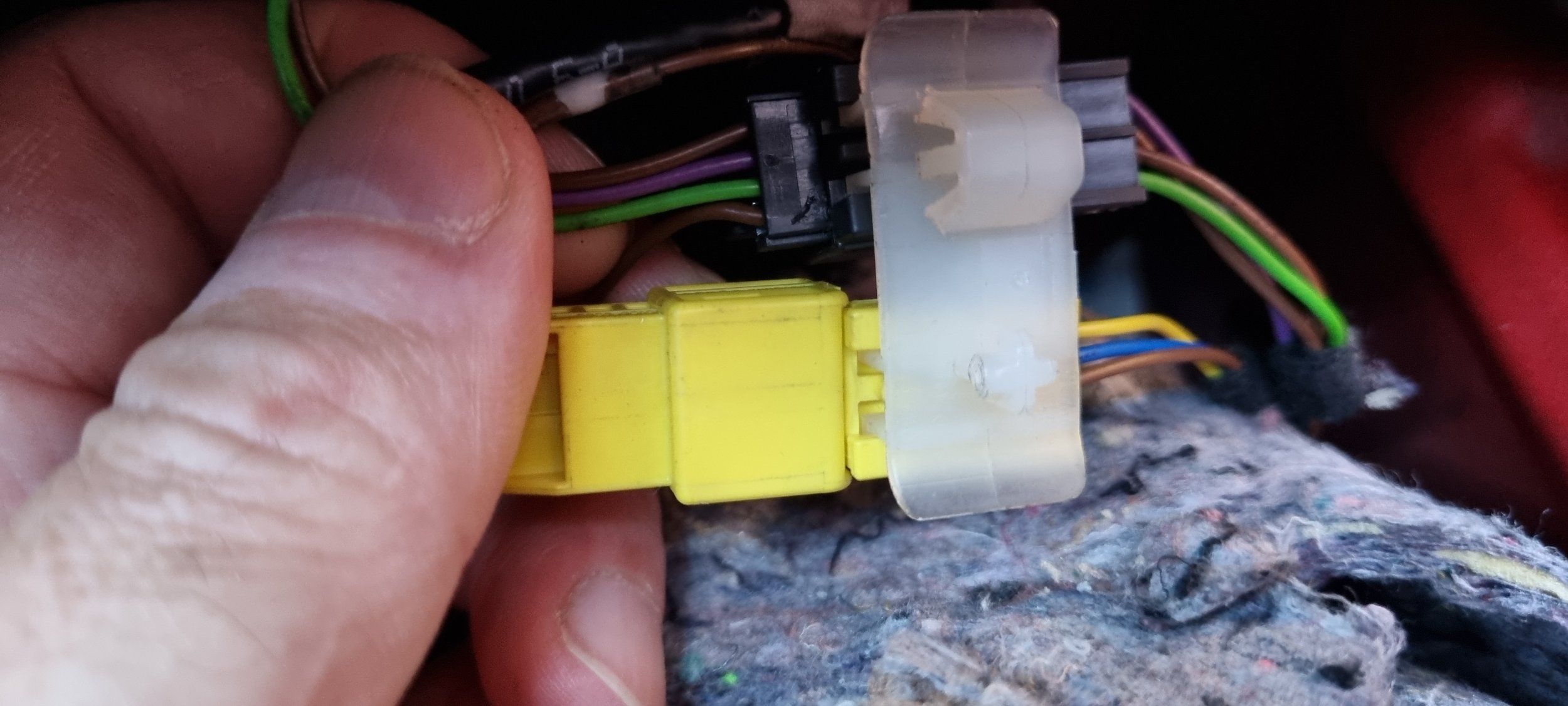

So have seen interest in fitting audi a3 sline seats to a mk3 leon. I got mine from an audi a3 8v. The 3rd pic is the drivers seat connections and 4th pic is the passenger seat wiring. The yellow connectors are just straight plug in.

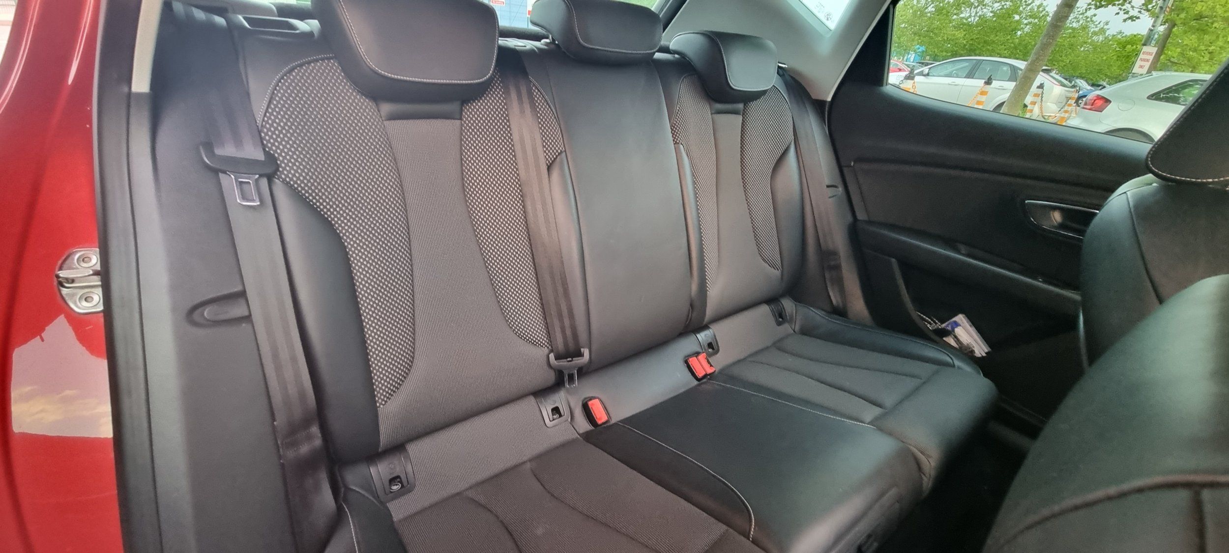

Rear seat removal done from
and then pull back part of seat slightly backwards and then to other side of car and they pop out.
