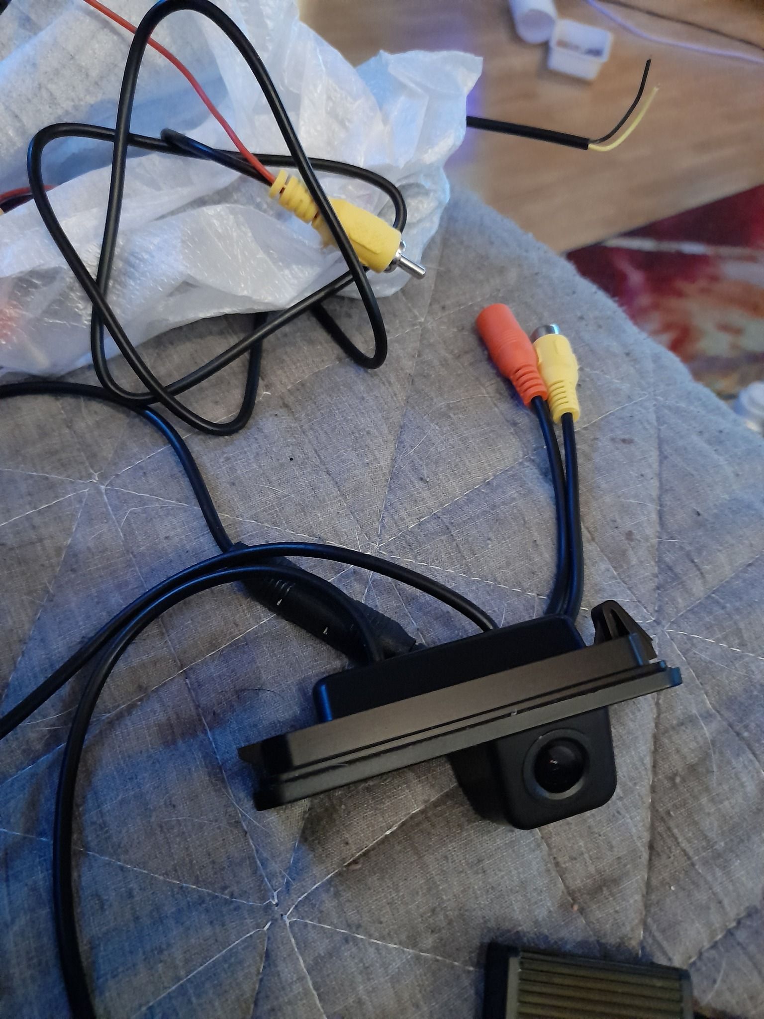

Which is the easiest way to get the cable from the camera through the bumper into the car, are there some rubber holes you can use

That looks like a camera that replaces the number plate light, if that's the case you can route it with the cables for the light.

I don't have any pictures but there's 2 grommets on either side where the wiring for rear lights are. It's impossible to miss once the bumper is off.

I had hoped to avoid removing the entire bumper, wondering if you remove the taillight and then pull down a wire that you can catch the camera cable and pull it up to the rubber grommets
