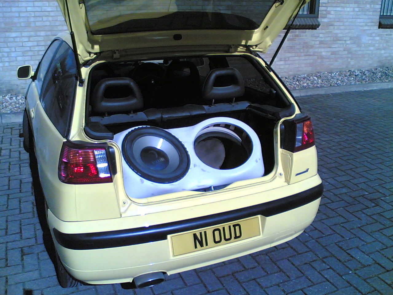

just a few pics hope fully get some more when it all finished and on its new 18s and slammed on its arse ,

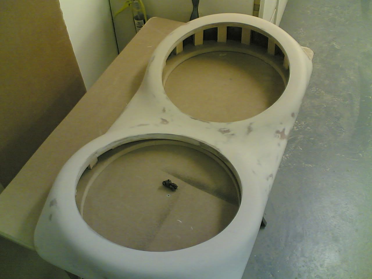

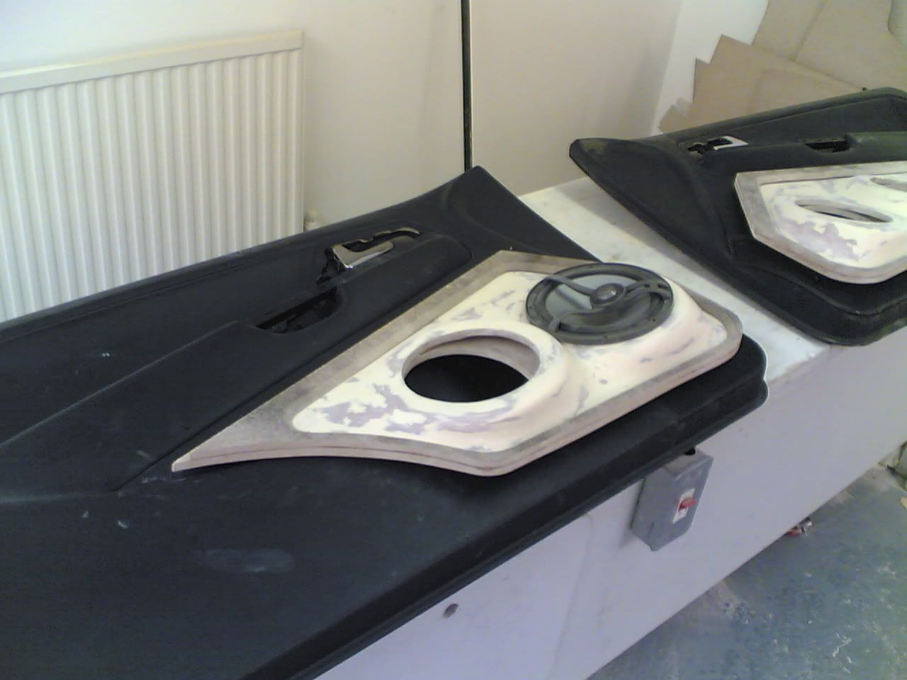

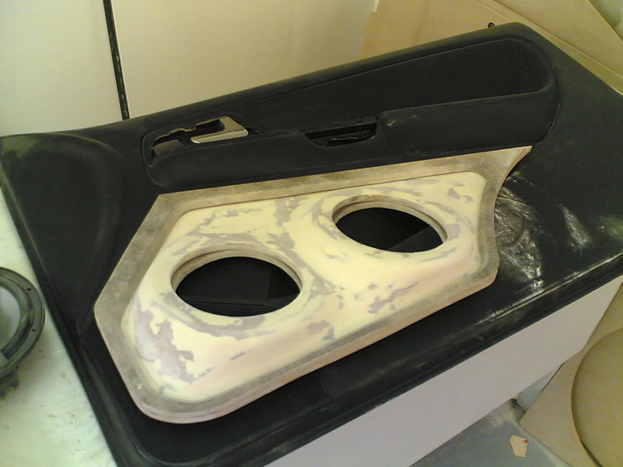

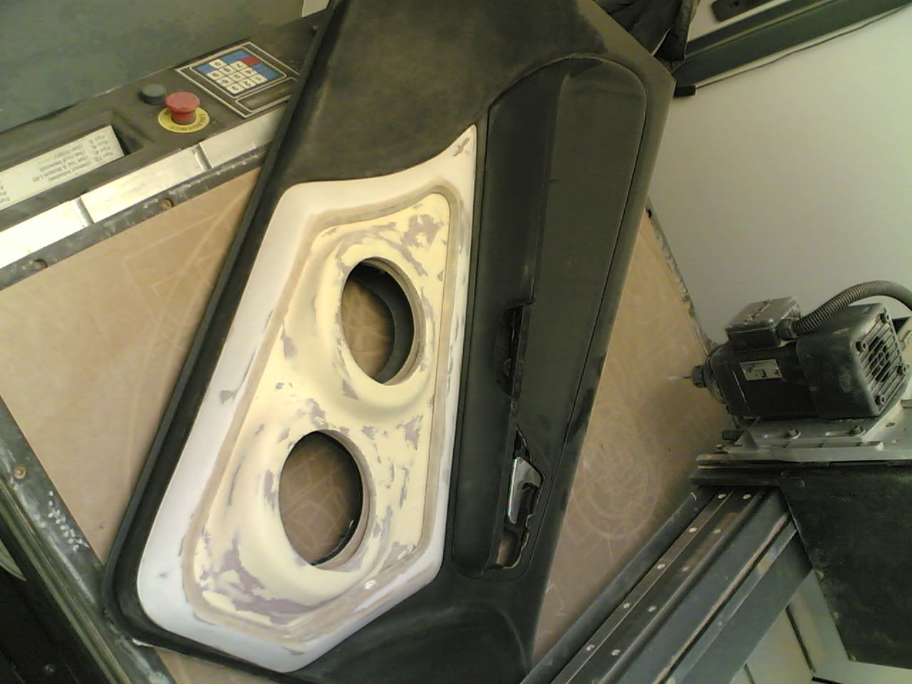

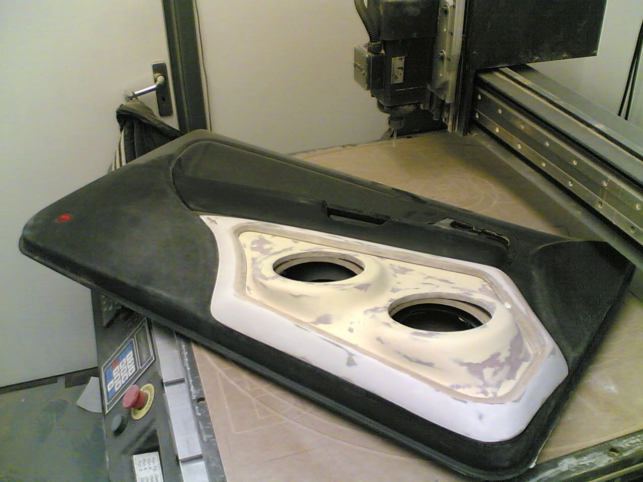

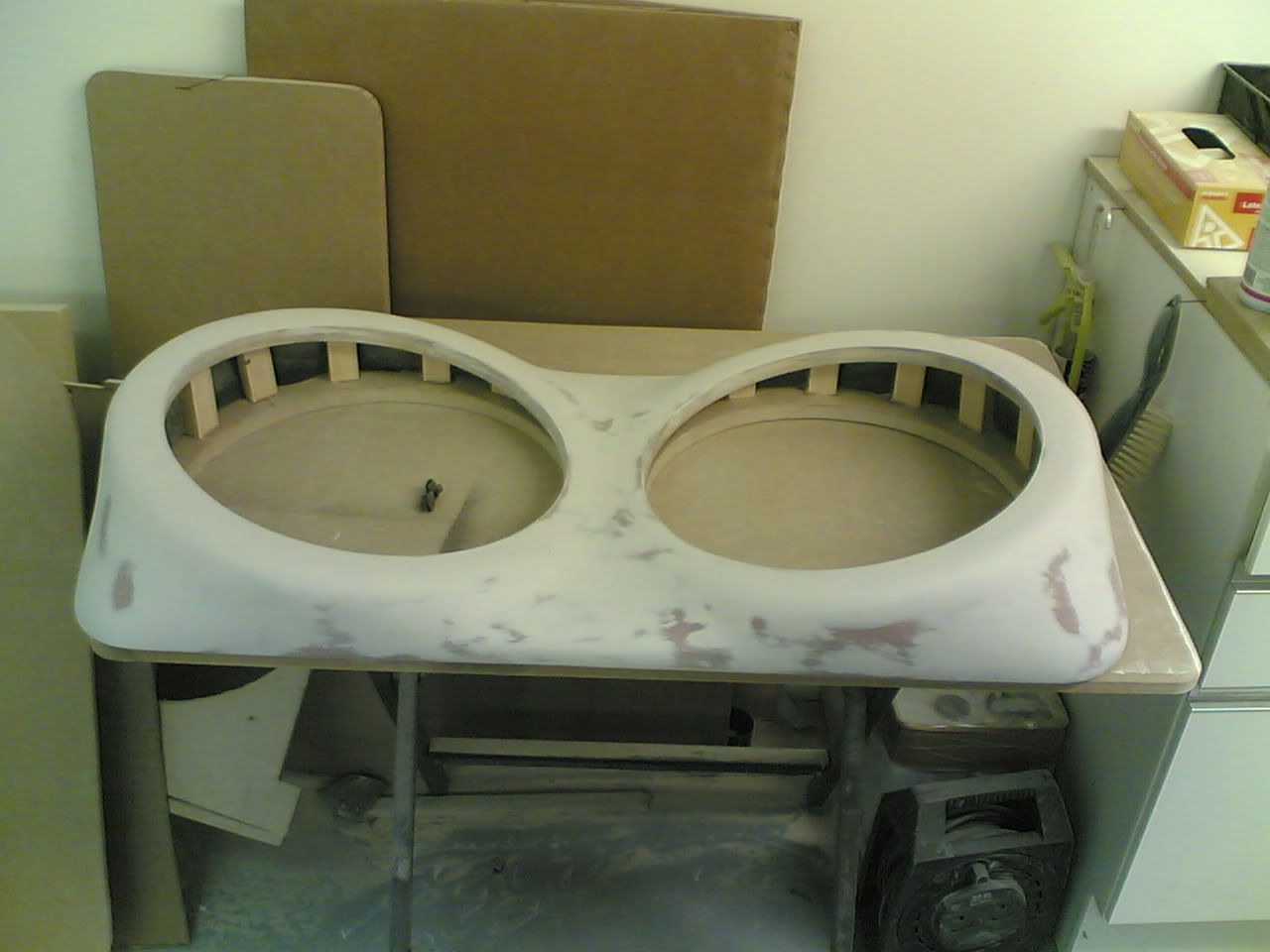

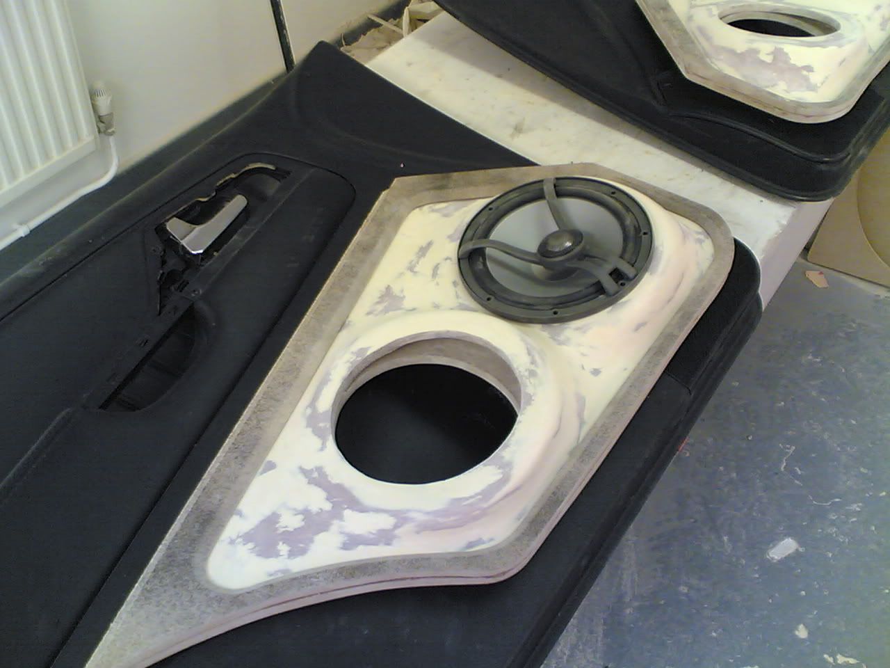

it'll be a MDF + fibreglass, P40 and P38 filler combo, create a frame using MDF as a base and then use the P40 to build up the final shape and then filler using P38 to smooth it all out and give a smooth as glass finish before trimming/spraying

thats the stuff , the sub box top and door builds are bein sprayed and lauqord in the same paint as the car . the head unit is located in the roof and the rest of the unit is just under the glove box ,
the system will be 2 diamond tdx 15 inch subs and 2 sets of 6inch compnents in the doors, the whole car is couvered in dynamat so no more flexin pannels , then 2 amps for the subs and 1 amp for the doors, not to worried bout the speed lol once the 18s go on it wont be goin any where because it is goin supper low
