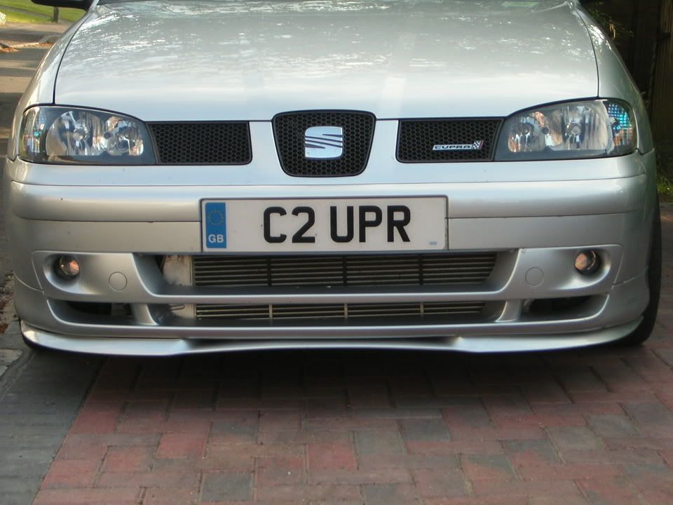

very nice :)
Do think they look good on a silver one, dont stand out as much :D

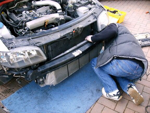

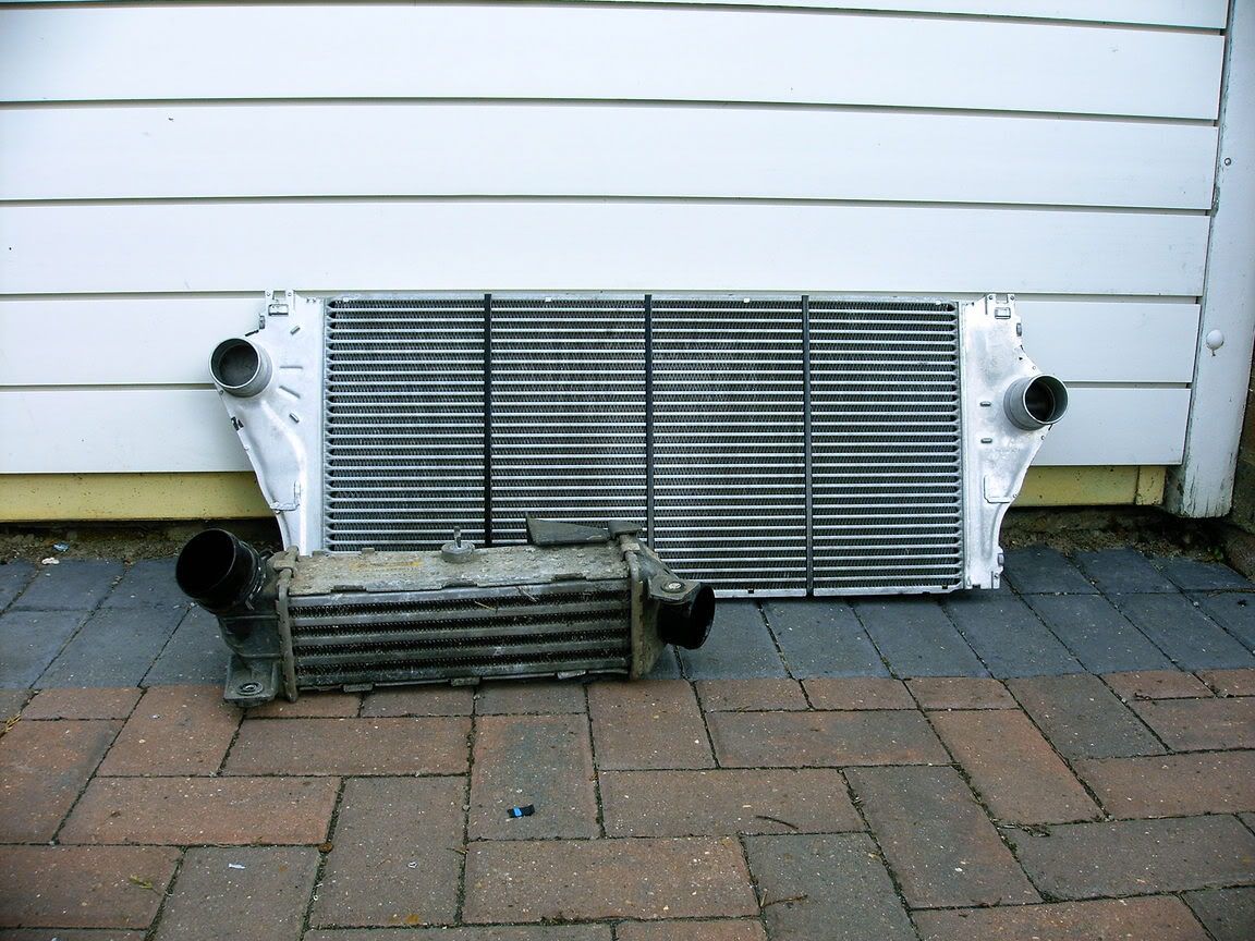

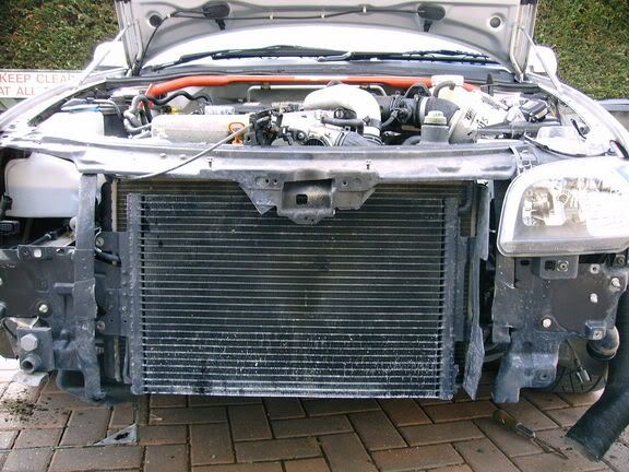

is that FMIC a straight swap then? what laguna age etc? :D might be a cheap er option for me
bezzaboy
Limp Mode Squad ™

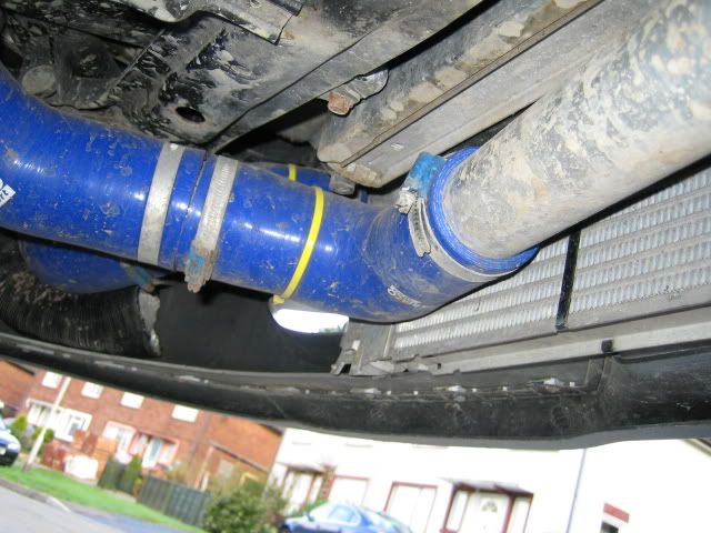

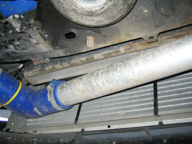

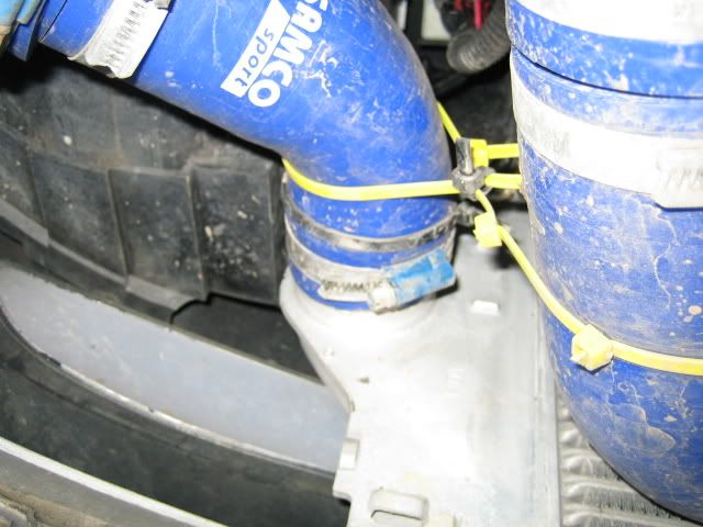

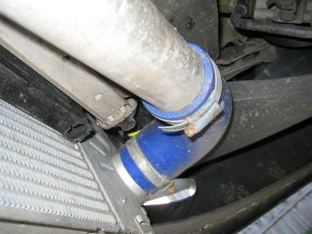

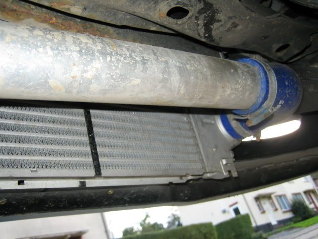

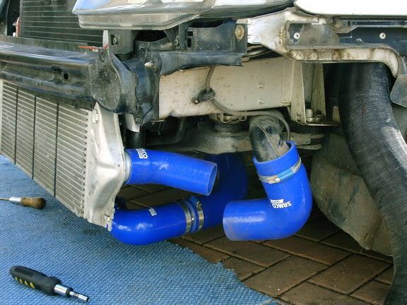

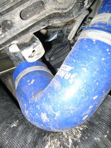

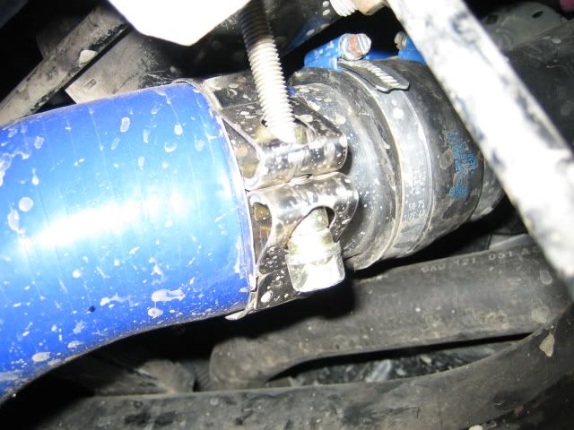

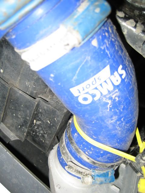

the ic is from a laguna 2.2 diesel it is basicially straight swap think there is a bit of trimming(i didn't fit the ic mate of mine did) also need a bit of ally pipe this run behind the ic (think this is 50 mm) and joins up to the pipe that goes to the turbo have got a list of all the pipe and bends that you need so will post and do some pics from underneath the car hope this helps.

Very nice use of the laguna IC..
Just 1 question isn't the 50mm pipework gonna be a bit restrictive??? surely these motors need something 70mm or above or am i just going over kill...
Looking at making my own FMIC kit and that cooler looks like its made for the job just not sure on the relatively small pipe dia.....

I have a Renault Laguna IC for sale if anyone is interested.
Basically I had a load of problems getting the pipework made up to fit it and eventually went down the Forge FMIC route.
Prepared to sell for £40 (I've polished it up too). I'm based in Bracknell (would prefer collection).

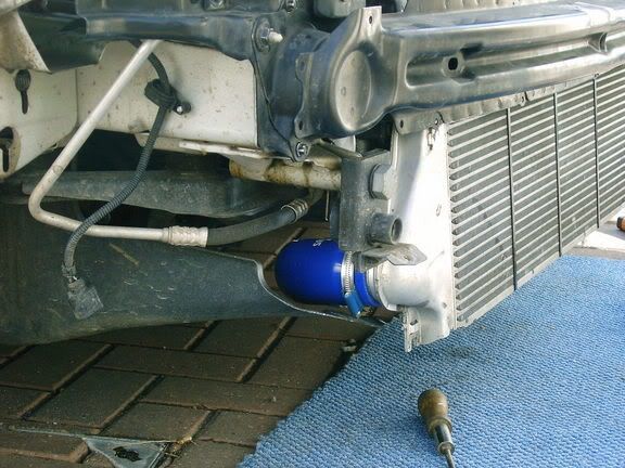

how has he bolted the intercooler to the car nick any help would be great + do you know wot the standard intercooler pipe work size is coz im going to try and match it with the reducers on the intercooler
