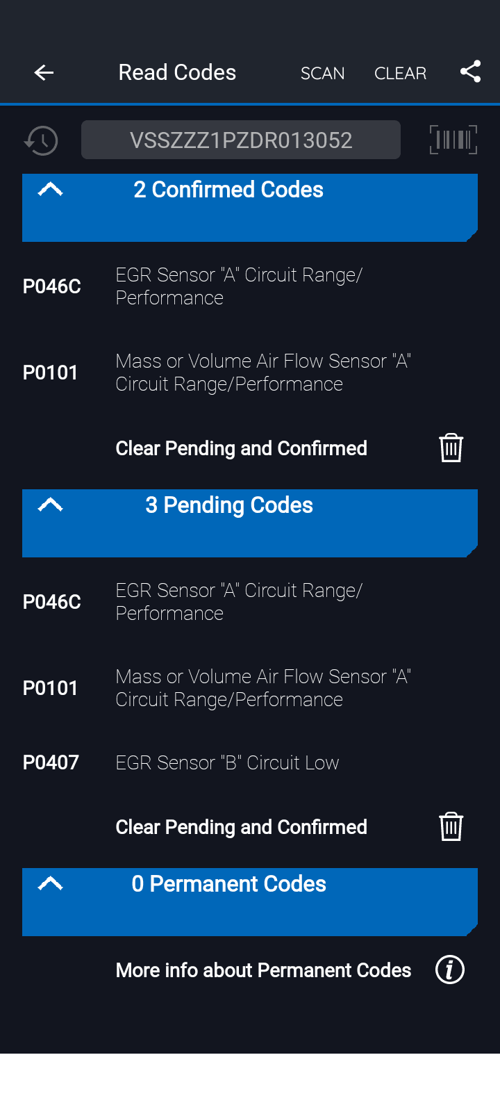

Hi all,
Mk2 Leon 1.6tdi CAYC engine
New to the forums looking for some help.
Car started going into limp mode earlier this week, put my Bluetooth scanner on it and brought up a P046, coil light will flash along with going into limp mode, been checking/clearing code daily, today the issue seems to be even worse, used to be able to key the car off and on whilst driving and would clear and be ok for a while however now comes back almost immediately , almost makes the car undrivable.
Did a solenoid test with an autel scan tool at college, all seemed ok, any other tests I could do before condemning the EGR??, have read previous threads about the EGR on this engine failing, if so will not be replacing with another, will be ordering a delete kit from dark side and getting mapped, local garage near my work offers EGR blank and remap, advice and thoughts appreciated
Thanks all
Attached is a screenshot from bluedriver, I am aware of the p101, as this is from my ramair filter, just hasnt been mapped in yet

Thanks, I understand about the MOT part as I work in a garage as an apprentice. As for the location of the EGR I'm not sure, I thought I read somewhere on another thread that it was located at the front of the engine right before the intake manifold, had a look with no obvious signs of failure, tried unplugging the connector and test drove however still brought up the same codes, from what I have read it is fairly common for these EGR to get bunged up or the electromagnet in the motor to fail internally, either way I think it's time for it to be gone.
Local garage offers blank and remap, so might look into them as I have spoken to a few people who have used them and only had positive things to say about them, shouldn't fail MOT providing remap is of good quality and smoke opacity test goes through , had an MOT in Feb and passed with a zero on the opacity test, given that not surprised as it is an eco model
