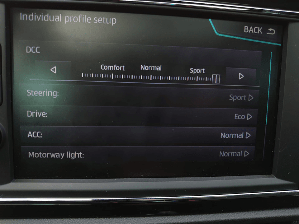

I researched the Driving Profiles extensively, and found ways to:
- make it remember the profile you were using when you shut down the car
- make it remember the S mode of your gearbox after restart
- make the car think it has other driving profiles than it actually has
- add controls that you couldn't modify normally
- show all controls that are changed by the driving profile. Most profiles from factory have hidden or grouped settings
- change whether or not the driving profile button LED is on/off/blinking
- give you full control over what's being shown in your driving profiles menu
Read about it here:
Some examples of what I'm using on my Leon:

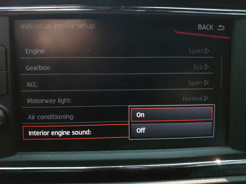

Added the soundaktor, and gave me full control. (Currently I'm using a more functional selection than just on/off, I can choose Sport/Normal/Comfort. Sport = always on. Normal = Only on when gearbox is in S, Comfort = always off).
On my previous car, I added many controls. Not all of them were functional because the car lacked the hardware.
A slider for DCC, with additional sporty/comfy settings:
So don't give up on SEAT or Cupra yet.. all this stuff can be tweaked extensively!

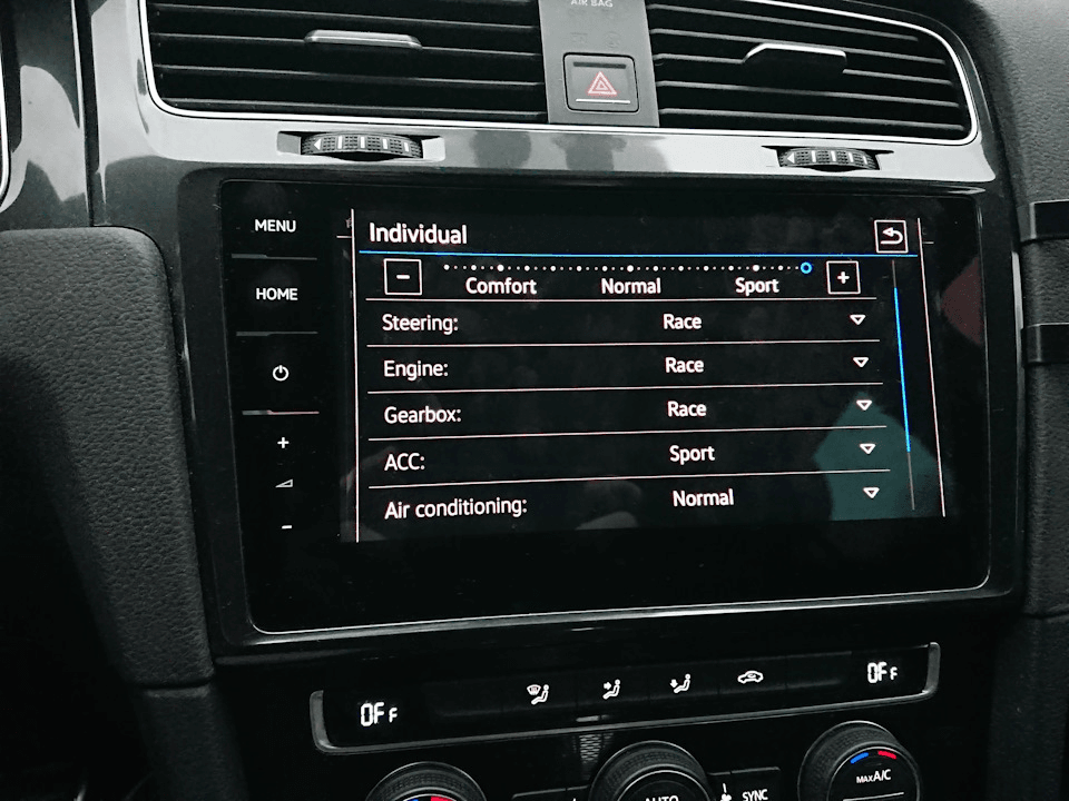

One of the most annoying things seems to have a hardware fix. It's for the Golf R but I'm sure the fix would work on the Leon
Sent from my moto g(7) power using Tapatalk

Also, it would be nice to able to turn off the interior engine sound.
I even don't know whether my 1.4/125ps engine has this feature or not.
But if it has, it would be nice to hear the difference.
As for the DCC, I have three settings: Comfort, Normal, Sport.
If its current comfort and sport settings are already pre-set at the limits of each end, I wouldn't bother to have more control on it.
But if I would be able to go further i.e. more comfy or more sporty, then I may consider to have this hack too.

Yes, I enable controls in the menus that weren't avaiable before. But not only in the individual options. I add stuff to each profile.
No, they don't interfere. In the individual options you can select between the settings from the other profiles. So if you choose sport for Engine sound, you will get the same setting as is set in the Sport mode.
@Chillout
Wow, having more options in Individual is already great, but having more options in ALL modes is fantastic!

Currently I'm doing the same with the Soundaktor firmware. Maybe we can have some different sounds there ;-)
CupraRST
Feb 25, 2020
117
52
NL
It's so much fun :)
@Chillout
New sounds to choose from, that sounds nice!
That brings me to the question if different models Seat Leon or Cupra (MK3. MK3.5 without GPF, MK3,5 with GPF, MK4, hatchback or Sportstourer) produce different sounds in their soundaktor. From what I know from my own Cupra R ST (MK3,5 with GPFs), this sounds different (more natural) from what I hear in several Youtube videos from the MK4 Cupra Sportstourer 2.0 (that sounds more boxer like). Does anyone know about differences between different models through the range and years?
I see I never replied to this question.. having the slider means you can go stiffer than sport, more comfy than comfort.
