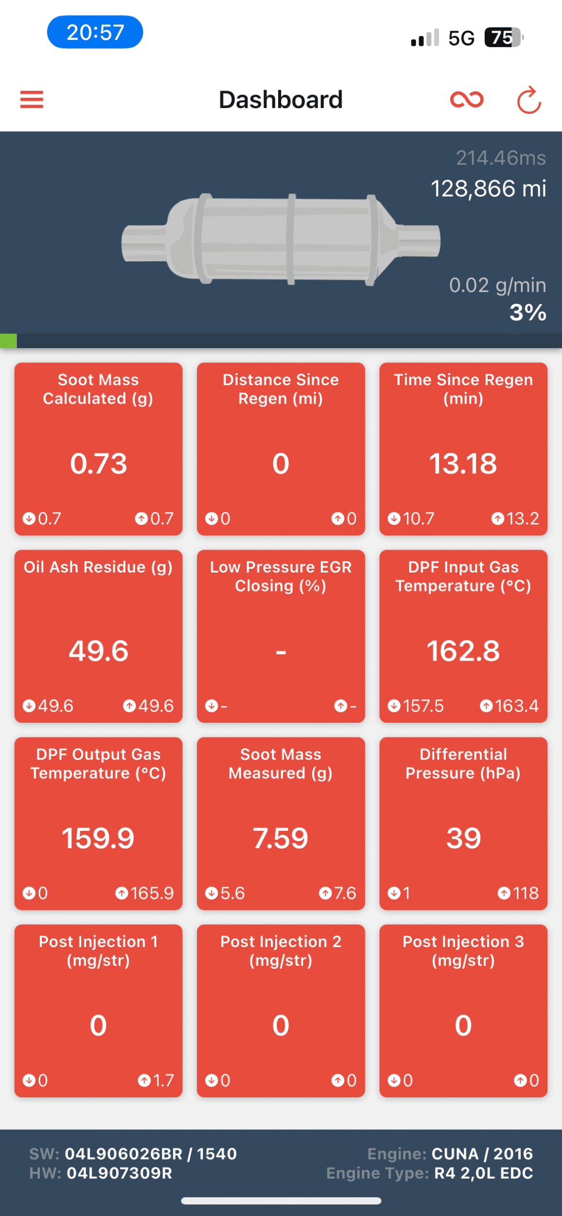

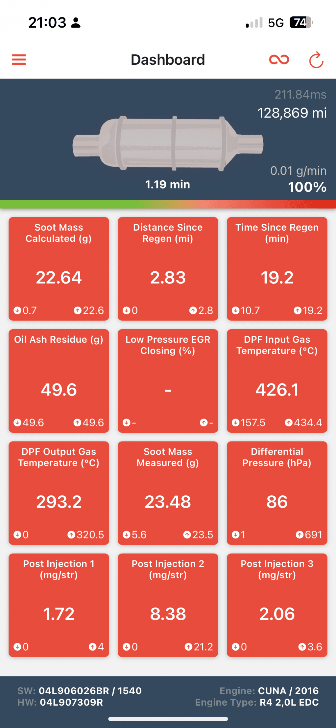

Yeah I have high oil consumption, although it only seems to be on the motorway. I did a road trip of 1500 miles a couple months back and had to top up with 5L of oil during the trip. I’ve done 1000 miles since then and not had to top up at all, I don’t use the motorway much.
Just did another run to try clear the dpf, this time a little more aggressive keeping my rpm above 2500. It wouldn’t budge past 4% after an hour so I let it idle finish, turned engine on and off and after 5 minutes of driving it jumped from 4% 0.73g to 100% 22.64g, there wasn’t a gradual increase just a jump after a few mins of driving.

I might just have to take it to a garage to find out what’s going on, I hope it’s just a sensor but I thought the car would throw some kind of fault code if there was a problem with a sensor?

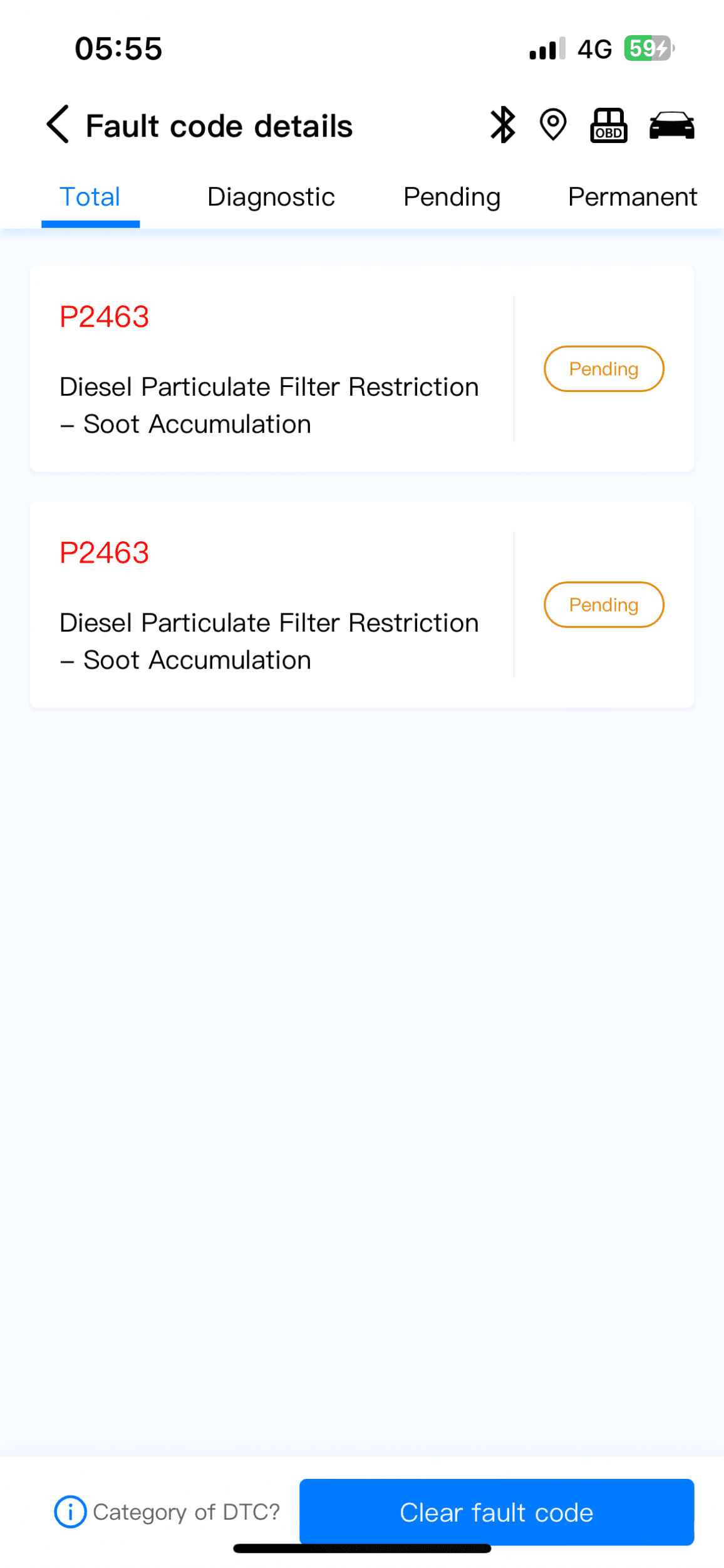

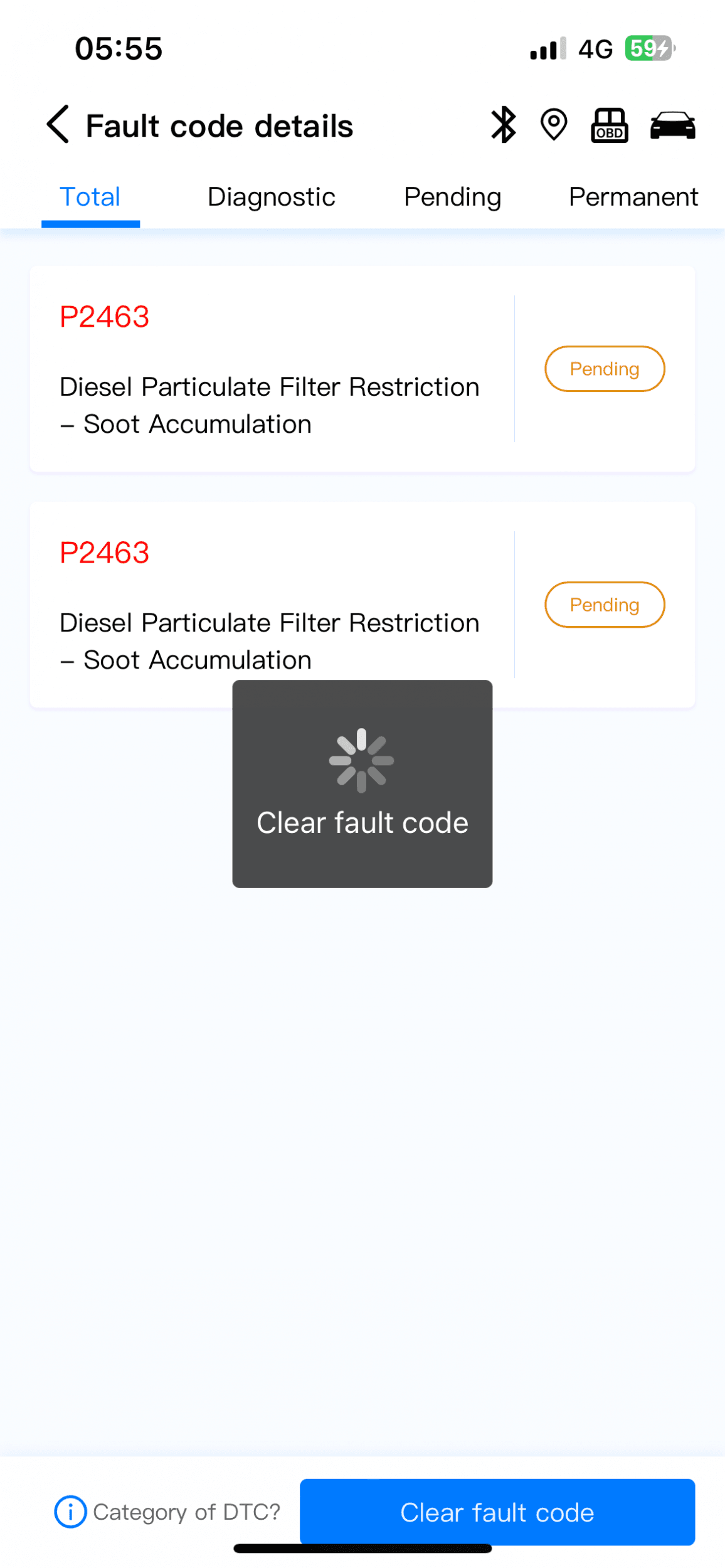

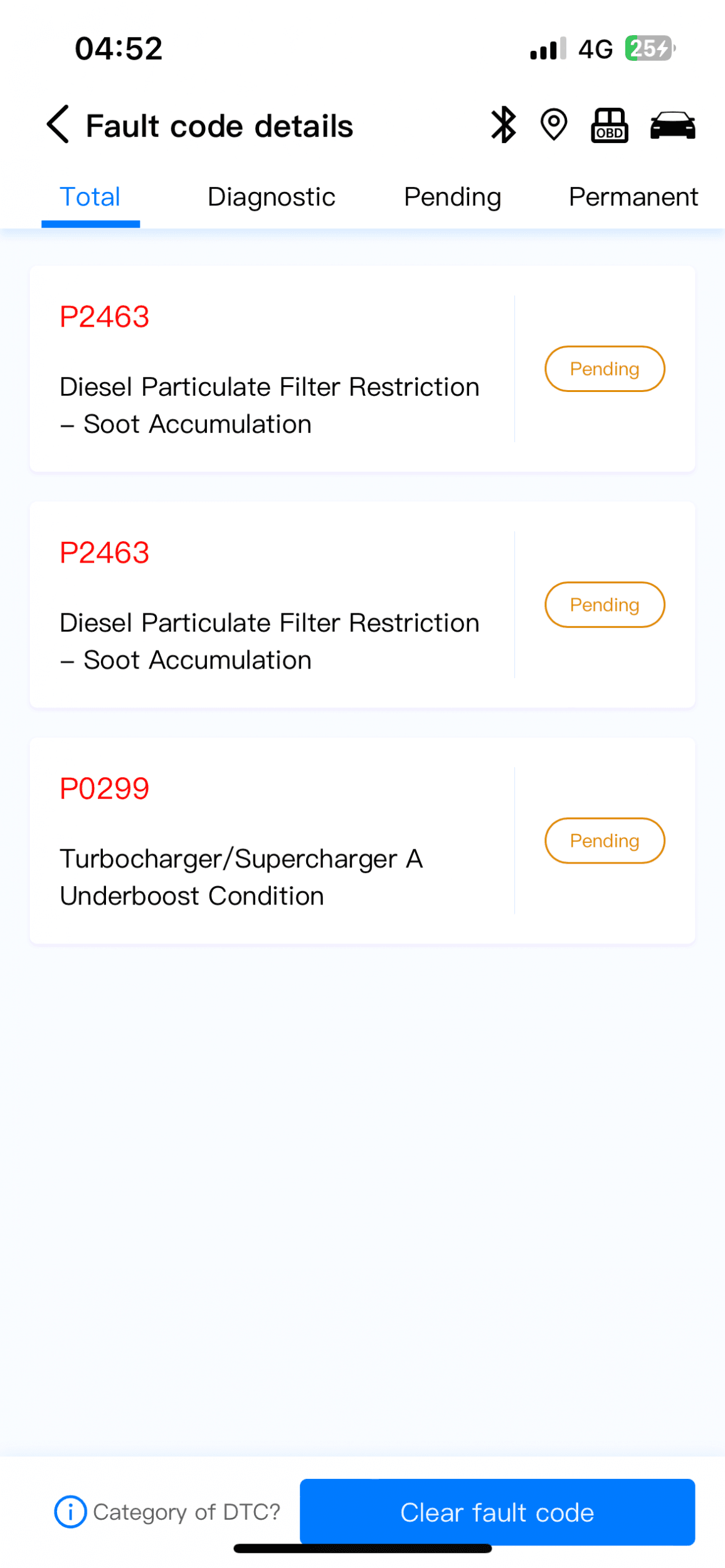

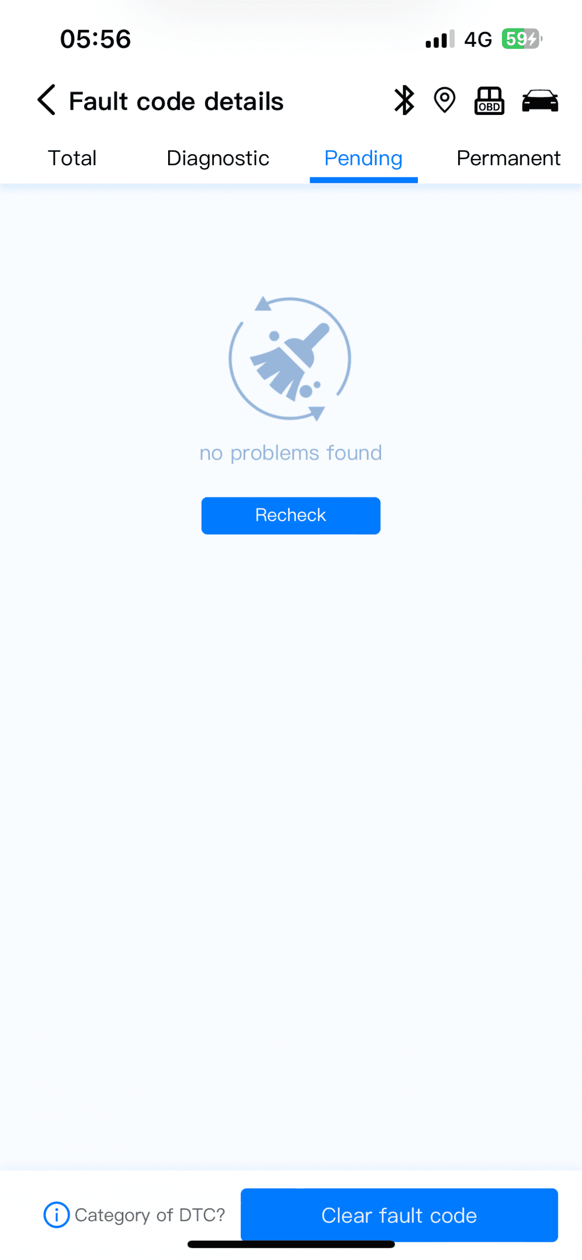

Hi guys been reading up on DPF issues I have a Engine ML on and a glow plug light flashing I have tried clearing the fault with my OBD but it’s not a very good one and even tried with a OBD11 VAG one but the light does not clear and the DPF regen light is not coming on at all anymore I mainly do short journeys but whenever the DPF light came on previously I would go for a blast on the motorway and it would regen and clear up but now it doesn’t !! How do I do a forced regen as the car is in limp mode I am adding pics of my dash display and the OBD fault codes. It’s says it’s cleared up but when I restart the engine it just comes back on and the car is in limp mode won’t go over 2400/2500 RPM !!!

So how can I force a regen myself without taking to a garage and how do I get it out of limp mode ?? Any help
Or guidance would be much appreciated guys il attach a few more pics from my OBD oh n also it is consuming a lot of oil since the MIL light has been on. I check it regular and it’s always dry so I top up two
Litres and it’s not long had a service and a new timing belt and water pump!! so don’t know what’s going on. Can’t afford to spend loads more money on it ! It’s a 2015 1.6tdi with 109k miles on it.
